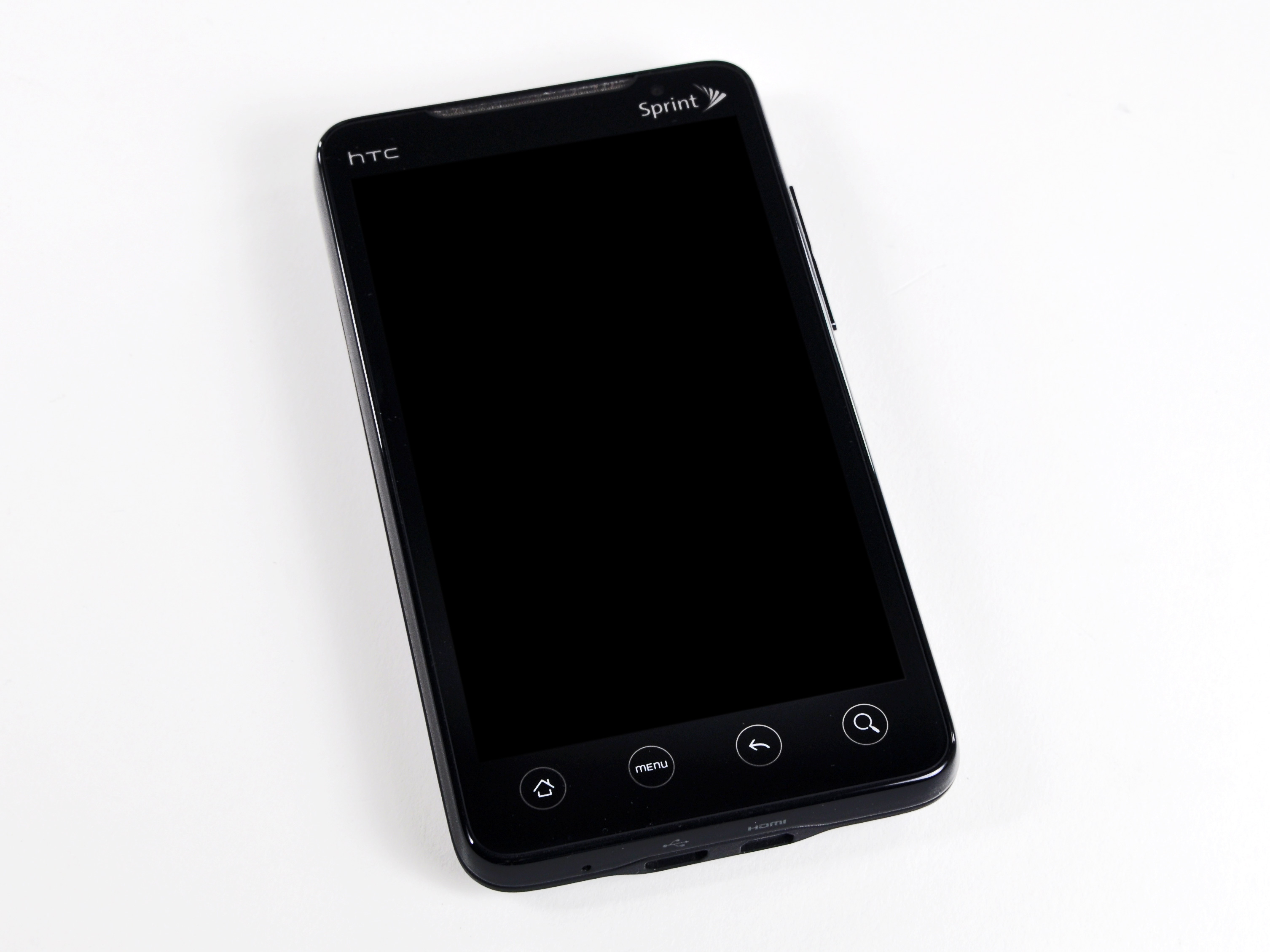

    • Today is a glorious day in the history of teardowns. We welcome the HTC Evo 4G to grandest stage of them all.
    • The Evo 4G's technical highlights include:
    • 1 GHz Qualcomm Snapdragon processor
    • 4.3 inch LCD Display
    • 512 MB RAM
    • Dual cameras (1.3 MP front and 8MP back)
    • HDMI output (requires adapter)
    • Android 2.1

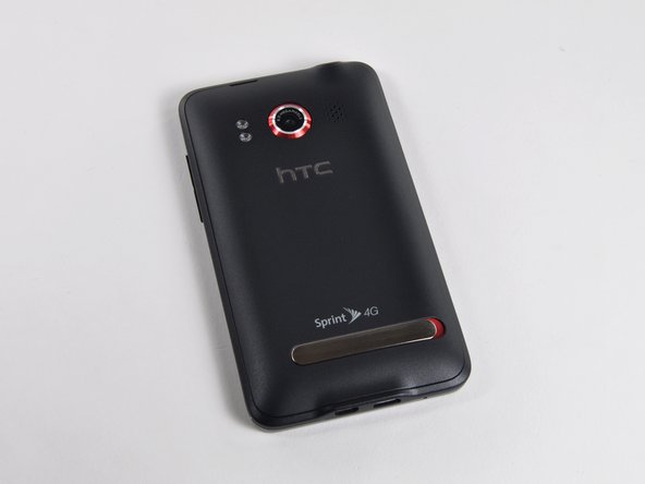

    • The top of the Evo's smooth-contoured rear case is dominated by an 8 Megapixel camera and its two LED flashes.
    • A flip-out stand on its bottom edge allows the Evo to sit horizontally for watching videos on the 4.3" behemoth of a display.

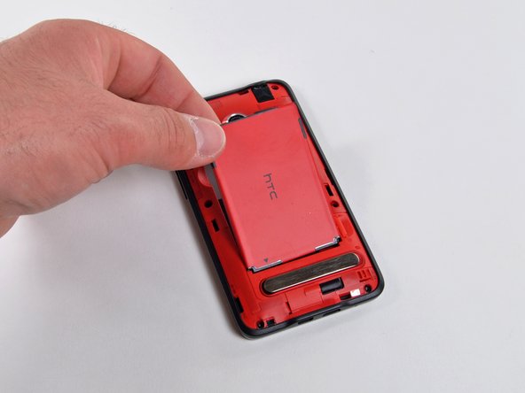

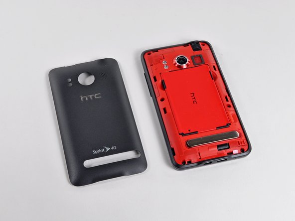

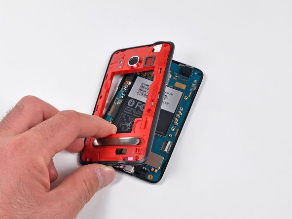

    • After a bit of careful prying, the rear case easily pops off the Evo.
    • Holy red innards! Maybe it's because the Republic of China's flag is 3/4 red?
  4. HTC Evo 4G Teardown: step 4, image 1 of 3 HTC Evo 4G Teardown: step 4, image 2 of 3 HTC Evo 4G Teardown: step 4, image 3 of 3

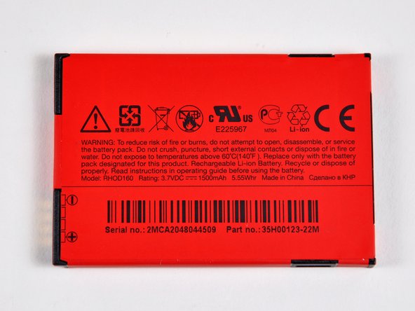

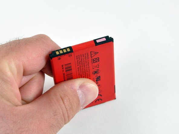

    • Like most reasonable phones, changing the Evo's battery is a snap.
    • The 3.7 V, 1500 mAh rechargeable Li-ion battery weighs in at 31 grams.
    • That's 23% more capacity than an iPhone 3GS, 15% more than a Droid Incredible, and 7% more than a Nexus One.
    • Look out! There's a liquid damage indicator on the battery's top edge.

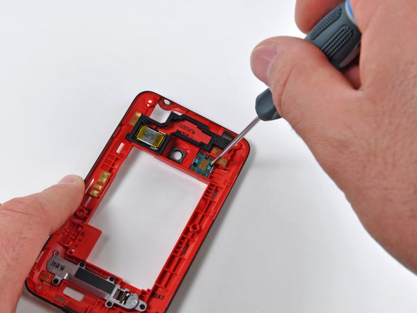

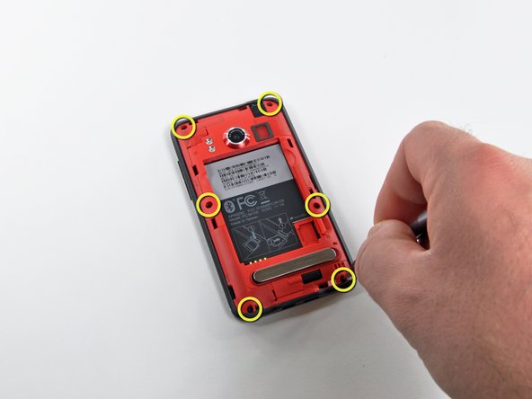

    • We delve deeper into the Evo 4G by removing six T5 Torx screws and carefully prying off the internal frame with an iPod opening tool.
  6. HTC Evo 4G Teardown: step 6, image 1 of 2 HTC Evo 4G Teardown: step 6, image 2 of 2
    • The internal frame is easily removed from the rest of the Evo.
    • It houses the stand, antennas, LED flashes, and speaker.
  7. HTC Evo 4G Teardown: step 7, image 1 of 2 HTC Evo 4G Teardown: step 7, image 2 of 2

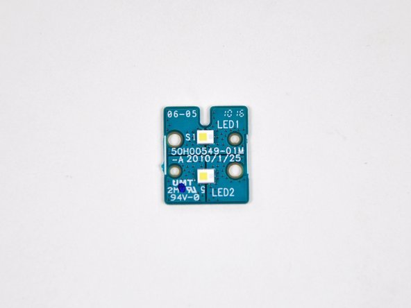

    • Two small Phillips screws secure the LED flash to the internal frame.
    • The dual LED flash assembly consists of no more than two LEDs soldered to a small interconnect board.

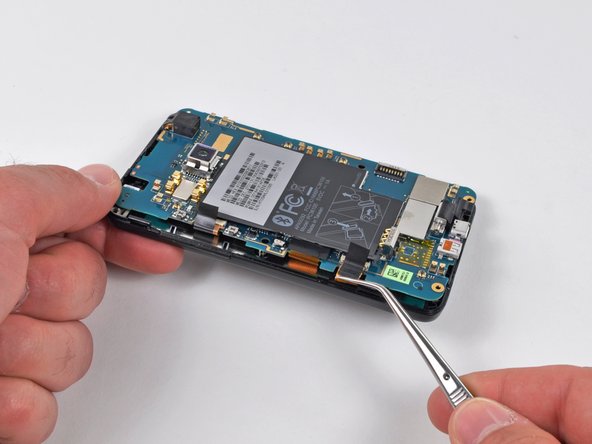

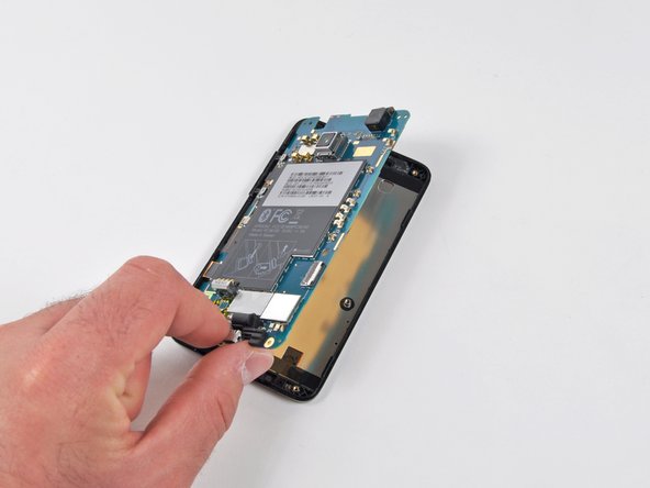

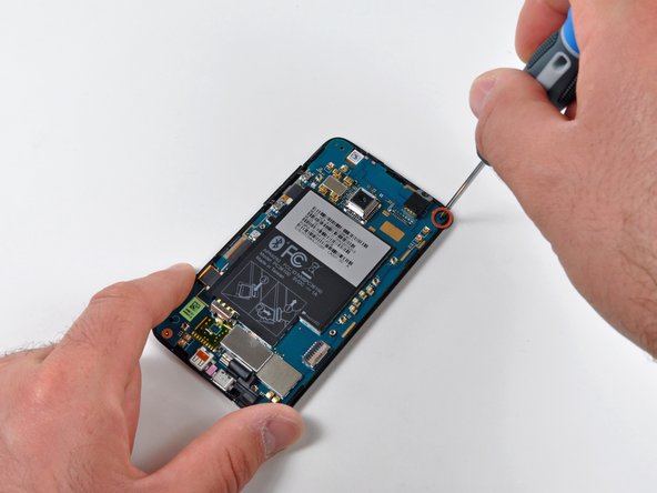

    • A small Phillips screw near the top left corner of the Evo is all that keeps the left side of the logic board snug in its cradle.
  9. HTC Evo 4G Teardown: step 9, image 1 of 2 HTC Evo 4G Teardown: step 9, image 2 of 2

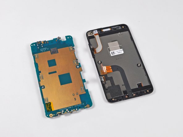

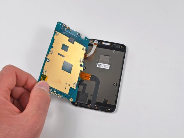

    • After disconnecting ribbon cables for the display, digitizer, and front camera, the logic board can be removed from the front half of the Evo.

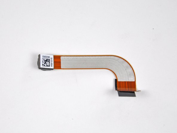

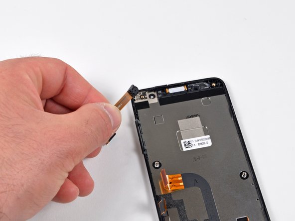

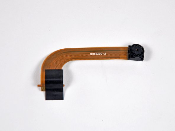

    • The forward facing 1.3 Megapixel camera lifts right out of its enclosure in the top portion of the Evo 4G.

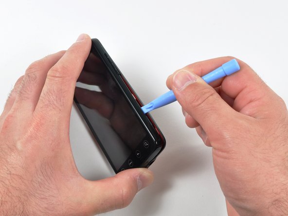

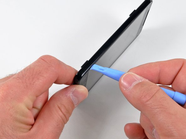

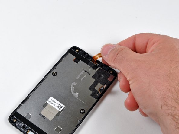

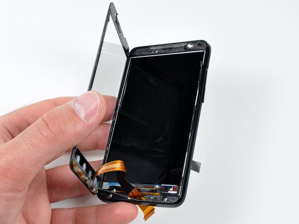

    • We used an iPod opening tool to separate the glass from the LCD and frame.
    • Removing the glass is not terribly difficult with the Evo 4G. This is great news for those unfortunate enough to drop their shiny phone and crack the glass.

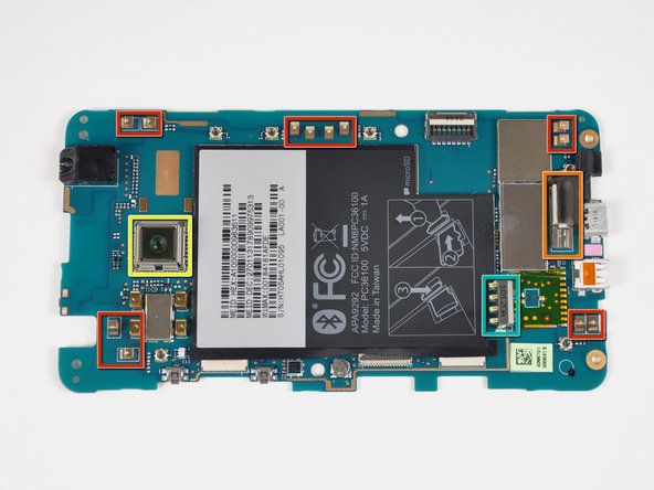

    • Standing out on the board:
    • Several rows of pressure contacts connecting the antennas to the logic board.
    • The vibrator motor for...well...vibrating.
    • 8 Megapixel camera sensor.
    • Battery connector.

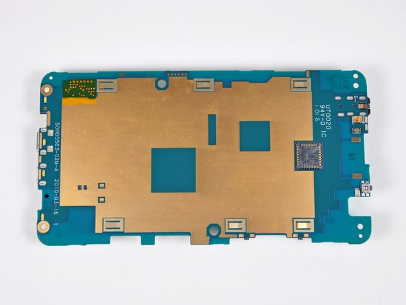

    • The other side of the board is about as featureless as it can be.

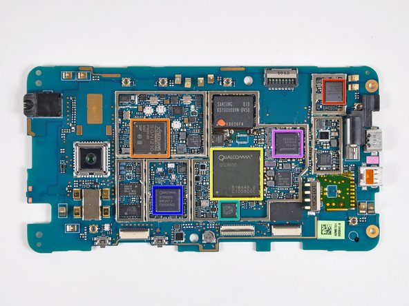

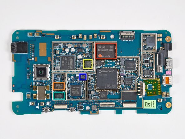

    • Big players on the board include:
    • A Broadcom BCM4329 integrating Wi-Fi, Bluetooth, and FM connectivity to provide speeds up to 50 Mbits/s in 802.11n.
    • Sequans SQ1210 RF combo chip.
    • Qualcomm's QSD8650 Snapdragon processor.
    • Atmel's MXT224 Touchscreen controller.
    • Qualcomm's RTR6500 CDMA2000 transceiver with GPS.
    • Qualcomm's PM7540 power management IC.
  14. HTC Evo 4G Teardown: step 14, image 1 of 1
    • More fun packages:
    • Samsung KBY00U00VM NAND Flash.
    • Avago's FEM7758 front end module.
    • Texas Instruments TPS65051 6-channel Power Mgmt IC.
    • Triquint TQM613029 CDMA PA-Duplexer Module.
    • Bosch Sensortec BMA150 Digital, triaxial acceleration sensor

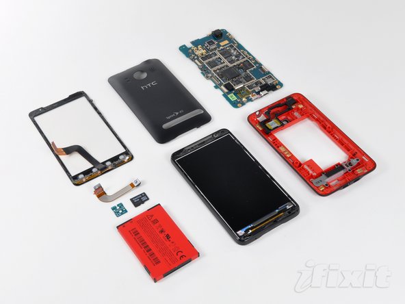

    • The fallen remains of what was once an HTC Evo 4G.
    • As always, thank you for choosing iFixit as your number one source for gadget teardowns.
