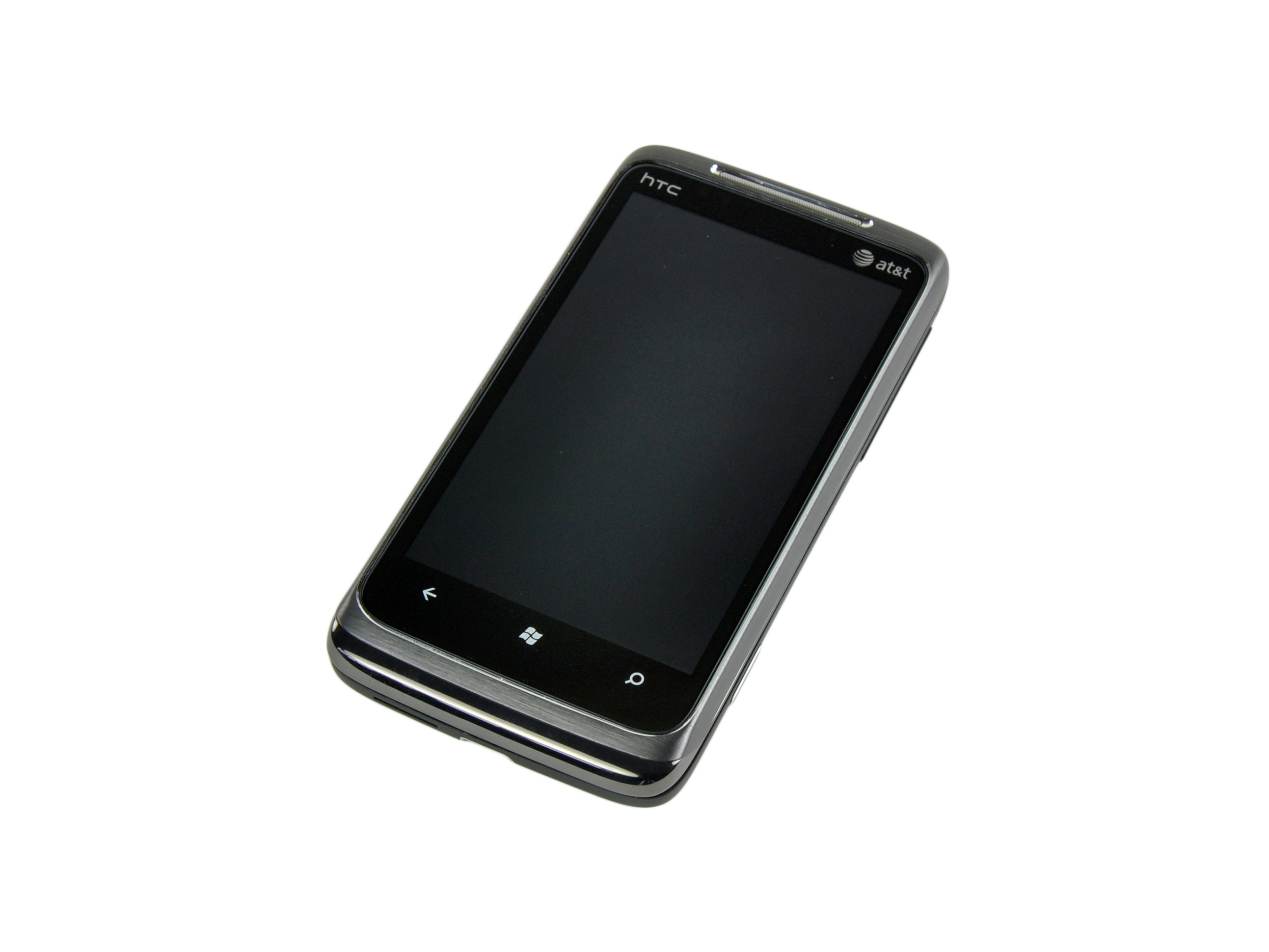

    • The HTC Surround takes the idea of a mobile media center to a whole new level.
    • The Surround is also among the first smartphones to use the Windows Phone 7 Operating System.
    • Technical Specifications:
    • 1 GHz Qualcomm QSD8250 Snapdragon processor
    • 448 MB RAM
    • 16 GB internal storage
    • 3.8 inch widescreen WVGA display
    • 5.0 MP camera

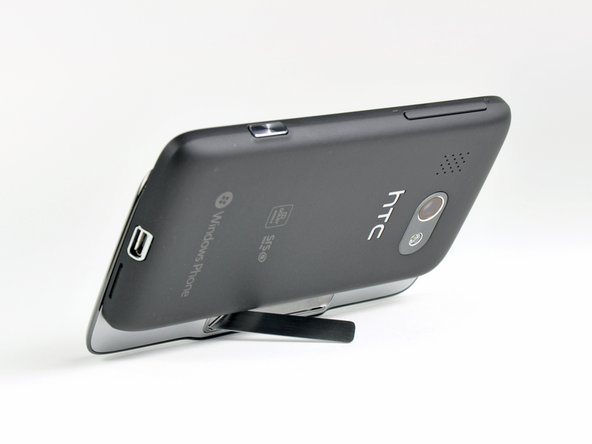

  2. HTC Surround Teardown: step 2, image 1 of 2 HTC Surround Teardown: step 2, image 2 of 2
    • To fully accommodate the phone home theater aspect of the Surround, the entire bottom half of the the phone slides out to reveal an impressive speaker array.
    • The phone also sports a kickstand (a la Evo), presumably so you can set the phone down upright when you want to night-club on the go. Or to watch videos. Whatever.
