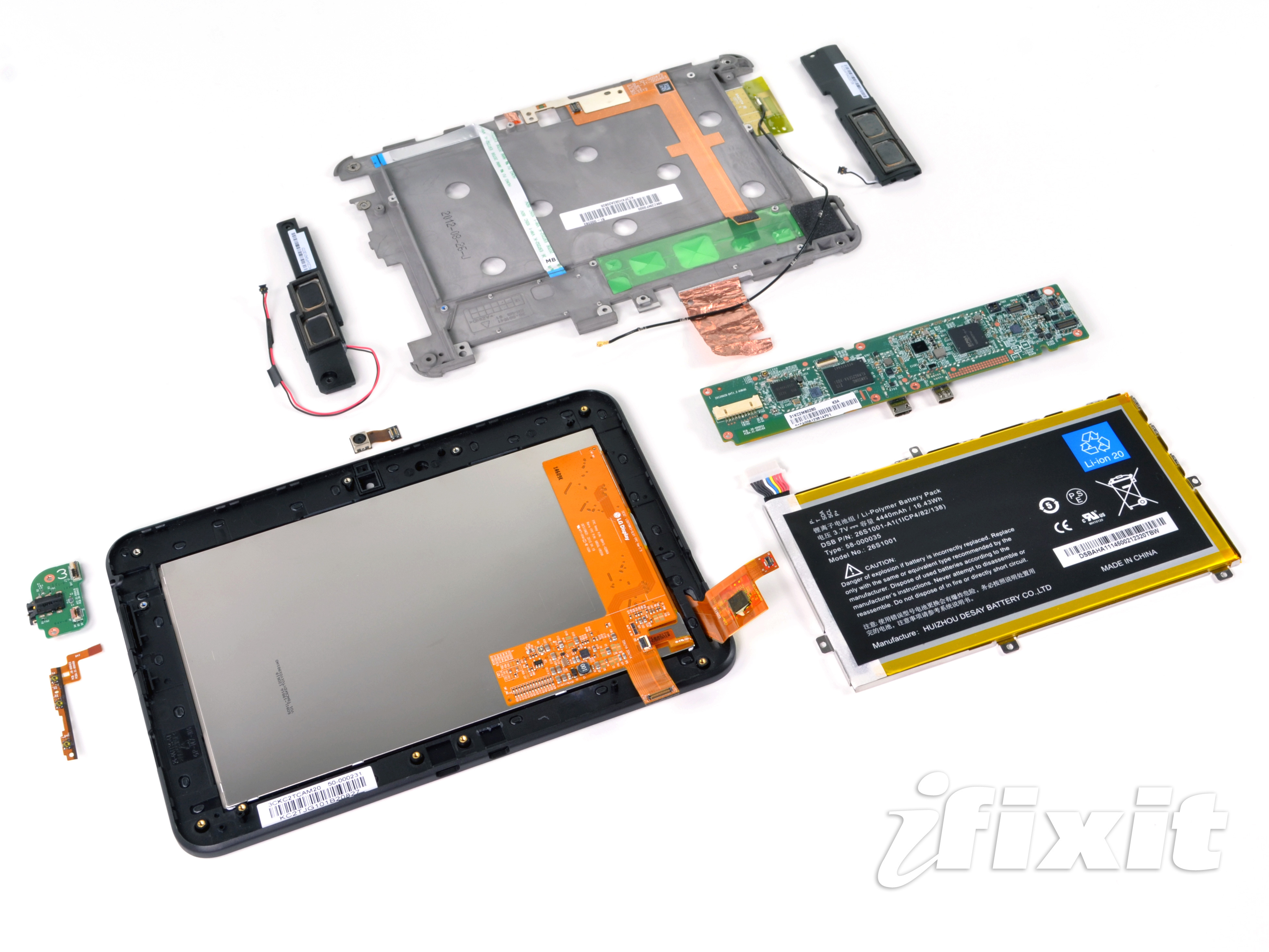

    • Enough fun and games, let's get this Kindle open.
    • A plastic opening tool quickly removes the back case to reveal our first glimpse at the internals.
    • Not long ago, we praised the Nexus 7 for being so easy to get into compared to the iPad, and sacrificing only a single millimeter to do so.
    • Fast forward a couple months later, and Amazon has an easy-to-open tablet that's another 0.1 mm thinner than the Nexus 7. We've said it once, and we'll say it again: you don't need to sacrifice thinness to make a repairable device.

    • But, let's resume focus on the device du jour: the just-released HD variant of the Kindle Fire.
    • The battery is secured by four Phillips #00 screws and one lonely T5 Torx screw.
    • While this single T5 Torx isn't going to keep out our prying fingers, it might be enough to sour the battery removal attempts of someone who is less well-equipped. Lesson learned, kids: don't bring your Phillips to a Torx fight.
    • Well this is a first. The battery is enclosed within a metal casing. We believe this is for structural reinforcement, as well as for shielding the battery from any possible electrical damage.
    • The Kindle Fire HD gets its spark from a 3.7 V, 4400 mAh, 16.43 Wh Li-ion battery that—as in most mobile devices—dominates most of the inner real estate.
    • Amazon says this Kindle will operate for 11 hours without having to plug it in. That is a whole four extra episodes of Family Guy than the Nexus 7 will give you.

    • Once the battery and the motherboard have been removed, the inner framework can easily be lifted up off the LCD assembly.
    • Good news everyone! The second Wi-Fi antenna is held in place by mild adhesive, so it comes out fairly easily.
    • In addition to housing the Wi-Fi antenna, the inner framework is home to the ambient light sensor/microphone/front-facing camera ribbon cable and headphone jack ribbon cable. Check them out:

    • The display is manufactured by LG Electronics, and is labeled as LD070WX3-SL01.
    • Bad news everyone! The LCD and front glass panel are fused together. This means you have to replace the entire assembly as one unit rather than two separate entities.
    • It seems as if this particular display was designed on April 19, 2012.
    • Finally, we found the Atmel maXTouch™ mXT768E mutual capacitance touchscreen controller hiding underneath a piece of tape.
  16. Kindle Fire HD Teardown: step 16, image 1 of 2 Kindle Fire HD Teardown: step 16, image 2 of 2
    • Kindle Fire HD Repairability: 7 out of 10 (10 is easiest to repair)
    • The rear case is very easy to open, granting trouble-free access to the internals.
    • The battery is held in with absolutely no adhesive.
    • Simplistic design and limited functionality means fewer components and less headache for disassembly.
    • Mostly all screws found inside are Phillips #00 screws—except for one T5 Torx screw.
    • Copper tape over the processor is somewhat difficult to remove and to readhere correctly.
    • The LCD is fused to the front glass and plastic frame, meaning you'll have to replace both components together.
