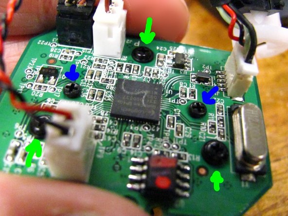

  3. Logitech 2-MP Webcam C600 Teardown: step 3, image 1 of 3 Logitech 2-MP Webcam C600 Teardown: step 3, image 2 of 3 Logitech 2-MP Webcam C600 Teardown: step 3, image 3 of 3
    • Remove the screw indicated by the green arrows

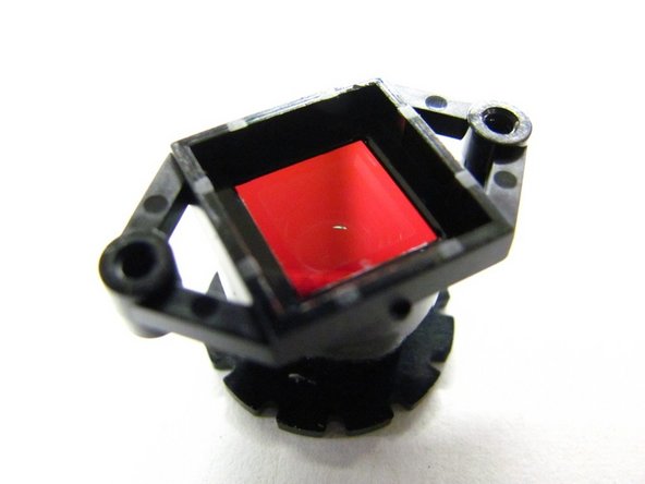

  4. Logitech 2-MP Webcam C600 Teardown: step 4, image 1 of 3 Logitech 2-MP Webcam C600 Teardown: step 4, image 2 of 3 Logitech 2-MP Webcam C600 Teardown: step 4, image 3 of 3
    • The screws indicated by the blue arrows hold the lens module in place
    • The infrared filter is accessible from the back of the lens module. It is the shiny piece of reddish glass.

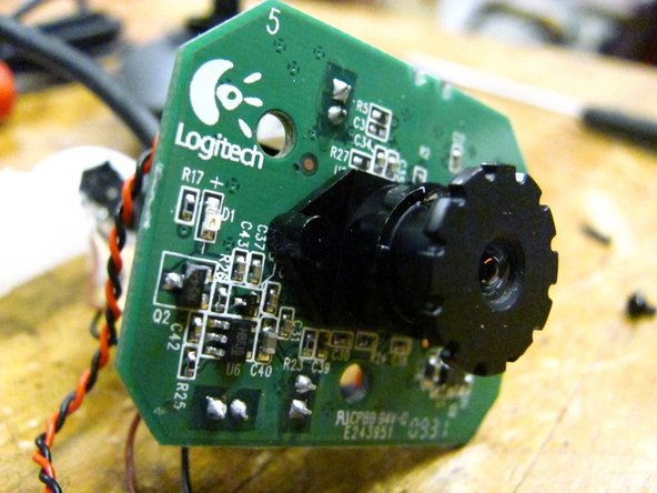

  5. Logitech 2-MP Webcam C600 Teardown: step 5, image 1 of 2 Logitech 2-MP Webcam C600 Teardown: step 5, image 2 of 2
    • Attached to the white plastic is the privacy shade position sensor.
    • The ccd sensor appears to be 1/3.2" Type sensor with 4:3 aspect ratio. With is 4.536mm x 3.416mm. Focal length is currently undetermined.
    • The lens is threaded M10x0.5, and testing seems to indicate that the sensor is a CCD with global shutter.
