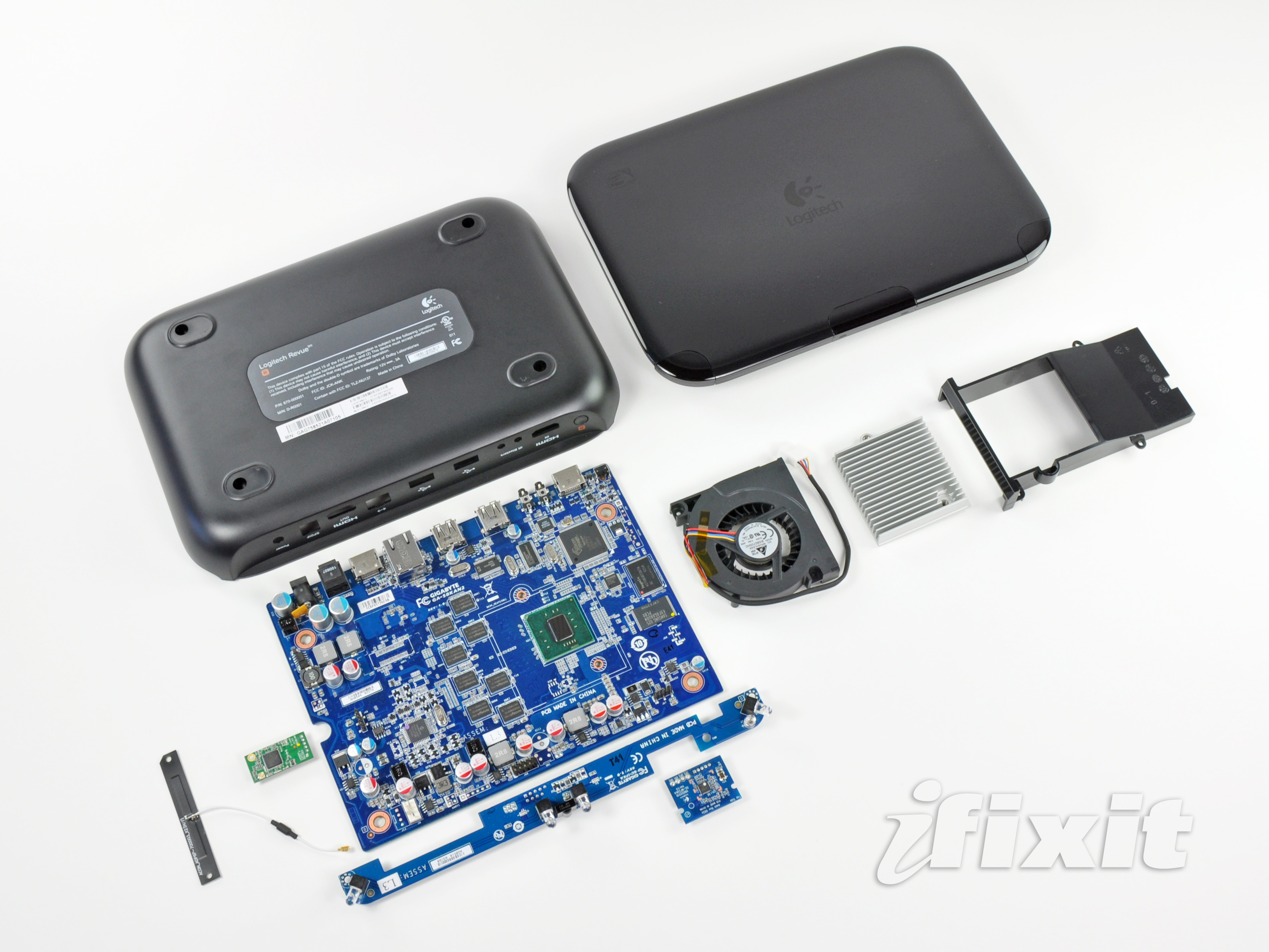

    • The cover comes off just like that, revealing a beautiful blue motherboard within.
    • There's a fan approximately twice the size of the new MacBook Air's fan on the top cover of the Google TV Logitech Revue.
    • The internal fan is attached to a nifty duct that directs the air flow across the CPU heat sink (located in the area shaded in red when the device is assembled) toward the vents on the side of the top cover.
    • Compare this to the fanless Apple TV that relies on conduction and natural convection to dissipate its internally generated heat.
  6. Logitech Revue Teardown: step 6, image 1 of 1
    • It's a very simple layout inside -- just one large motherboard, brought to you by Gigabyte.
    • There's tons of unused space inside. The extra room should keep the Revue pretty cool and prevent any serious overheating from taking place.

    • We take off the heatsink to reveal the Atom processor. The heatsink is held in place by two Phillips screws -- no need to reinvent the wheel here...
    • The Intel Atom CE4150 1.2 GHz processor.
    • So how does the Atom CE4150 stack up against the A4 processor?
    • The Intel CE4150 is clocked at 1.2 GHz, whereas the Apple A4 processor is capped at 1.0 GHz.
    • The architecture of the Apple A4 revolves around its package-on-package (PoP) design, encompassing both processor and RAM into one design. The Atom CE4150 design relies on external RAM chips.

    • Contents of the Gigabyte GA-SBKAN2:
    • Intel Atom CE4150 1.2 GHz processor, with a 400 MHz GPU
    • Samsung K9F8G08U0M 1 GB NAND Flash
    • Hynix H27UBG8T2ATR 4 GB NAND Flash
    • Silicon Image Sil9135 HDMI 1.3 Receiver
    • Nanya NT5CB128M8CN-CG 1 GB DDR3 SDRAM (1 Gb X 8)
    • Realtek Semiconductor RTL8201N 10/100M PHYceiver
    • Microchip PIC24FJ64GA004-I/PT 16-bit microcontroller

    • Logitech Revue Repairability: 8 out of 10 (10 is easiest to repair).
    • Opening the case is super-simple -- only 4 screws and a bunch of clips stand in your way.
    • Only standard Phillips screws are used.
    • Daughterboard connectors easily disconnect from the motherboard sockets.
    • The fan is very easy to replace, should it ever fail.
    • If you have to replace anything on the motherboard, you have to replace the entire board.
