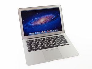

This teardown is not a repair guide. To repair your MacBook Air 13" Mid 2012, use our service manual.
  1. MacBook Air 13" Mid 2012 Teardown, MacBook Air 13" Mid 2012 Teardown: step 1, image 1 of 2 MacBook Air 13" Mid 2012 Teardown, MacBook Air 13" Mid 2012 Teardown: step 1, image 2 of 2

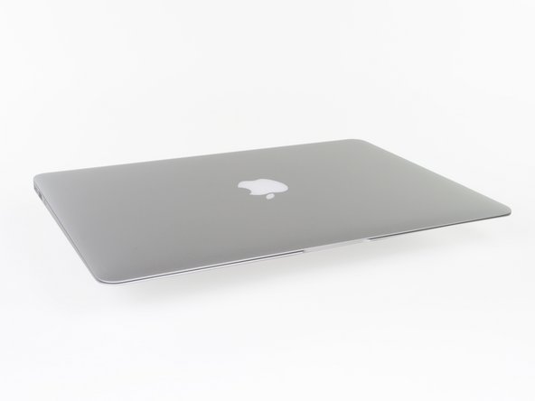

    • It's so light that it almost floats off the table…
    • So, what did Apple manage to pack into its ultra-slim ultrabook this time?
    • Intel Ivy Bridge Core i5 processor with Turbo Boost
    • Intel HD Graphics 4000
    • 128 GB flash memory
    • 4 GB 1600 MHz DDR3L RAM
    • USB 3.0
    • MagSafe 2

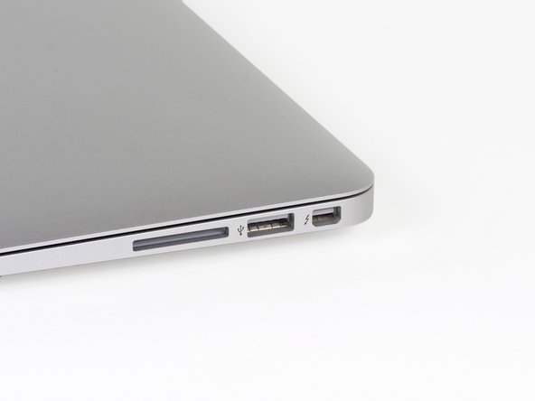

    • Accompanying the audio jack on the left side of the MacBook are the new MagSafe 2 connector and the first of two USB 3.0 ports.
    • On the opposite side, we find an SD card reader, the second USB 3.0 port, and—of course—Apple and Intel's brainchild: the Thunderbolt I/O.

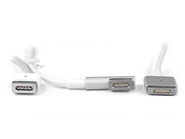

  4. MacBook Air 13" Mid 2012 Teardown: step 4, image 1 of 2 MacBook Air 13" Mid 2012 Teardown: step 4, image 2 of 2
    • MagSafe 2 is a luxury reserved (so far) for the new MacBook Air and the Retina display-equipped MacBook Pro.
    • As you can see, the new MagSafe 2 connector (bottom) is much thinner and wider than its predecessor. This is pretty significant, because the thickness of Apple's devices seems to be limited only by the size of their ports.
    • Imagine how thin of a device they could make if all communication and charging were done wirelessly…
    • Apple sells a $10 MagSafe 2 adapter, so you don't have to throw away your 27" Thunderbolt Display. Phew.
    • Apple never stops tweaking the details; they moved the symbols from the rear side of the ports to the front. If you're in a pinch and have to differentiate a Mid 2012 MacBook Air from a Mid 2011 model, just look at what side of the ports the symbols are on.

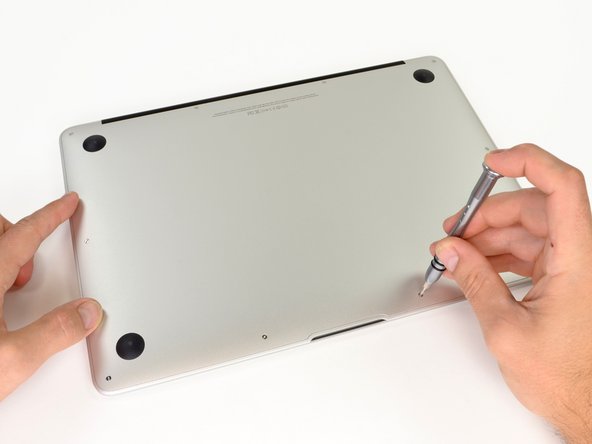

  5. MacBook Air 13" Mid 2012 Teardown: step 5, image 1 of 3 MacBook Air 13" Mid 2012 Teardown: step 5, image 2 of 3 MacBook Air 13" Mid 2012 Teardown: step 5, image 3 of 3
    Tool used on this step:
    P5 Pentalobe Screwdriver Retina MacBook Pro and Air
    $5.99
    Buy

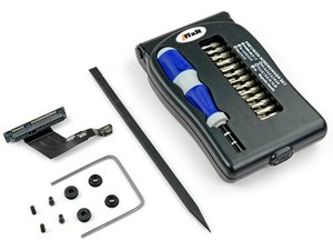

    • There was tension in the Air as we encountered a few unknown sized, Apple-proprietary, pentalobe screws on the back of the new Air.
    • Fortunately, we have tools for that. Our pentalobe screwdriver made quick work of those pesky proprietary screws.

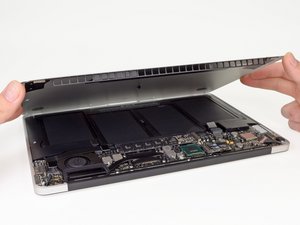

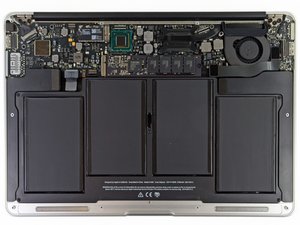

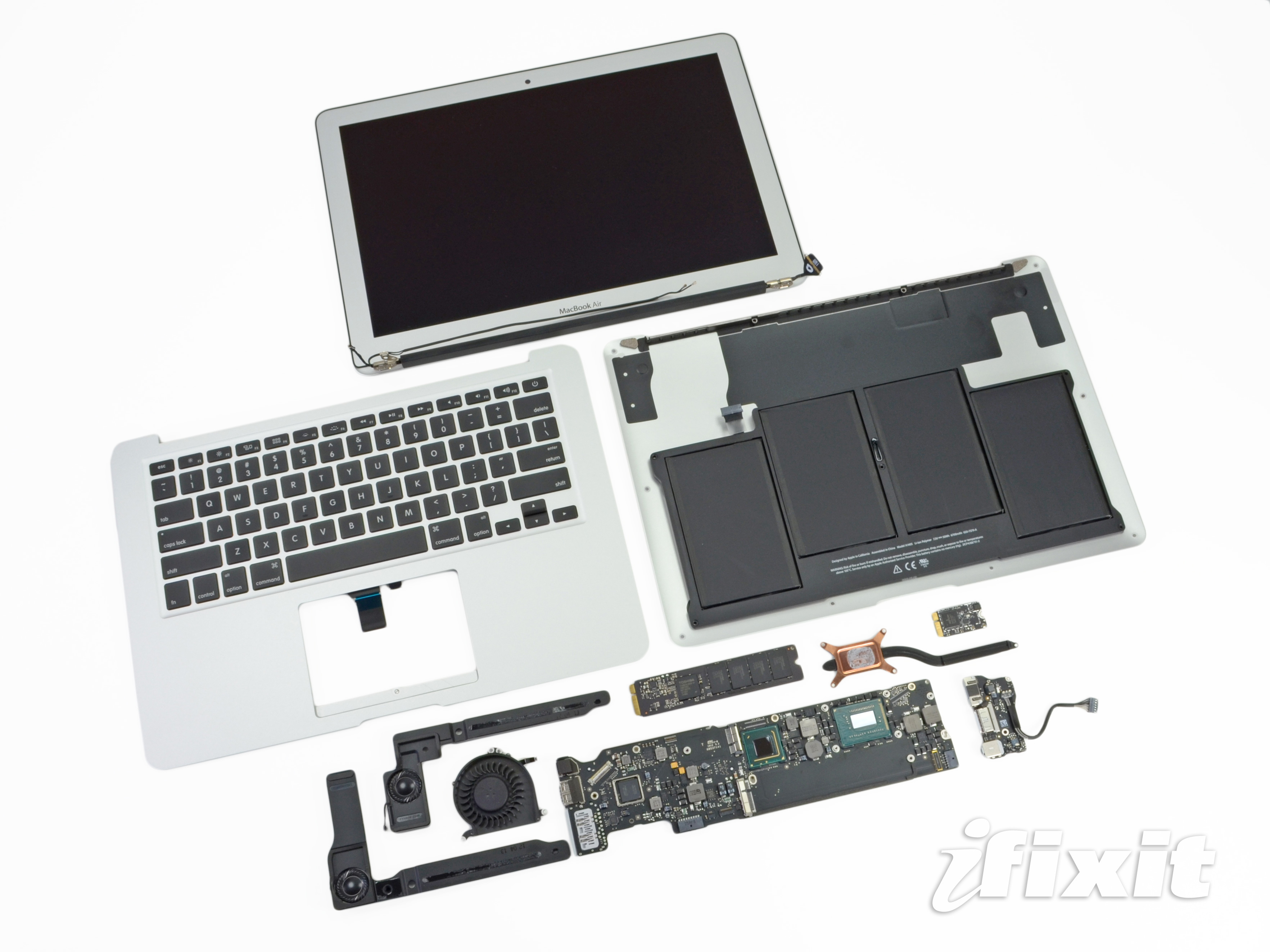

    • After removing the screws, the back comes off to reveal the internals.
    • Keeping all the screws we removed organized is easy with our Magnetic Project Mat.
    • As with most mobile devices, the majority of the space is filled by the battery.
    • The inside of this newly configured Air is very similar to last year, with a few minor layout changes.

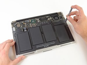

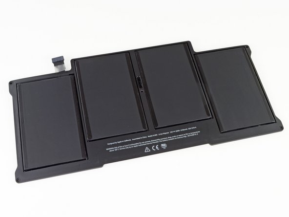

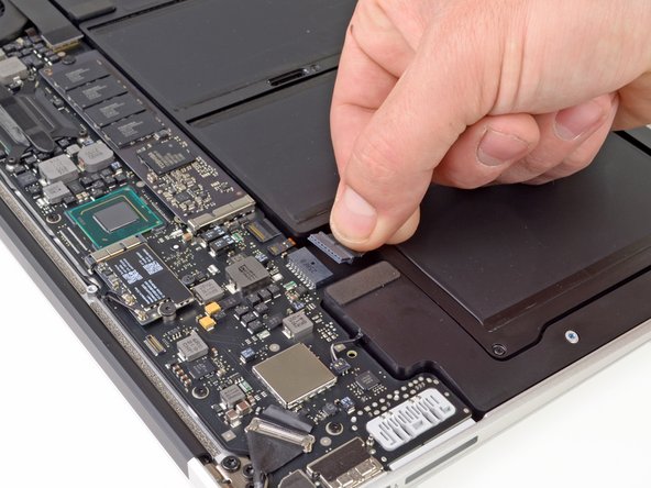

    • A connector and some T5 screws are all that stand between us and ultimate power—or at least the power source for the Air.
    • This battery is the exact same model as the one found in the Mid 2011 MacBook Air, so it comes as no surprise that the 13" model has the same 7 hour battery life as its predecessor.
    • We'll go ahead and answer the question before it's asked: yes, you can swap 2011 and 2012 batteries. We're not really sure why you would, though, considering they are exactly the same.

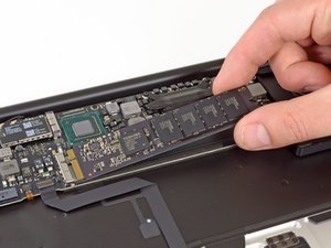

    • At first glance, the 128 GB SSD is almost exactly the same as last year's.
    • But upon closer inspection, the connector for this model's flash memory module is slightly different than last year!
    • The SSD looks to be a completely new design. The new unit appears to be based on a SandForce controller chip, but stamped with Toshiba markings.

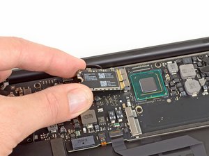

    • We would tell you that this Broadcom BCM 943224 module looks just like the Mid 2011 MacBook Air's wireless board, but you would accuse us of being repetitive.
    • Instead, let's focus on what's different. Apple rotated the "Assembled in China" sticker 90Ëš and flipped the internal code sticker a whopping 180Ëš!
    • In case you thought we were joking, taking the EMI shield off reveals the same chips as last year:
    • Broadcom BCM4322 Intensi-fi® Single-Chip 802.11n Wi-Fi Transceiver
    • Broadcom BCM20702 Single-Chip Bluetooth 4.0 Processor with Bluetooth Low Energy (BLE) support
    • Murata antenna switch module

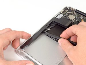

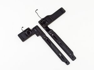

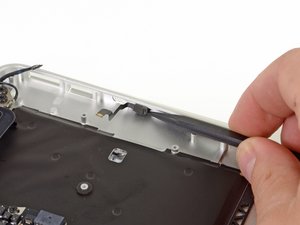

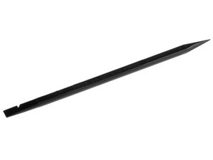

    • Next up are the speakers.
    • The new Air boasts stereo speakers for all your Apple party needs. Just in case you want to party like it's 2011 or 2010...
    • You may be asking, "What's that black stick being used to remove the speaker?" That is a Spudger. It's ESD safe and heat/solder resistant. It's a must for working with sensitive electronics.

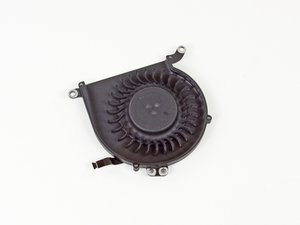

  12. MacBook Air 13" Mid 2012 Teardown: step 12, image 1 of 2 MacBook Air 13" Mid 2012 Teardown: step 12, image 2 of 2

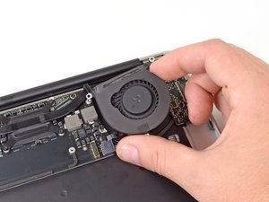

    • A few more Torx screws hold the lonely fan in place.
    • We were hoping to find a new asymmetrical fan, and we were not disappointed!
    • The wider gaps in the fan blades are around 3.6 mm, while the narrower ones are approximately 2.8 mm.
    • If you're not familiar with all the hype, the "asymmetrical" design of the fan blades is supposed to disperse sound across a wide range of frequencies, rather than just one, making fan noise "hardly perceivable."

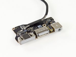

  13. MacBook Air 13" Mid 2012 Teardown: step 13, image 1 of 2 MacBook Air 13" Mid 2012 Teardown: step 13, image 2 of 2
    • Next out is the left side I/O board, featuring the slimmed down MagSafe 2 port.
    • Sitting side-by-side with MagSafe 2 and USB 3.0, the standard 3.5 mm headphone jack looks quite plain and outdated. How long must we wait until Apple announces "The New Jack"?

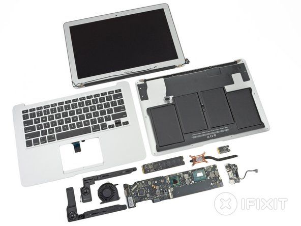

  15. MacBook Air 13" Mid 2012 Teardown: step 15, image 1 of 3 MacBook Air 13" Mid 2012 Teardown: step 15, image 2 of 3 MacBook Air 13" Mid 2012 Teardown: step 15, image 3 of 3

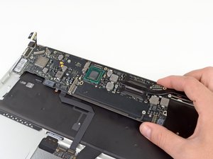

    • Boom! There goes the logic board.

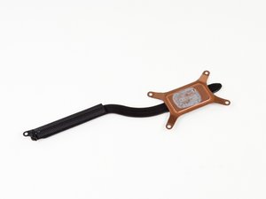

    • Bam! There goes the heat sink.
    • Even with a new processor lineup, the thermal management system looks pretty much the same as last year. It truly is a testament to modern processor efficiency to see such a small heat sink on a dual-core processor that can crank out up to 2.8 GHz.
  16. MacBook Air 13" Mid 2012 Teardown: step 16, image 1 of 1
    • Here's what we found on side A of the logic board:
    • Intel Core i5-3427U 1.8 GHz dual-core processor (Turbo Boost up to 2.80 GHz) with Intel HD Graphics 4000
    • Intel E201B953 SLJ8B Platform Controller Hub
    • Intel DSL3510L Thunderbolt controller
    • Texas Instruments TPS2561 dual channel power switch
    • Linear Technology LT3957 inverting converter
  17. MacBook Air 13" Mid 2012 Teardown: step 17, image 1 of 1

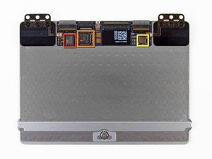

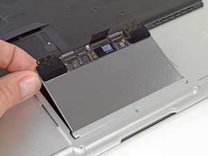

    • Good news everyone! If you're ever faced with a nonfunctional trackpad, It seems replacing the trackpad remains as easy as ever.
    • A few notable chips we found on the trackpad:
    • Silicon Storage Technology 25VF020
    • Cypress Semiconductor CY8C24794 Microcontroller
    • Broadcom BCM5976A0KU826

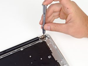

  19. MacBook Air 13" Mid 2012 Teardown: step 19, image 1 of 2 MacBook Air 13" Mid 2012 Teardown: step 19, image 2 of 2
    • The display assembly is screwed to the upper case with six T8 Torx screws.
    • Because the display assembly is one of the few moving parts in the MacBook Air, these screws have to be pretty staunch.
    • In order to save weight in the MacBook Air, there is no protective front glass covering the LCD like there is on the MacBook Pro. This is also the reason for the aluminum bezel.
  20. MacBook Air 13" Mid 2012 Teardown: step 20, image 1 of 2 MacBook Air 13" Mid 2012 Teardown: step 20, image 2 of 2
    • MacBook Air 13" Mid 2012 Repairability Score: 4 out of 10 (10 is easiest to repair).
    • Once you manage to take off the bottom cover, all the parts are pretty easily replaceable.
    • Proprietary screws on the case require the right screwdriver.
    • All the components—including RAM and SSD—are proprietary.
    • This is a difficult machine for us to recommend because of the lack of upgradeability. The RAM and SSD are not currently upgradeable, although SSD options may become available in time. While Apple's continued use of proprietary screws is helping our booming tool sales, it's a bad thing for consumers.
