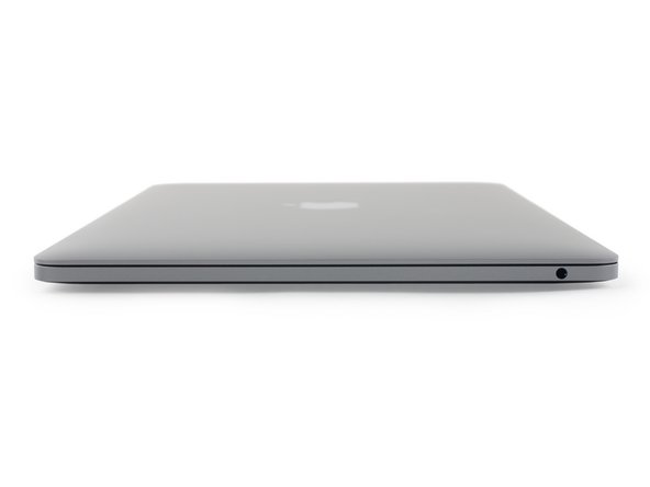

    • Two Thunderbolt 3 ports populate the left side of this laptop... and that's all.
    • The USB-C form factor is versatile, but you'll likely need a fistful of adapters to interface with your existing hardware.
    • On the right side, a lone 3.5 mm headphone jack.

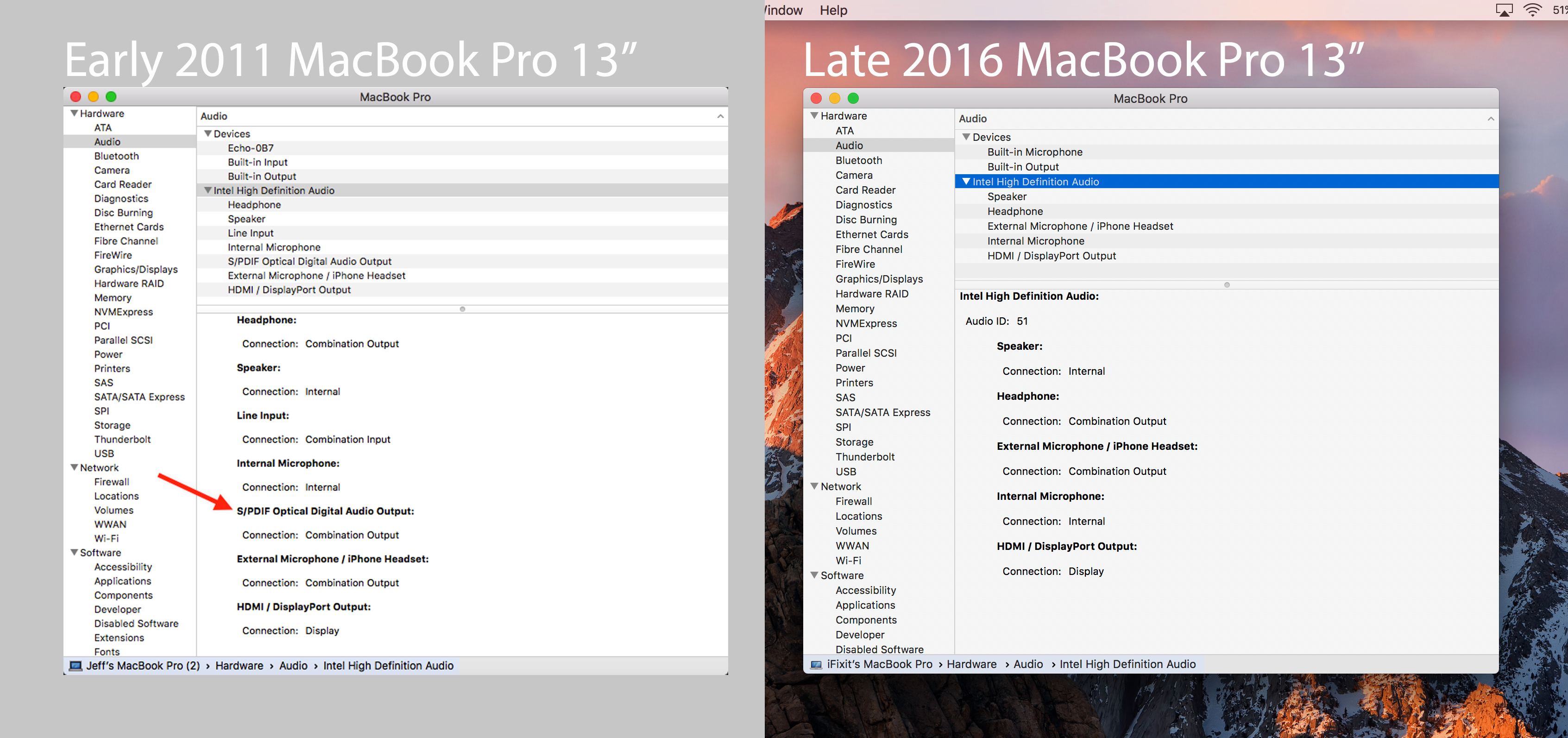

    • Wait, what?
    • After all the hubbub about how the headphone jack is antiquated hardware that doesn't deserve a space on the iPhone 7, this seems... odd.
    • But hey, who are we to judge? It's a widely used standard and we're 100% on board with that. Just know that you can't plug in your iPhone 7's Lightning EarPods, as the necessary dongle doesn't exist.

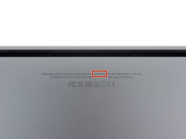

    • Completing our inspection of the outer case, we note the new model number: A1708.

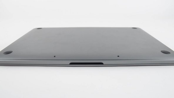

    • Well, this is new. We're momentarily stumped by the new, extra-secure lower case, before we crack the code to remove it.
    • A suction cup helps lift the lower edge enough to get an opening pick in, to pop hidden clips on each side. After that, you slide the entire lower case down and you're home free.
    • All of the extra clips and hooks help the lower case serve as case-stiffener, in lieu of the normal amount of screws.

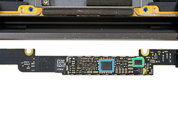

  6. MacBook Pro 13" Function Keys Late 2016 Teardown: step 7, image 1 of 3 MacBook Pro 13" Function Keys Late 2016 Teardown: step 7, image 2 of 3 MacBook Pro 13" Function Keys Late 2016 Teardown: step 7, image 3 of 3
    • Following our intuition, we try for the trackpad next, and are pleasantly surprised at the ease of its removal.
    • This represents a huge improvement over the previous 13" MacBook Pro, where the trackpad was trapped under the battery.
    • We find some familiar digital hardware piggybacking on the trackpad:
    • STMicroelectronics STM32F103VB ARM Cortex-M3 MCU
    • Broadcom BCM5976C1KUFBG Touch Controller
    • Bosch Sensortec BMA282 accelerometer
    • Texas Instruments TMP421 remote/local temperature sensor
    • We also find the Taptic Engine, AKA the magic electromagnet behind Force Touch, to be simply secured with screws and spring contacts.

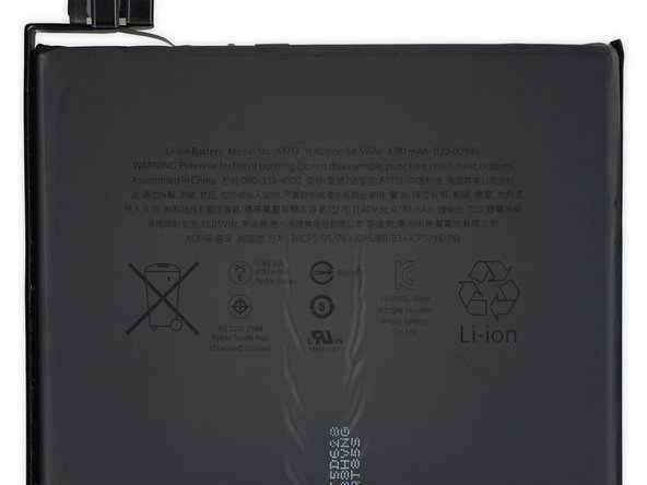

  9. MacBook Pro 13" Function Keys Late 2016 Teardown: step 10, image 1 of 3 MacBook Pro 13" Function Keys Late 2016 Teardown: step 10, image 2 of 3 MacBook Pro 13" Function Keys Late 2016 Teardown: step 10, image 3 of 3
    • At 54.5 Wh, this battery doles out ~27% less power between charges than last year's edition—although with just three cells instead of six, it might be a tad easier to remove.
    • That said, this Pro actually packs more oomph than its Touch Bar-equipped sibling, whose battery clocks in at 49.2 Wh.
    • Plus, Apple claims this battery's good for 10 hours of wireless web browsing, equivalent to both last year's 13" MacBook Pro and the 41.4 Wh Retina MacBook 2016.
    • Up top, we find this battery control board which — unlike the impeccably manicured components surrounding it — is coated in thick epoxy à la Apple's Lightning-to-headphone dongle.

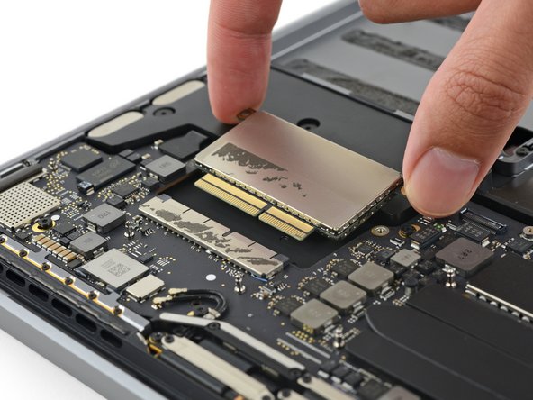

  10. MacBook Pro 13" Function Keys Late 2016 Teardown: step 11, image 1 of 2 MacBook Pro 13" Function Keys Late 2016 Teardown: step 11, image 2 of 2
    • Turning our attention to the very well-shielded SSD, we start by peeling up this massive patch of protective tape.
    • Per Apple, we know the SSD itself uses a high-speed PCIe-based interface—but this form factor and pin configuration look new.
    • Time to pry those shields off and see exactly what Apple cooked up here...
    • It's nice that Apple has kept their removable SSDs a first-out component, simplifying upgrades.

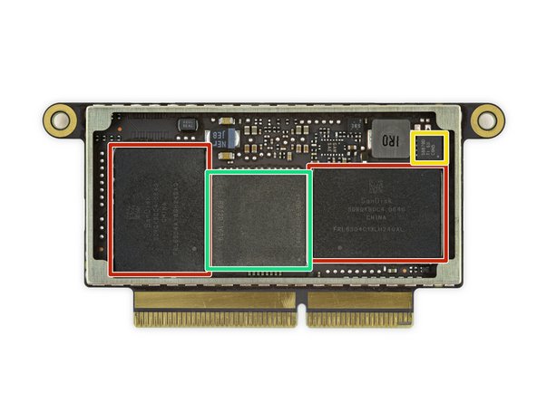

  11. MacBook Pro 13" Function Keys Late 2016 Teardown: step 12, image 1 of 3 MacBook Pro 13" Function Keys Late 2016 Teardown: step 12, image 2 of 3 MacBook Pro 13" Function Keys Late 2016 Teardown: step 12, image 3 of 3
    • Let's take a look at what's powering this sideways storage slate:
    • SanDisk SDRQKBDC4 064G 64 GB NAND flash memory (x4 for a total of 256 GB).
    • Apple 338S00227 SSD power management
    • Texas Instruments CSD58879D MOSFET
    • F4432ACPE-GD-F likely Micron 512 MB DDR2 RAM
    • On a hunch, we hunted under this chip.
    • Success! A reflow revealed: Apple 338S00199 SSD controller
    • This marks the first time we've seen Apple's super-custom SSD controller in a removable PCIe SSD. Let's hope these suckers will be available for future upgrades!

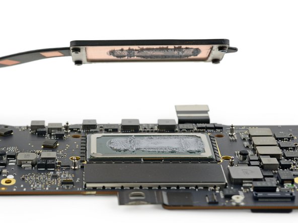

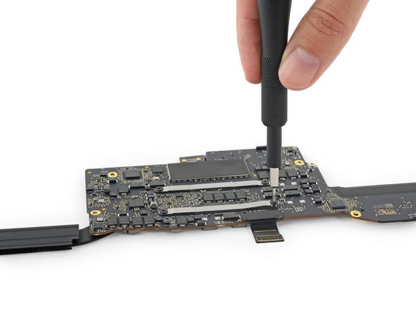

  13. MacBook Pro 13" Function Keys Late 2016 Teardown: step 14, image 1 of 3 MacBook Pro 13" Function Keys Late 2016 Teardown: step 14, image 2 of 3 MacBook Pro 13" Function Keys Late 2016 Teardown: step 14, image 3 of 3
    • Given our excitement surrounding the logic board removal (and the amount of ornaments and wrapping paper just unleashed in stores everywhere), you might think Christmas came 54 days early.
    • We begin to look for the "advanced thermal architecture" Apple boasted in its press release the way a child might rifle through her stocking on Christmas morning.
    • ...We're a little disappointed that advanced architecture really meant "relocation of the heat sink screws to the backside of the logic board."
    • That claim was a little bold courageous if you ask us.

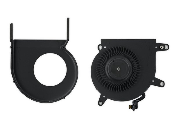

  19. MacBook Pro 13" Function Keys Late 2016 Teardown: step 20, image 1 of 2 MacBook Pro 13" Function Keys Late 2016 Teardown: step 20, image 2 of 2
    • Before we hit Retina, we scrape out a fancy fan. These blades are supposedly super quiet due to their asymmetrically spaced blades.
    • Interestingly enough, while Jony Ive was jazzed about "thinner, variably spaced fan blades," this tech has been included in certain MacBook Pro models since 2012.
    • There's also a significant amount of space not taken up by blades—that's probably another sick thermal system feature. Plus it looks nice in the video.
    • Likely a Texas Instruments motor controller on the fan flex cable

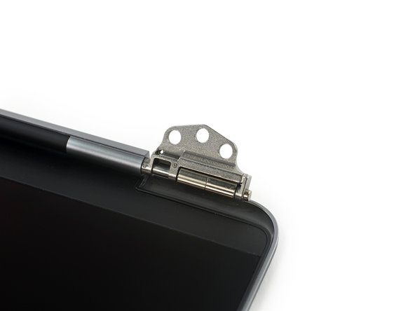

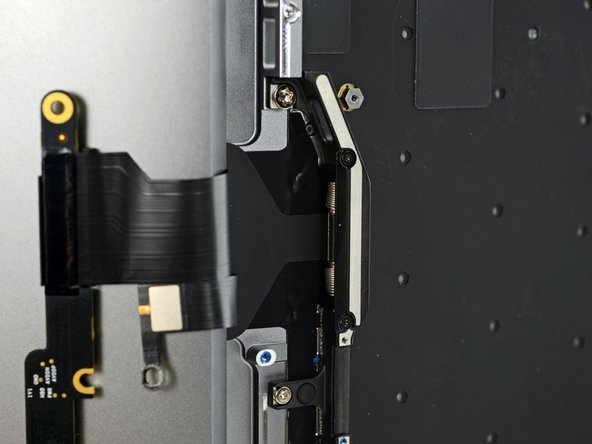

  21. MacBook Pro 13" Function Keys Late 2016 Teardown: step 22, image 1 of 3 MacBook Pro 13" Function Keys Late 2016 Teardown: step 22, image 2 of 3 MacBook Pro 13" Function Keys Late 2016 Teardown: step 22, image 3 of 3
    • At MacBook's edge we come across a shiny bar (held in by 12 P2 Pentalobe screws) that also serves as an antenna.
    • That's the 6th kind of bit! Remember the days you could upgrade your RAM, double up on storage, and drop in an SSD with a Phillips driver and a free afternoon? iFixit remembers.
    • Behind the antenna bracket, we spy some fancy tech along the Pro's spine.
    • A spring mechanism rolls a flat cable up when the display is closed, and unravels when the display opens. This seems to make it a bit easier to close the lid.
    • Perhaps shaving a few ounces off the display assembly meant the new MacBook Pro couldn't rely on gravity to close nicely as much as previous models have.
