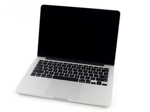

    • We've done this seven times before, but biting into a 13-inch professional-grade Apple is always a juicy treat.
    • Let's check out the latest tech specs:
    • 13.3-inch 2560-by-1600 pixel (227 ppi) retina display
    • 2.4 or 2.6 GHz dual-core Intel Core i5 processor (Optional 2.8 GHz dual-core Intel Core i7 available)
    • 4, 8 or 16 GB DDR3L on-board RAM
    • 128, 256, 512 GB or 1 TB SSD storage
    • Intel Iris Graphics
    • Thunderbolt 2, USB 3, and full-size HDMI I/O

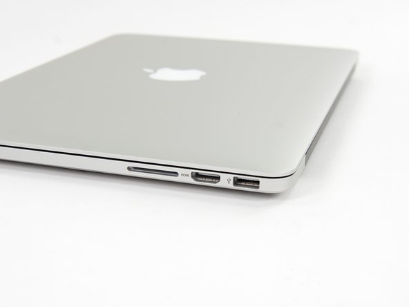

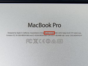

  2. MacBook Pro 13" Retina Display Late 2013 Teardown: step 2, image 1 of 2 MacBook Pro 13" Retina Display Late 2013 Teardown: step 2, image 2 of 2

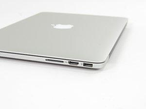

    • Right away we spy something unfamiliar: Model A1502 has never before been seen in the wild. Does that mean this critter's all new? We're about to find out.
    • Starboard-side ports include:
    • SDXC Card Slot
    • Full-size HDMI with 1080p output
    • USB 3.0
    • More ports on the port side!
    • Another USB 3.0
    • 2x Thunderbolt 2

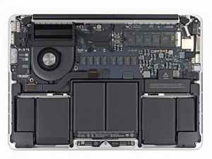

  3. MacBook Pro 13" Retina Display Late 2013 Teardown: step 3, image 1 of 2 MacBook Pro 13" Retina Display Late 2013 Teardown: step 3, image 2 of 2
    • By now, we're not even surprised to find the lower case held in place by pentalobe screws. Just ... disappointed.
    • It looks like this new revision has lost its cool—or at least half of it, as we're now down to a single fan.
    • Apple's holiday redecorating didn't stop there: rearranged cabling, a displaced SSD, and a drastically revised battery now deck these halls.

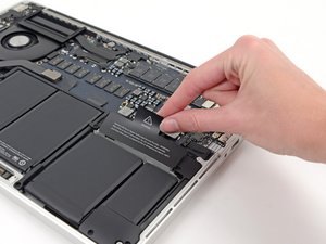

  4. MacBook Pro 13" Retina Display Late 2013 Teardown: step 4, image 1 of 2 MacBook Pro 13" Retina Display Late 2013 Teardown: step 4, image 2 of 2
    • As ever, Apple warns of tragic consequences if we attempt to service, remove, or engage in polite conversation with the battery.
    • Warning, schmorning—you know how we feel about these labels.

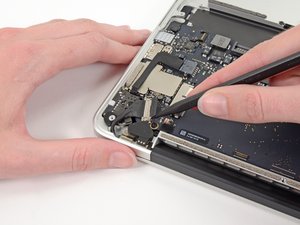

    • First rule of disassembly: disconnect the power. There is no shock like forgetting where the power lies.
    • We pop off the battery connector, but that fancy new battery controller board ain't goin' nowhere.
    • Those little screws, they do nothing! The board hosts some tricky wires that are soldered and routed to hold it in place. This assembly is turning into a serious brain teaser.

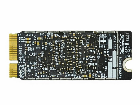

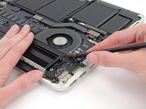

  5. MacBook Pro 13" Retina Display Late 2013 Teardown: step 5, image 1 of 3 MacBook Pro 13" Retina Display Late 2013 Teardown: step 5, image 2 of 3 MacBook Pro 13" Retina Display Late 2013 Teardown: step 5, image 3 of 3

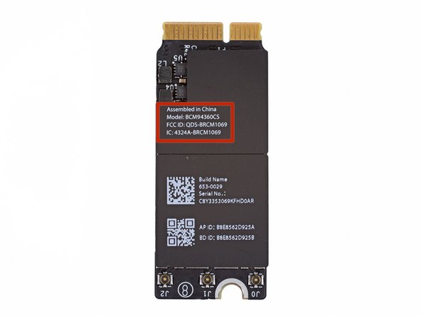

    • We spudger our way through the antenna cables and extract the slumbering AirPort card.
    • Don't worry—we promise to put it back before it wakes up.
    • It may reside in the same right-side location as ye olde model, but this here Broadcom BCM94360CS is a different animal.
    • New 802.11ac Wi-Fi tech claims triple the performance of 802.11n.

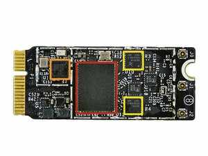

  6. MacBook Pro 13" Retina Display Late 2013 Teardown: step 6, image 1 of 2 MacBook Pro 13" Retina Display Late 2013 Teardown: step 6, image 2 of 2
    • Taking a peek under the covers of the revised AirPort Card, we find:
    • Broadcom BCM4360 5G Wi-Fi 3-Stream 802.11ac Gigabit Transceiver
    • Broadcom BCM20702 Single-Chip Bluetooth Processor with a High Performance Integrated 2.4-GHz RF Transceiver
    • Skyworks SE5516 Dual-Band 802.11a/b/g/n/ac WLAN Front-End Module

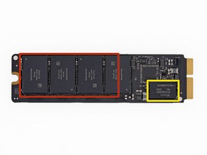

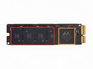

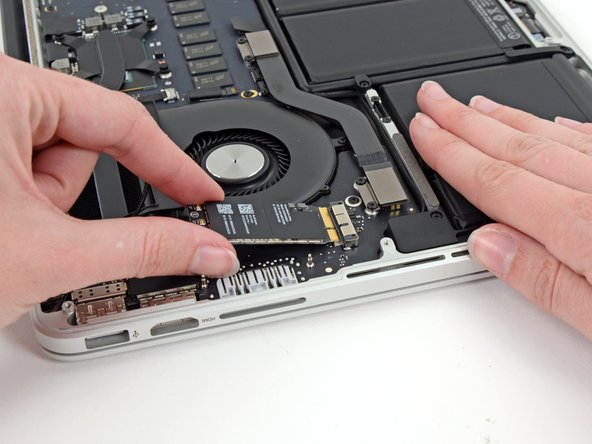

  7. MacBook Pro 13" Retina Display Late 2013 Teardown: step 7, image 1 of 3 MacBook Pro 13" Retina Display Late 2013 Teardown: step 7, image 2 of 3 MacBook Pro 13" Retina Display Late 2013 Teardown: step 7, image 3 of 3

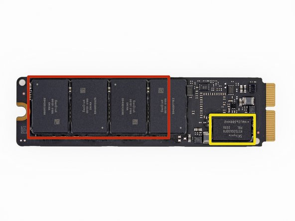

    • SSDs may not spin like other hard-disk drives, but the one in the 13" MacBook Pro Retina sure does like to hop around!
    • This Pro comes with a base 128 GB of flash storage, with the larger models sporting 256 or 512 GB.
    • Apple notes that the 512 GB model is configurable up to 1 TB of storage, just in case your kitten archives won't fit on the dinky 512 GB SSD.
    • Notable bits and pieces:
    • SanDisk 05131 016G 16 GB NAND Flash (total of 8 x 16 GB = 128 GB)
    • Marvell Semiconductor 88SS9183 SSD Controller
    • SK Hynix H5TQ2G63DFR DDR3-1600

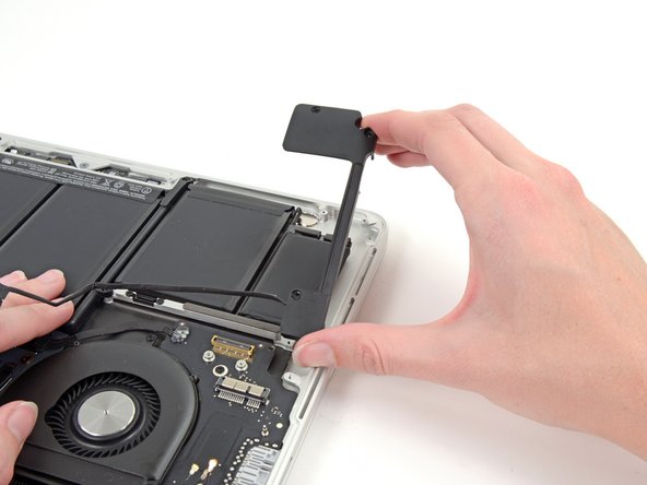

  8. MacBook Pro 13" Retina Display Late 2013 Teardown: step 8, image 1 of 3 MacBook Pro 13" Retina Display Late 2013 Teardown: step 8, image 2 of 3 MacBook Pro 13" Retina Display Late 2013 Teardown: step 8, image 3 of 3

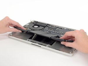

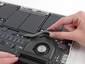

    • Wingardium leviosa! The I/O board cable practically floats out of its sockets.
    • Our handy-dandy magic wand Pro Tech Screwdriver makes speaker screw removal seem like magic.
    • Another swish and flick and the speakers are charmed out of the rear case.
    • We're happy to report that these speakers-who-must-not-be-named are fairly easy to remove—no dark magic required.

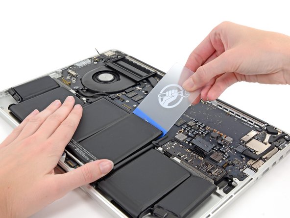

  9. MacBook Pro 13" Retina Display Late 2013 Teardown: step 9, image 1 of 3 MacBook Pro 13" Retina Display Late 2013 Teardown: step 9, image 2 of 3 MacBook Pro 13" Retina Display Late 2013 Teardown: step 9, image 3 of 3
    Tool used on this step:
    iOpener
    $19.99
    Buy

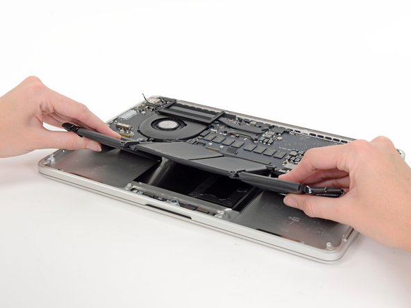

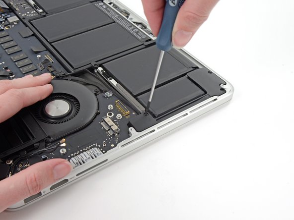

    • Oh MBP battery adhesive, you're breaking our hearts. We've fought this battle before—multiple times, in fact.
    • To make matters worse, the screwed-in battery caddies of yesteryear have moved over the trackpad, burying the poor thing alive.
    • We launch the rescue effort with our friends, iOpener and plastic card; after a hearty swig of patience, we set to work.
    • Victory! At long last, the awkward battery assembly is wrested from the case.
    • The new center panel batteries proved to be the toughest to extract due to the cable armature surrounding it and some crazy-strong adhesive.

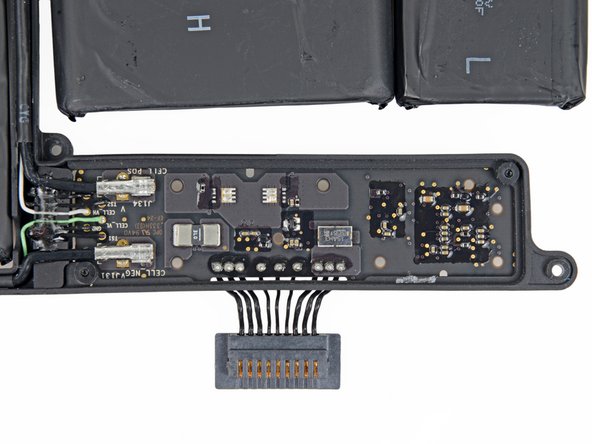

  10. MacBook Pro 13" Retina Display Late 2013 Teardown: step 10, image 1 of 3 MacBook Pro 13" Retina Display Late 2013 Teardown: step 10, image 2 of 3 MacBook Pro 13" Retina Display Late 2013 Teardown: step 10, image 3 of 3

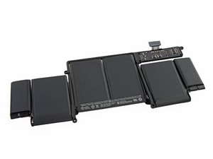

    • Take a look at that six pack!
    • Here's the muscle: coming in at 71.8 Wh this 11.34 V battery is ever-so-slightly down on oomph from last year. But thanks to other improvements, Apple claims a 9-hour battery life during normal use.

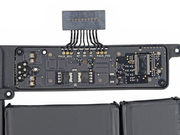

    • With the battery free, we finally get a better look at the connector.
    • It's certainly nice to see a more conventional battery connector, rather than the earlier revision's contact board shenanigans. But at what cost, Apple?

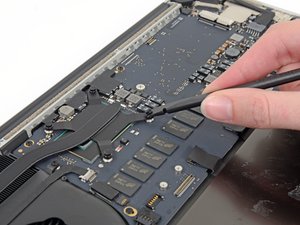

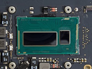

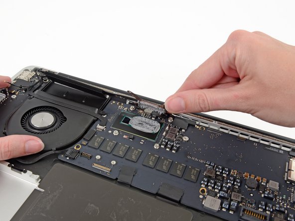

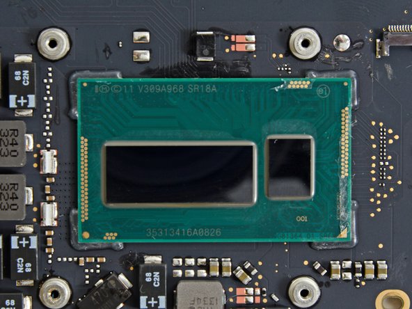

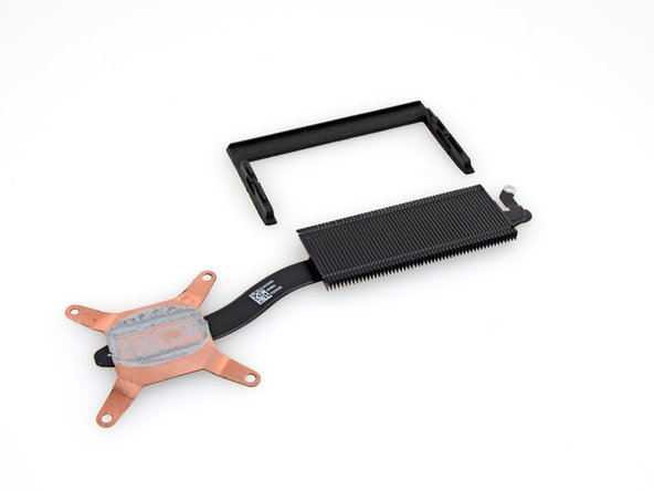

    • We spudge off some sticky foam screw coverings and remove the heat sink to find...goopy thermal paste.
    • As Apple rolls out Intel's new Haswell processors and Iris Graphics, we're seeing a massive heat sink consolidation trend making for a cleaner and more streamlined design.
    • The CPU and GPU share the same large die on the right, and the southbridge(PCH) on the left

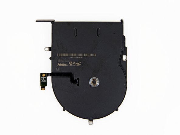

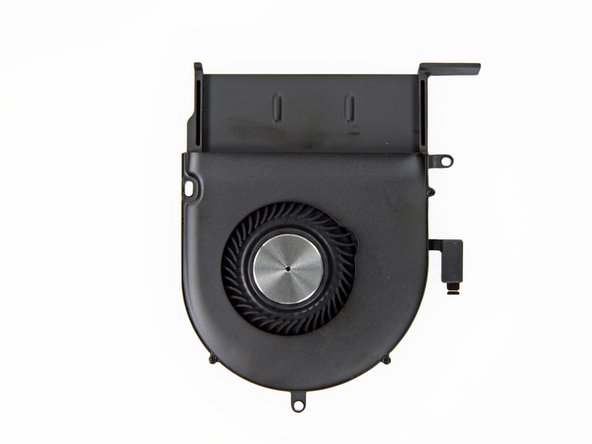

    • With the heat sink gone, it's time to cool off! Well, time to take the fan off at least.
    • The brushless Nidec fan isn't blowing us away with any new innovations, but we appreciate its efforts to keep things from boiling over.

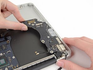

  13. MacBook Pro 13" Retina Display Late 2013 Teardown: step 13, image 1 of 3 MacBook Pro 13" Retina Display Late 2013 Teardown: step 13, image 2 of 3 MacBook Pro 13" Retina Display Late 2013 Teardown: step 13, image 3 of 3

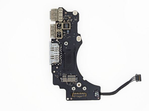

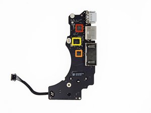

    • We're getting down to brass tacks as the I/O board comes out for inspection.
    • Included ICs:
    • Parade Technology PS8401A HDMI Jitter Cleaning Repeater
    • An HDMI jitter-cleaning repeater chip compensates for HDMI signal skew caused by long signal traces, connectors and cables. Without jitter-cleaning technology, systems may fail the HDMI 1.4 jitter compliance test or exhibit poor video performance.
    • NXP Semiconductors PCA9501 8-bit I/O Expander with an On-Board 2-kbit EEPROM
    • Genesys Logic GL3219 SDXC Card Reader Controller

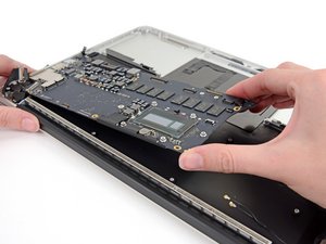

  14. MacBook Pro 13" Retina Display Late 2013 Teardown: step 14, image 1 of 3 MacBook Pro 13" Retina Display Late 2013 Teardown: step 14, image 2 of 3 MacBook Pro 13" Retina Display Late 2013 Teardown: step 14, image 3 of 3

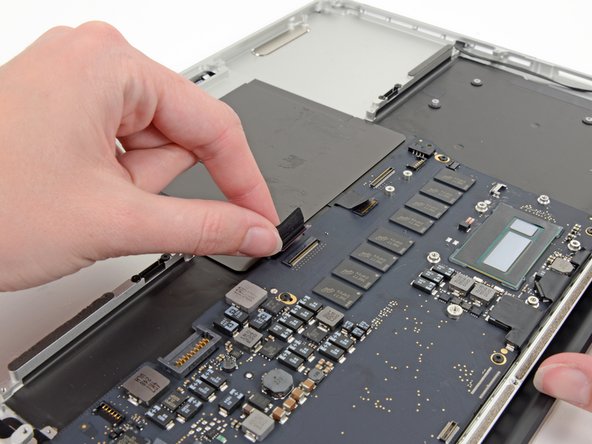

    • A few measly connectors are all that stand between us and total logic board liberation; they are dealt with harshly.
    • The MBP's secrets can run, but they can't hide. Also, they can't really run. That would be a cool upgrade, though.
    • Then again...

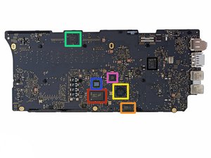

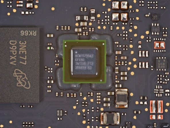

  16. MacBook Pro 13" Retina Display Late 2013 Teardown: step 16, image 1 of 2 MacBook Pro 13" Retina Display Late 2013 Teardown: step 16, image 2 of 2
    • Back side of logic board:
    • Micron D9PXV 4 Gb (512 MB) DDR3L SDRAM
    • MXIC MX25L6406E 64M-bit CMOS Serial Flash
    • Texas Instruments Stellaris LM4FS1EH Microcontroller
    • Cypress CY8C24794-24LTXI Programmable System-on-Chip
    • Broadcom BCM15700A2
    • P13WVR 12612NEE
    • Linear Technology LT3957 B29255

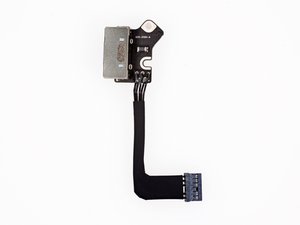

    • Next to come out is the MagSafe 2 port.
    • We're happy to see that the power adapter resides on its very own connector, meaning that if you need to replace it, you won't need to replace any extra parts along with it.
    • While it still holds the same MagSafe 2 technology, the connector has been updated slightly from previous versions.

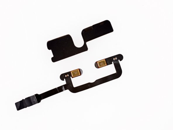

    • Flying through components, we come to the dual mic—hidden under a rubber cover. The time for eavesdropping is over, mic; you've been exposed.

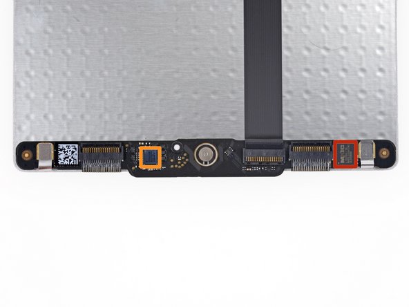

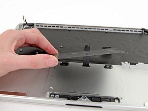

    • We already coaxed the battery from its gooey perch above the trackpad; does this metal plate really think it can slow us down?
    • Don't worry—steel is weak to fire—we attack with iOpener; it's super effective!
    • Under that hefty metal armor, we find much the same trackpad as in the 2012 edition.
    • ICs include:
    • Macronix MX25L2006E 16M-bit CMOS Serial Flash
    • Broadcom BCM5976 Touchscreen Controller (as found in the earlier versions and the iPhone 5)

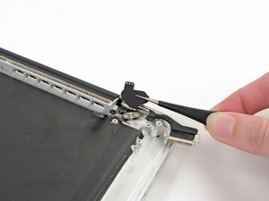

  19. MacBook Pro 13" Retina Display Late 2013 Teardown: step 19, image 1 of 3 MacBook Pro 13" Retina Display Late 2013 Teardown: step 19, image 2 of 3 MacBook Pro 13" Retina Display Late 2013 Teardown: step 19, image 3 of 3

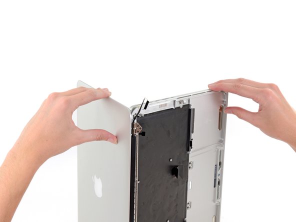

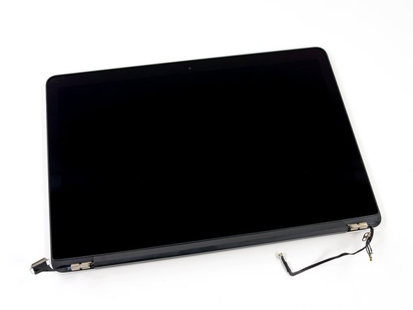

    • The usual black rubber conceals the display hinge screws and some new adhesive.
    • Hey Apple, do you think next time you could mark up the screws removed during display replacement? You were so close this time.
    • We let this display off with a warning, but if you're dying to see inside, how about a blast from the past?
    • This display, as with its predecessors, must be replaced as an assembly; there's no parting out this bad boy.

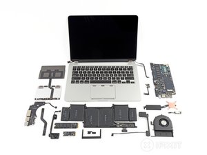

  20. MacBook Pro 13" Retina Display Late 2013 Teardown: step 20, image 1 of 2 MacBook Pro 13" Retina Display Late 2013 Teardown: step 20, image 2 of 2
    • MacBook Pro with Retina Display 13" Late 2013 Repairability Score: 1 out of 10 (10 is easiest to repair)
    • Proprietary pentalobe screws continue to make opening the device unnecessarily difficult.
    • The battery assembly is now entirely, and very solidly, glued into the case, thus complicating replacement. Additionally, the battery now covers the screws and cable holding the trackpad in place. It is impossible to replace the trackpad without first removing the battery.
    • The Retina display is a fused unit with no protective glass. If anything ever fails inside the display, the entire ($$$) assembly will need to be replaced.
    • The RAM is soldered to the logic board, following the lead of the MacBook Air. Pay for the upgrade now, or be stuck with 4 GB forever. There is no chance of upgrade.
    • The proprietary SSD is now in a PCIe format, but still isn't a standard drive. Cross your fingers for future compatible drives; for now, you're stuck with what you've got.

Is it me or does the heat sink not cover the CPU of the Haswell package?
s9d0wldl - Reply
The left part is only the south bridge. There is no need for cooling it
phgaertig -
