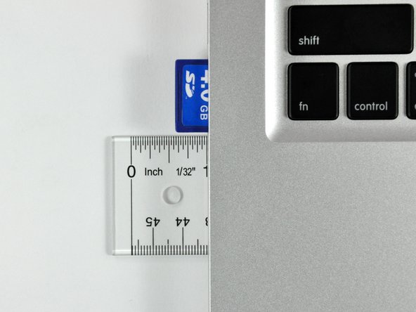

    • Some comparisons to the MacBook Unibody:
    • No access door for the battery on the bottom.
    • The addition of an SD card slot (and the omission of digital/mic port) is readily apparent.
    • FireWire is back!
    • Computer lock is now on the other side.
    • The SD card sticks out almost .5"! This is a cheeseball design for a MacBook "Pro" if you ask us.

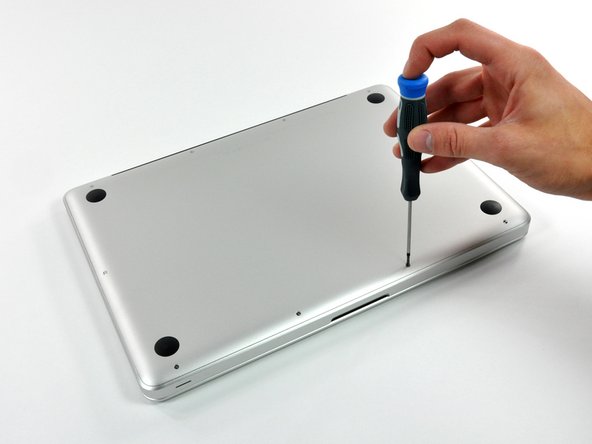

    • Let's get down to business.

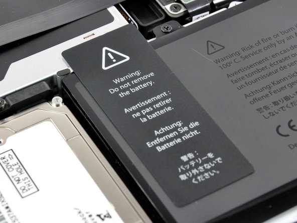

    • There's no door latch, going along with the "not user-serviceable battery" theme.
    • We had to dig out a Phillips screwdriver for this step.
    • A quick flip of the lid and...

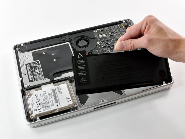

  5. MacBook Pro 13" Unibody Mid 2009 Teardown: step 5, image 1 of 3 MacBook Pro 13" Unibody Mid 2009 Teardown: step 5, image 2 of 3 MacBook Pro 13" Unibody Mid 2009 Teardown: step 5, image 3 of 3

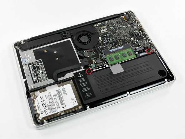

    • ...It's almost exactly the same as our old, "lesser" MacBook Unibody.
    • The battery compartment is identical to the one we uncovered in the MacBook Pro 17" Teardown. We'll venture a guess that it looks the same in the updated 15" Pro as well.

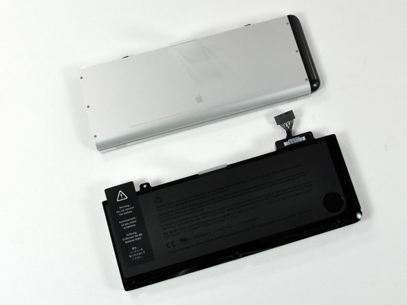

    • Remove two tri-wing screws and the battery is suddenly replaceable. The sticker comes right off, just as in the 17" Pro -- because it's adhered to just the battery and midwall, not to the optical drive.
  6. MacBook Pro 13" Unibody Mid 2009 Teardown: step 6, image 1 of 3 MacBook Pro 13" Unibody Mid 2009 Teardown: step 6, image 2 of 3 MacBook Pro 13" Unibody Mid 2009 Teardown: step 6, image 3 of 3

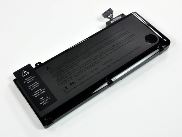

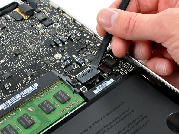

    • 7-hour battery specifications:
    • Model A1322
    • 10.95V
    • 60Wh
    • "This battery contains no mercury (Hg)."
    • When working on all machines that have internal batteries, disconnect the battery first to cut off power to the entire device.
    • Apple does offer battery replacement service for $129. If you're not near an Apple Store or service provider, you'll be without your machine 3-4 business days.
    • Although the batteries look similar, they're definitely not interchangeable. The MacBook Pro's battery is too large (and different in shape) to fit into the older MacBook Unibody.

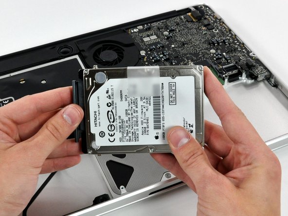

    • Removing the hard drive...
    • It's still considered user-replaceable by Apple, but replacement does require removing 10 more screws than on the MacBook Unibody.
    • First thing we'd do is replace the 160 GB Hitachi with something more meaty.

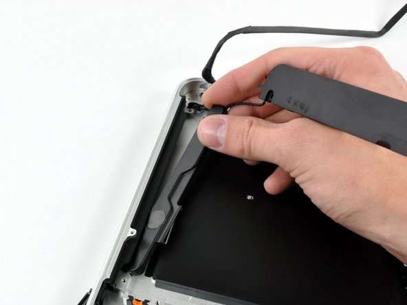

    • The subwoofer comes off after removing two screws.

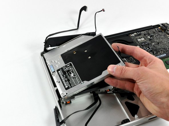

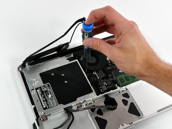

    • The optical drive is attached via three Phillips screws.
    • The brackets and screw layout are identical to the older MacBook Unibody.
  10. MacBook Pro 13" Unibody Mid 2009 Teardown: step 10, image 1 of 2 MacBook Pro 13" Unibody Mid 2009 Teardown: step 10, image 2 of 2

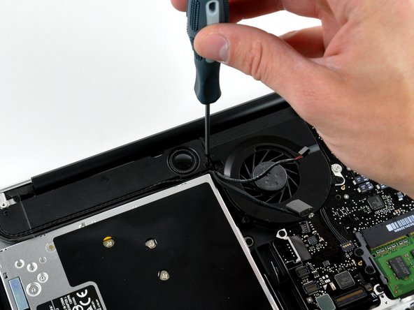

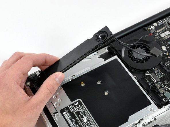

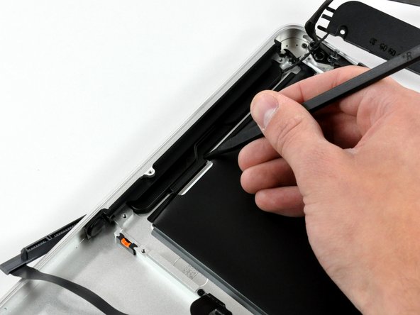

    • Removing the optical drive exposes the right speaker.
    • It's held in place by adhesive. A quick pry with the spudger will loosen it.
  11. MacBook Pro 13" Unibody Mid 2009 Teardown: step 11, image 1 of 3 MacBook Pro 13" Unibody Mid 2009 Teardown: step 11, image 2 of 3 MacBook Pro 13" Unibody Mid 2009 Teardown: step 11, image 3 of 3

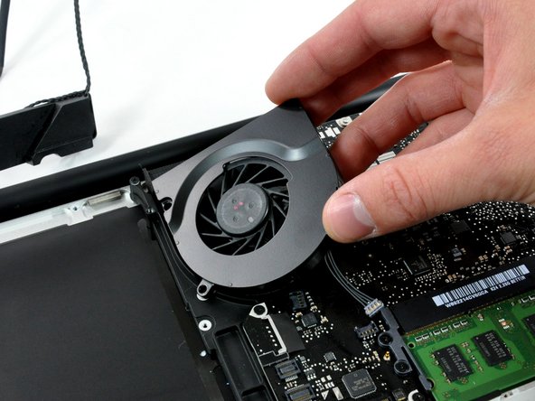

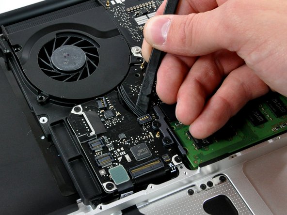

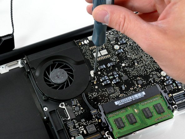

    • A connector, three Phillips screws, and bam -- the fan's out!

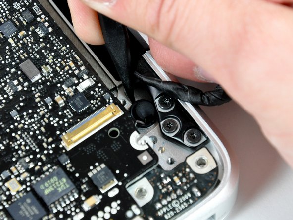

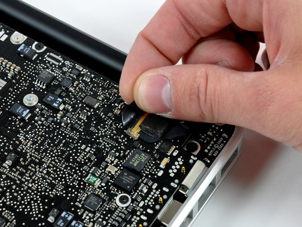

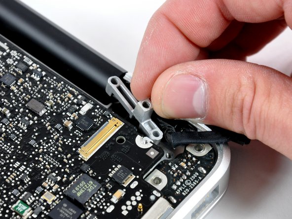

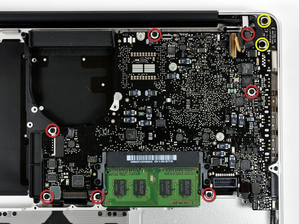

    • Disconnect the LVDS connector.
    • Remove 7 motherboard screws.
    • Remove 2 DC-in screws.
    • Disconnect trackpad, keyboard, and battery level indicator cables.
    • Remove LVDS cable retaining bracket.
    • And the logic board is almost out...

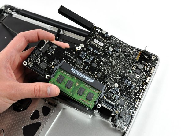

  13. MacBook Pro 13" Unibody Mid 2009 Teardown: step 13, image 1 of 2 MacBook Pro 13" Unibody Mid 2009 Teardown: step 13, image 2 of 2
    • Pop out the microphone from its cave.
    • The logic board is finally free!

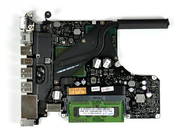

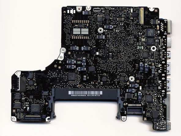

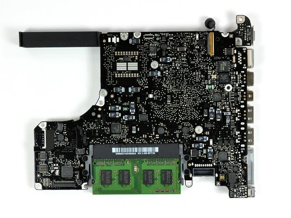

  14. MacBook Pro 13" Unibody Mid 2009 Teardown: step 14, image 1 of 2 MacBook Pro 13" Unibody Mid 2009 Teardown: step 14, image 2 of 2
    • A couple of images of the logic board, before we strip it naked...
    • Like the MacBook Unibody, the heat sink comes out along with the logic board.
  15. MacBook Pro 13" Unibody Mid 2009 Teardown: step 15, image 1 of 2 MacBook Pro 13" Unibody Mid 2009 Teardown: step 15, image 2 of 2

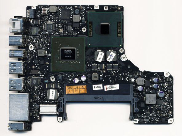

    • Both sides of the logic board.
