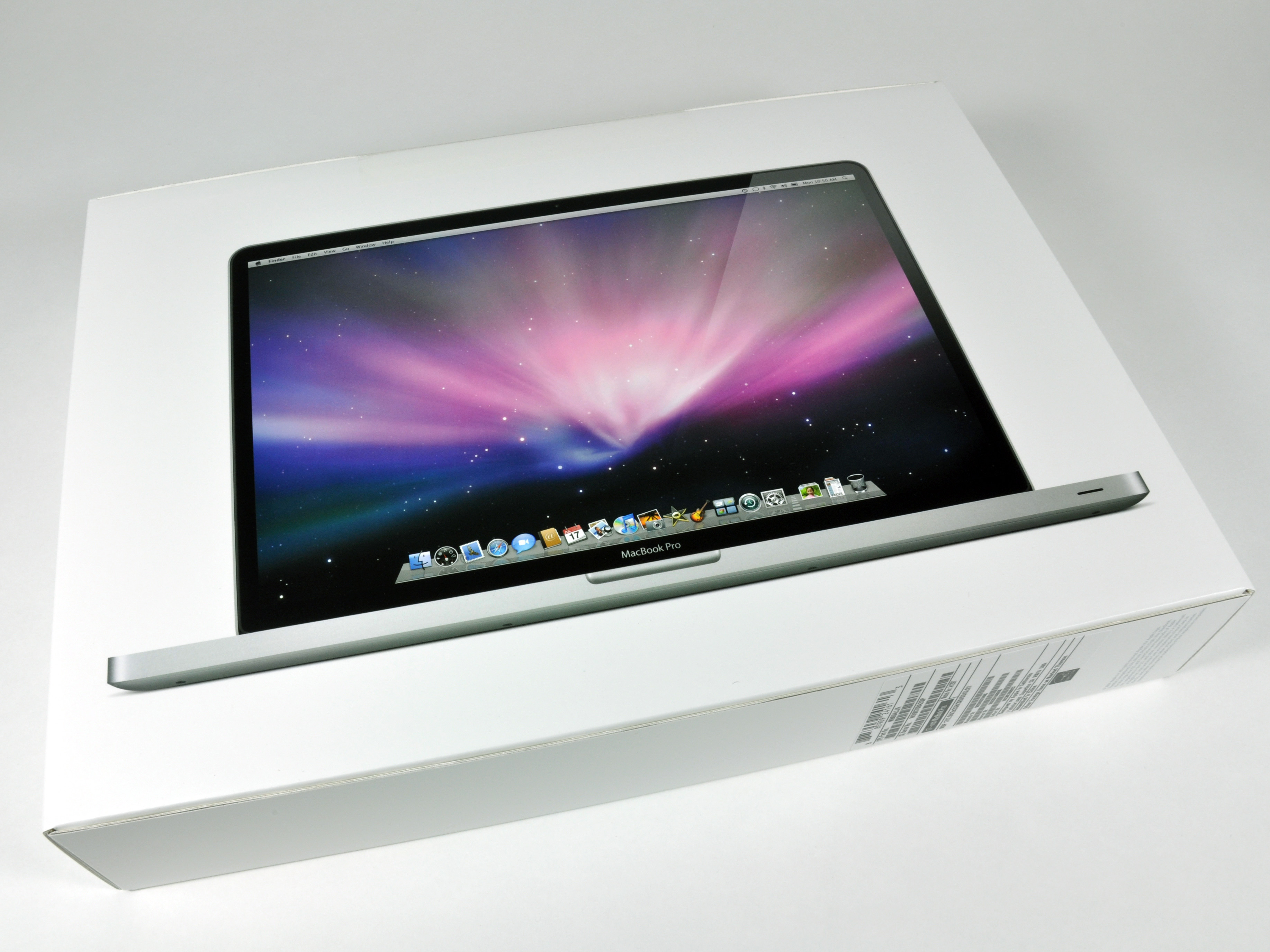

  1. MacBook Pro 17" Unibody Teardown, MacBook Pro 17" Unibody Teardown: step 1, image 1 of 3 MacBook Pro 17" Unibody Teardown, MacBook Pro 17" Unibody Teardown: step 1, image 2 of 3 MacBook Pro 17" Unibody Teardown, MacBook Pro 17" Unibody Teardown: step 1, image 3 of 3
    • We have it! Our patience has been severely tested by the month-long wait for this MacBook Pro 17".
    • We'll post updates on twitter about interesting things that we discover as we go. We'll also post interesting notes in our blog over the next few days.
    • Feel free to comment on specific steps as we go. If you have requests to see specific parts, we'll do our best to accommodate.
