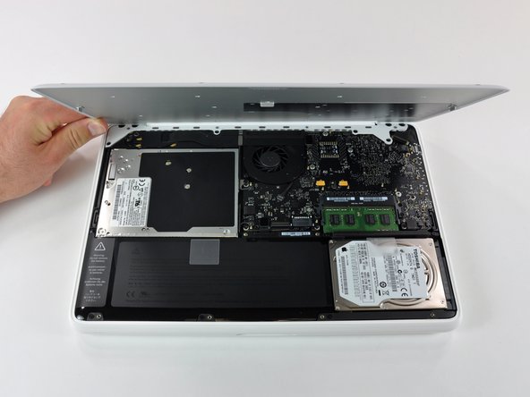

    • Much like its predecessor, the lower case is held by eight Phillips #00 screws.
  3. MacBook Unibody Model A1342 Mid 2010 Teardown: step 3, image 1 of 3 MacBook Unibody Model A1342 Mid 2010 Teardown: step 3, image 2 of 3 MacBook Unibody Model A1342 Mid 2010 Teardown: step 3, image 3 of 3

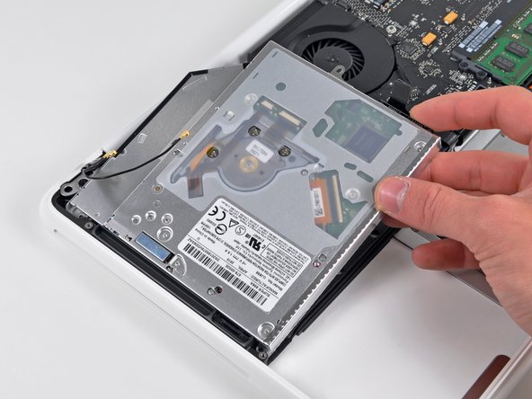

    • After removing the final few screws, lift the optical drive out of its comfy abode.
    • You'll be glad to know that MacBook Unibody Model A1342 Mid 2010 continues to use the 8x SATA superdrive manufactured by Panasonic, model UJ898.

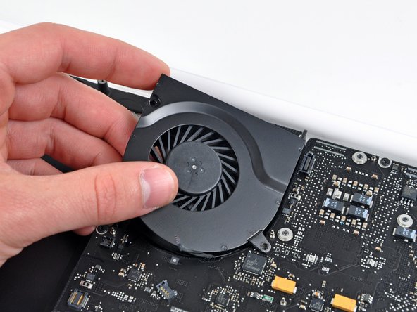

    • Removal of the fan was no biggie. It simply required a Phillips screwdriver and a spudger.

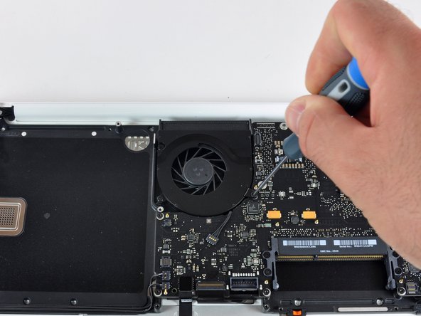

    • Obviously the logic board needs to come out, or else this isn't a teardown.
    • With the flick of our trusty spudger, we continue to disconnect several connectors around the perimeter of the logic board, as well as removing the RAM.
    • Carefully maneuver the logic board assembly out of the upper case.

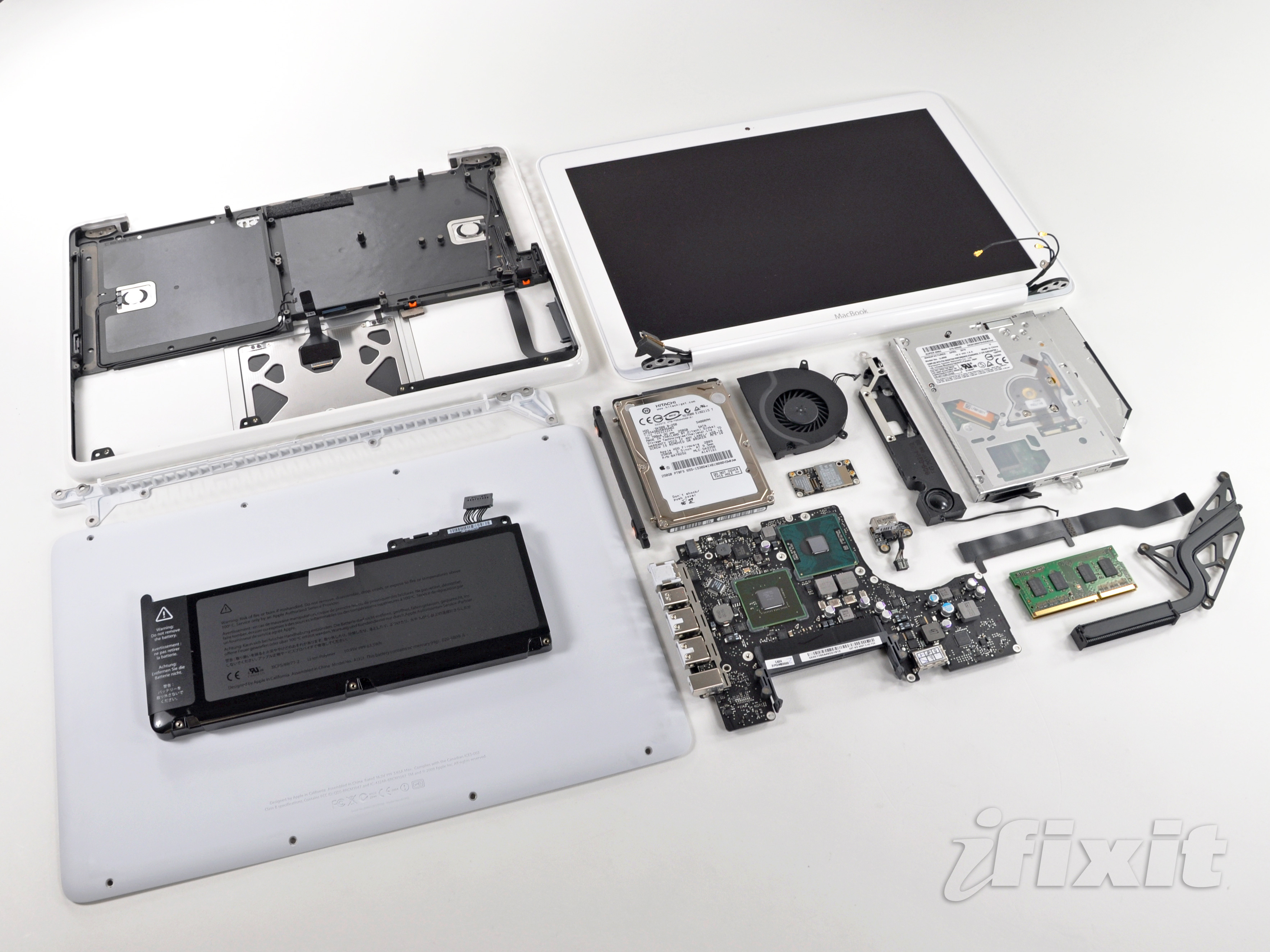

  14. MacBook Unibody Model A1342 Mid 2010 Teardown: step 14, image 1 of 1
    • Disclaimer: No MacBooks were hurt, in any way, shape, or form, during the process of this teardown.
    • Now that we've taken care of that legal mumbo jumbo that some people care about (most people don't), here is the final layout of what used to be a MacBook Unibody Model A1342 Mid 2010.
