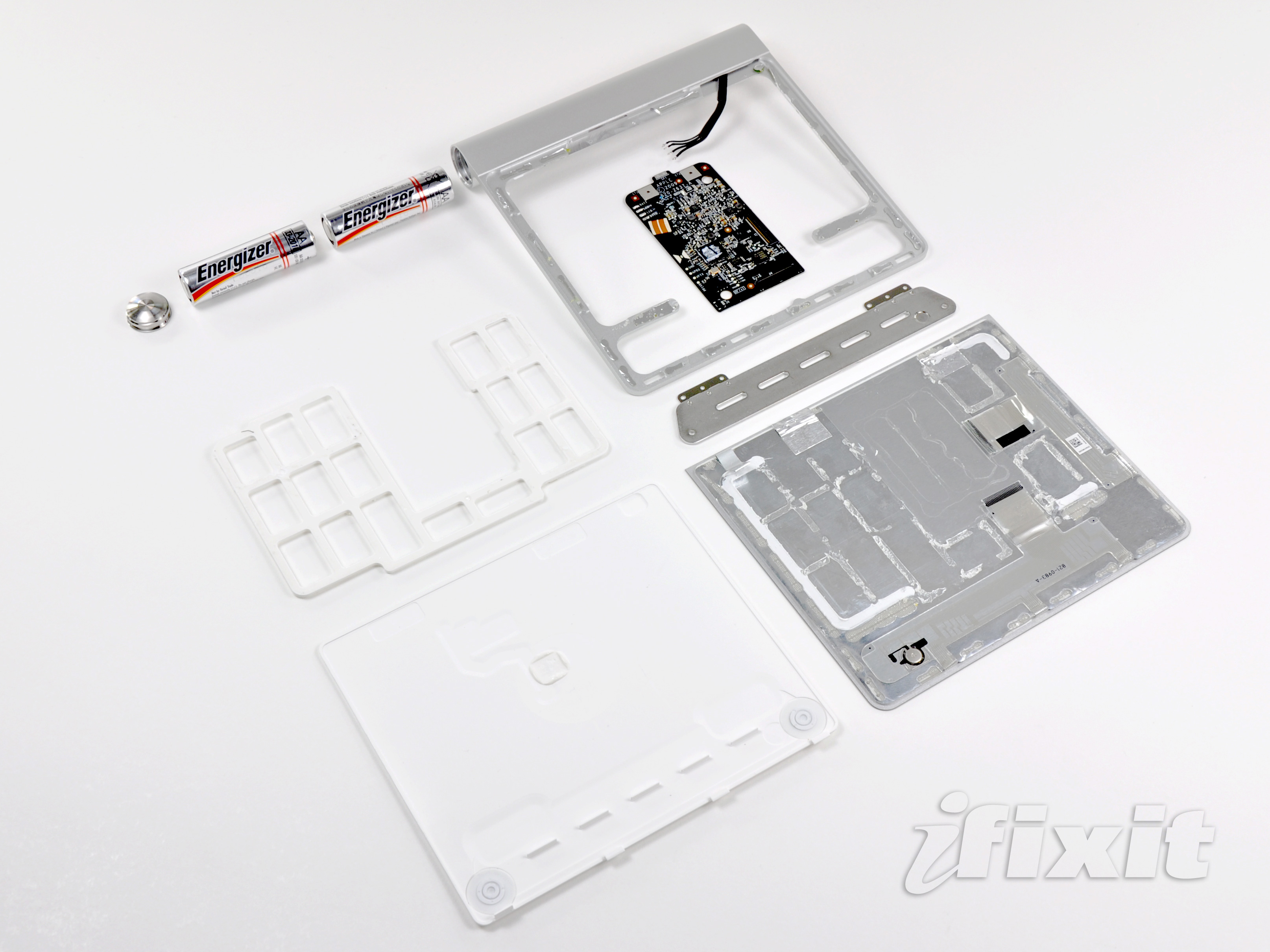

Removing the batteries is about as straightforward as it can get. Give a twist to the battery door and the two AA batteries slide right out.
Check out those square threads! While square threads have the highest mechanical efficiency of all lead screws, their difficulty of manufacturing makes them prohibitive for most applications.
Kudos, Apple, for sweating the details.
At the heart of the Magic Trackpad's logic board lies a Broadcom BCM2042 for Bluetooth connectivity.
We found a Broadcom BCM5974 touch screen controller chip that provides Multi-touch functionality.
Also, an SST 25WF020 provides 2 Mbit of serial flash memory.
This appears to be a TI CD3238, which has been identified by Hearst as a RS232 line driver/receiver. It was also in the original iPhone with a BCM5973A.
The back of the logic board features nothing but blackness and glue.

A great tear down. One question: Where is the bluetooth antenna? Is it just etched into the circuit board?
Good question. It looks like the curved traces along the top of the board seen on step 10 could be the antenna, and they lead to a small metal pressure contact that mates into the aluminum chassis. My guess is that the chassis of the trackpad and/or those curved traces serve as the antenna.
