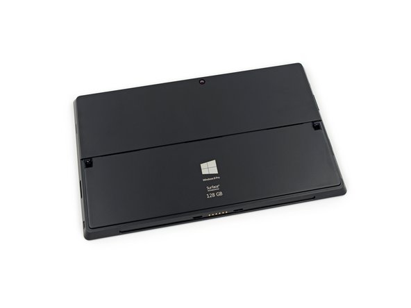

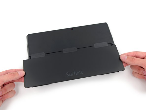

    • The Surface Pro 2 sports a 2-stage kickstand, with options for a 24 or 40-degree viewing angle.
    • Oh, how kickstands have progressed since we were kids
    • The kickstand is secured with two screws. Happily, our new Pro Tech Screwdriver Set includes the perfect T5 Torx driver to reach in and get this teardown started.
    • The kickstand comes off with little fuss, but if the previous model is any indication, repairability issues will soon begin to … show themselves.

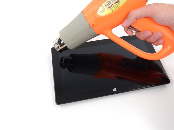

    • As pacifists, we prefer our trusty iOpener. But when pushed, we're not afraid to push back with the big (heat) guns.
    • Time to poke a plethora of picks under the now-molten adhesive. The use of oodles of dainty picks over brute force ensures our ribbon cables' protection.
    • Let the record show that you can fit at least 21 iFixit Opening Picks under the display of the Surface Pro 2.
    • We slowly but surely free the Surface Pro 2's display, trapped like a baby diplodocus in a treacherous tar pit of black adhesive.

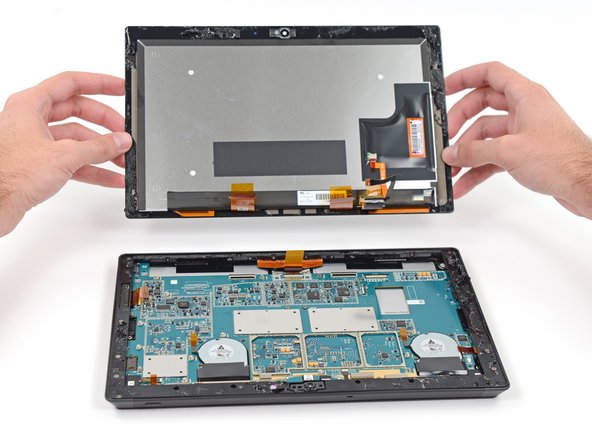

    • We flick aside four ribbon cables, and with that, this tablet's internals are revealed to the world.
    • At first glance things look eerily similar to last time, although the motherboard is a pretty new shade of ...blue? Green?
    • Before we can poke or prod any components, we'll first have to extract the dozens of screws holding this sucker together.
    • And whaddya know—it's the same 52 screws (of 3 different sizes) seen in the previous generation, holding in a plastic bezel and two metal brackets.
    • As much as we love screws, 52 seems like overkill, and we've only just scratched the...exterior of this device.

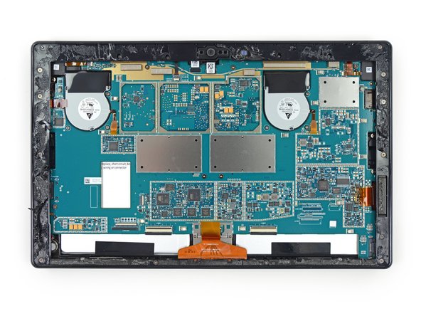

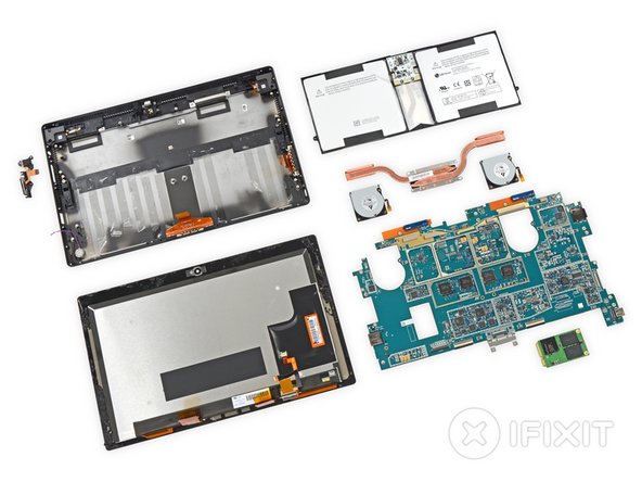

    • Finally, the motherboard is free and we can get at the fun stuff.
    • Changes to the cooling methods from the original Surface Pro are strictly software-based: the fans remain the same, but run less frequently to minimize power usage.
    • If you fancy a little copper with your tablet, the Surface Pro 2 has it: a notebook-worthy heat sink rounds out the cooling.

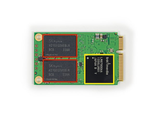

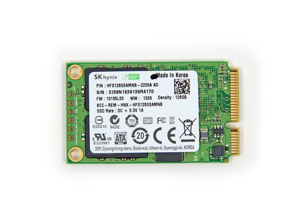

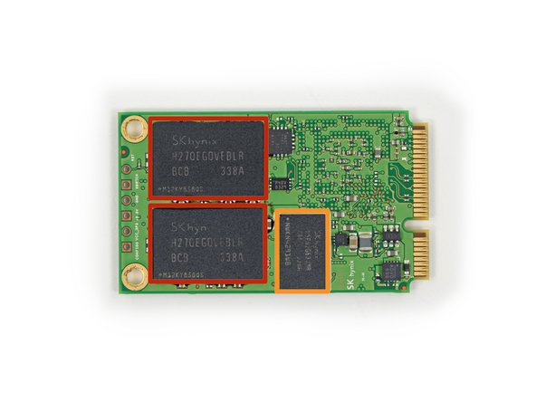

    • We've got storage! This time around, Microsoft shifts from a Micron/Marvell combination to one single IC manufacturer, SK Hynix.
    • SK Hynix HFS128G3AMNB 128 GB mSATA 6.0 Gbps SSD, using:
    • SK Hynix H27QEGDVEBLR 32 GB NAND Flash (four ICs for 128 GB total)
    • SK Hynix H5PS2G63JMR 32 MB DDR2 SDRAM
    • Link A Media LM87800AA SSD Controller

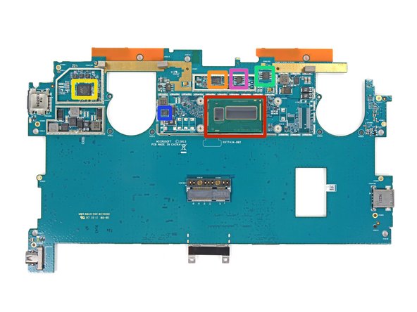

    • The ICs on the front side of the motherboard may look like little black squares on the (ahem) outside, but underneath they house some high-tech brainpower:
    • SK Hynix H9CCNNN8JTML 8 Gb (1 GB) LPDDR3 RAM (total of 4 * 1 GB = 4 GB)
    • Atmel MXT154E Touchscreen Controllers
    • Atmel UC256L3U 256KB Flash, 32-bit AVR Microcontroller
    • Winbond 25X40CL1G 4M-bit Serial Flash
    • Parade PS6625
    • Realtek ALC3230 Audio Codec
    • Atmel U1320J

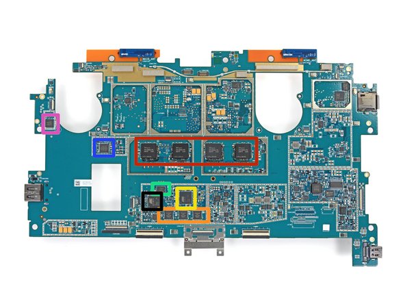

    • Yet more ICs adorn this side of the motherboard:
    • Realtek RTS5304
    • MXIC MX25L4006EZNI 4Mbit SPI (Serial Peripheral Interface) Flash
    • Novatek NT96132QG
    • Texas Instruments TPS5162 (ACTIVE) 2-Phase DCAP+ Step-Down Controller
    • ITE IT8528VG
    • Texas Instruments TPS51367 Integrated FET Converter with Ultra-Low Quiescent

    • The ICy party continues on the back side of the motherboard:
    • Intel Core i5-4200U Processor
    • Novatek NT96132QG
    • Marvell Avastar 88W8797 Integrated 2x2 WLAN/Bluetooth/FM Single-Chip SoC
    • Winbond 25Q128FVSQ Serial Flash presumably the next generation of the previous 25Q64FV
    • Winbond 25X05CL Serial Flash

    • Microsoft still adheres the battery to the rear case and still warns users not to remove it.
    • Pretty ironic, considering they clearly know their way around a user-friendly means of securing a battery—screws.
    • If you're looking for the secret of the Surface Pro 2's juiced-up battery life, look elsewhere: this is the exact same "Escalade" 42 Wh battery we saw earlier this year.
    • Instead, look to better power management and the Haswell i5 chip, which ensures that the tablet drinks in moderation.
    • The two battery cells are wrangled by a Texas Instruments BQ30Z55 cowpoke battery pack manager.
