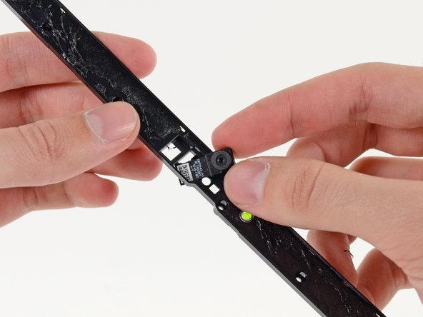

  8. Microsoft Surface Pro Teardown: step 8, image 1 of 2 Microsoft Surface Pro Teardown: step 8, image 2 of 2
    • With the gluey plastic bezel clear of the device, we gain access to the front-facing camera.
    • While this 720p HD "LifeCam with TrueColor" is nothing to write home about, it's on par with both the MacBook Air and iPad's front-facing cams.

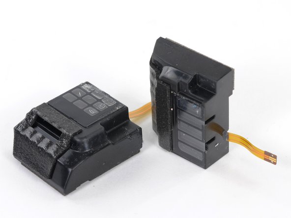

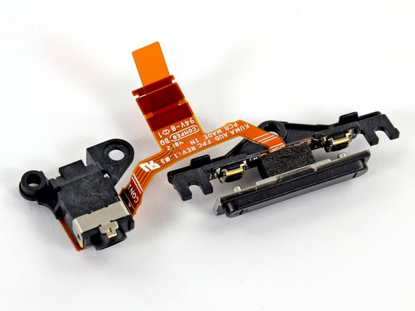

    • We use our ESD-safe tweezers to safely remove the volume buttons and headphone jack, which are tied together in a neat package by a ribbon cable.
    • So much for listening to the Pro's Grammy commercial.

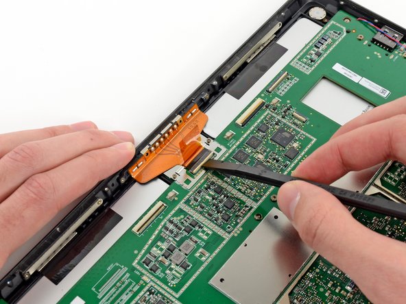

    • We've cracked the surface (figuratively speaking, of course—we would never damage a device…), but we continue digging deeper with our spudger and screwdriver until we can remove the motherboard assembly and the SSD.

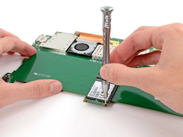

    • The Micron RealSSD C400 packs 64 GB of storage capacity. It can read 500MB/s and write 95 MB/s — all in a tiny 1.8" form factor.
    • Digging a little deeper, we find that a Marvell 88SS9174 SSD processor is keeping all those Micron flash ICs running smoothly.
    • PSA: The Windows 8 operating system chows down a fair chunk of the 64 GB total storage. After negating 30+ GB for the operating system, the full MS Office suite that you may not have even activated, as well as the factory restore image, the Surface Pro provides users with around 29 GB of usable space.
    • 128 GB-outfitted owners make do with 89 GB of free space. Ed Bott performed some tests comparing it to the 128 GB MacBook Air, which has 99.5 GB free space.

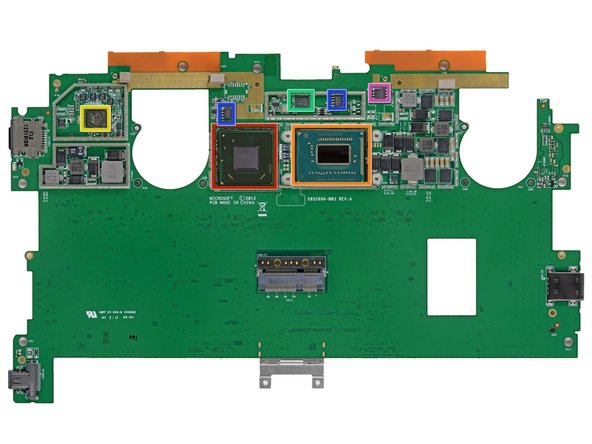

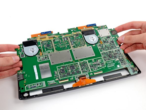

    • Checking out the top surface of the motherboard:
    • 8x Micron 2LEI2 D9PXV 4 Gb RAM for a total of 4 GB RAM
    • Integrated Technology Express IT8519G
    • Atmel UC256l3U 256KB Flash, 32-bit AVR Microcontroller
    • ON NCP6132A 3 Phase Controller
    • Atmel MXT1386E Touchscreen Controller
    • 3x Atmel MXT154E Touchscreen Controllers (the same controllers we found in the Surface RT)
    • Realtek ALC3230 Audio Codec
  15. Microsoft Surface Pro Teardown: step 15, image 1 of 1
    • And tucked underneath, on the bottom:
    • Intel Mobile HM77 Express Chipset
    • Intel Core i5-3317U Processor
    • Marvell Avastar 88W8797 Wireless/Bluetooth/FM Radio Controller
    • Novatek NT96132QG46
    • 2x Winbond 25X05CL Serial Flash
    • Winbond 25Q64FV Serial Flash

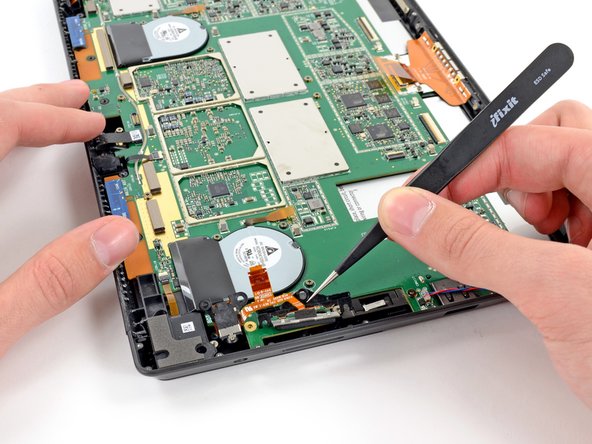

  16. Microsoft Surface Pro Teardown: step 16, image 1 of 3 Microsoft Surface Pro Teardown: step 16, image 2 of 3 Microsoft Surface Pro Teardown: step 16, image 3 of 3
    • A few more flicks of the spudger and out come the stereo speakers.
    • Next up is the keyboard dock connector. The same type of port is used in both the Pro and non-Pro versions of the Surface, allowing the Type Cover keyboard to be cross-compatible.

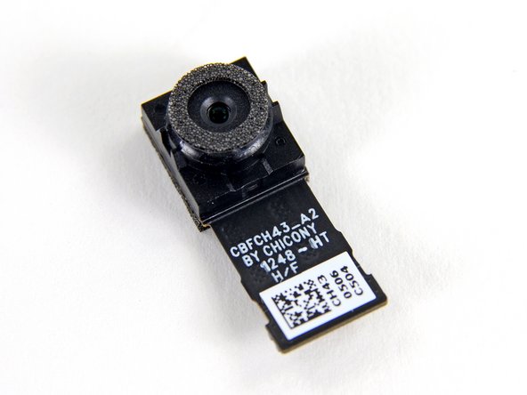

  17. Microsoft Surface Pro Teardown: step 17, image 1 of 3 Microsoft Surface Pro Teardown: step 17, image 2 of 3 Microsoft Surface Pro Teardown: step 17, image 3 of 3
    • More parts fly out of the Pro including the power connector and rear-facing camera.
    • The rear camera resolution is the same 720P as the front, so the Surface Pro may not be the best replacement for your Nikon D600 SLR.

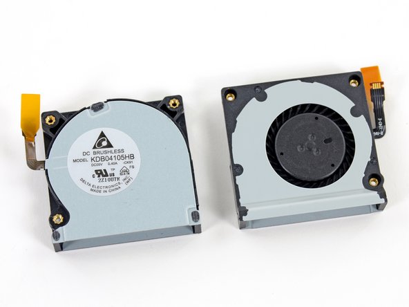

    • The plastic top-rear bezel also doubles as a vent for the Pro's laptop-worthy hardware.
    • Two ports through the bezel act as venting ducts for the fans, directing hot air out the top. It appears that the Pro's fans draw ambient air in through the many vent holes spaced around the perimeter, then force that air over the heat sink's two radiators and out of the device, cooling the CPU and GPU.

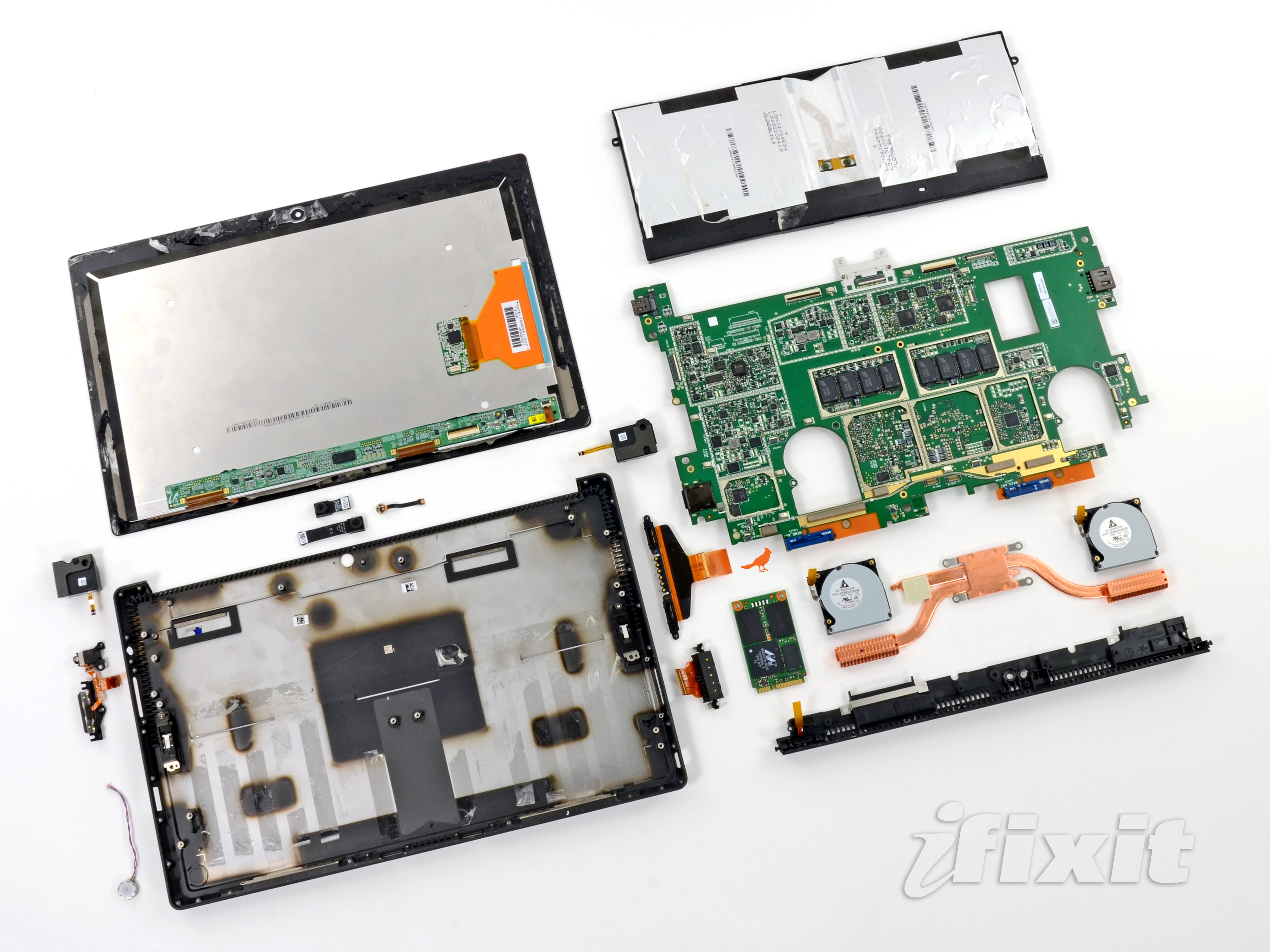

    • Microsoft Surface Pro Repairability Score: 1 out of 10 (10 is easiest to repair)
    • The battery is not soldered to the motherboard, so at least no soldering is required to replace it.
    • The SSD is removable — but you risk killing your tablet by trying to open it.
    • There are over 90 screws inside this device. We're proponents of mechanical fasteners, but this number is a tad crazy.
    • The display assembly (comprising of a fused glass and LCD) is extremely difficult to remove/replace.
    • Tons of adhesive hold everything in place, including the display and battery.
    • Unless you perform the opening procedure 100% correctly, chances are you'll shear one of the four cables surrounding the display perimeter.
