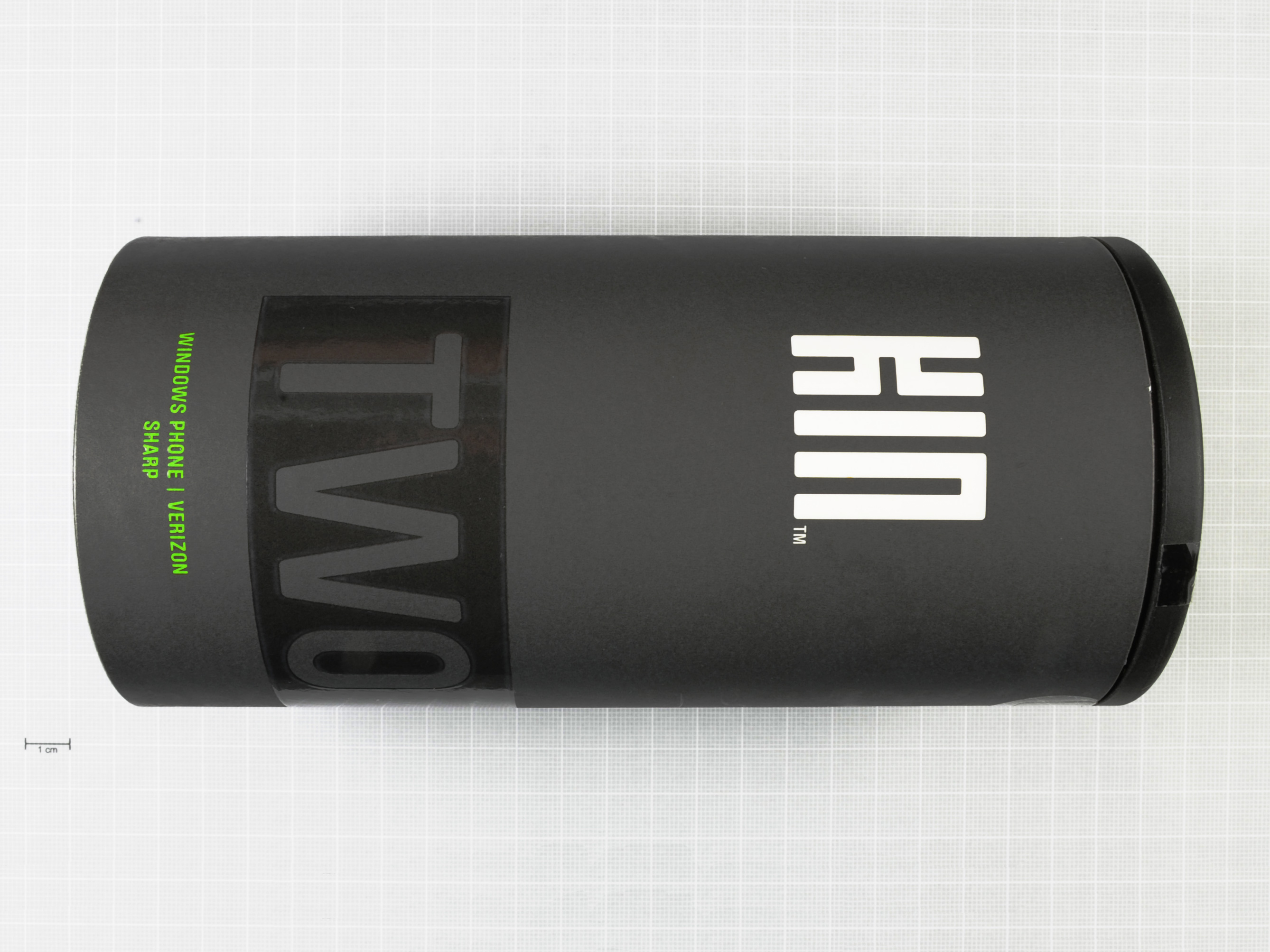

This teardown is not a repair guide. To repair your Microsoft Kin Two, use our service manual.
  1. Microsoft Kin Two Teardown, Microsoft Kin Two Teardown: step 1, image 1 of 3 Microsoft Kin Two Teardown, Microsoft Kin Two Teardown: step 1, image 2 of 3 Microsoft Kin Two Teardown, Microsoft Kin Two Teardown: step 1, image 3 of 3
    • Photos courtesy of Chipworks.
    • The Kins are Microsoft's first foray into cellphones. As noted on the back of the Kin Two, they're very sharp Verizon phones, ones that have windows on them.
    • We call shenanigans. They weren't sharp at all, nor were any windows to be found. Silly Microsoft.
