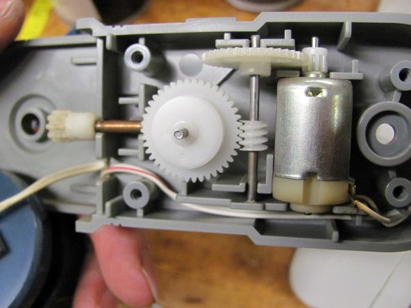

    • Open up the remote control.

    • Remove the screw as indicated.

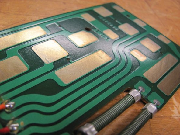

  3. Mobile Armatron Teardown: step 3, image 1 of 2 Mobile Armatron Teardown: step 3, image 2 of 2
    • If someone spilled soda or apple juice over the controller it may be helpful to clean the board using contact cleaner.

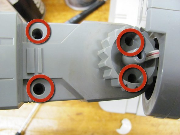

  4. Mobile Armatron Teardown: step 4, image 1 of 1

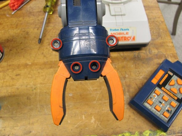

    • Remove screws where indicated.

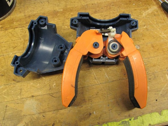

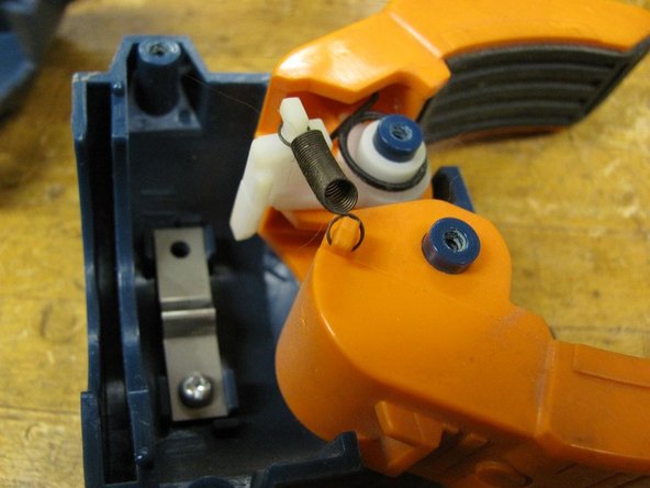

  5. Mobile Armatron Teardown: step 5, image 1 of 3 Mobile Armatron Teardown: step 5, image 2 of 3 Mobile Armatron Teardown: step 5, image 3 of 3

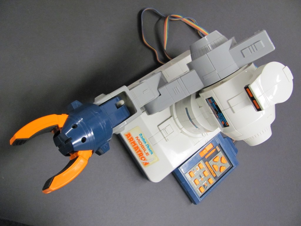

    • Gripper components can be removed for further disassembly.

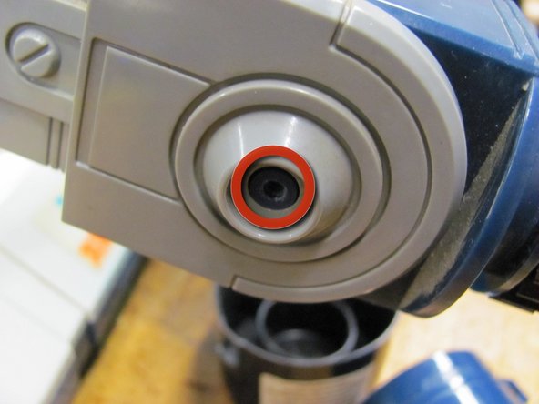

  6. Mobile Armatron Teardown: step 6, image 1 of 3 Mobile Armatron Teardown: step 6, image 2 of 3 Mobile Armatron Teardown: step 6, image 3 of 3

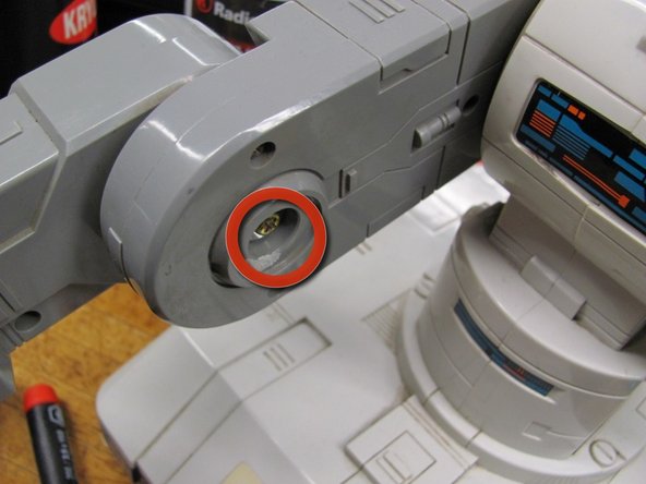

    • Use the knife to peel off stickers that conceal the screw holes.

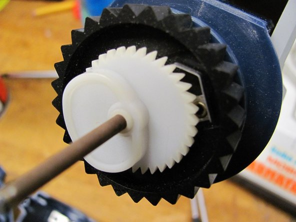

  7. Mobile Armatron Teardown: step 7, image 1 of 3 Mobile Armatron Teardown: step 7, image 2 of 3 Mobile Armatron Teardown: step 7, image 3 of 3

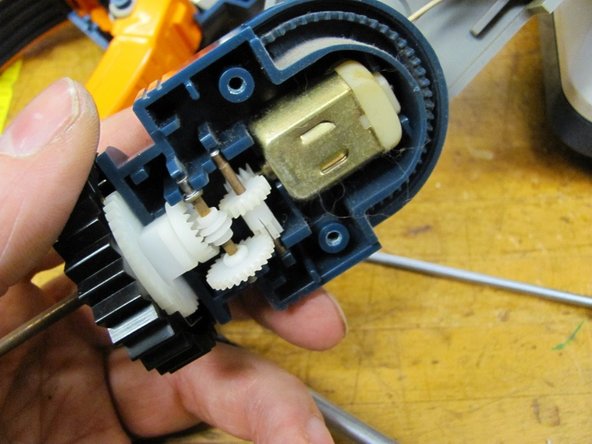

    • More screws can be removed to check the condition of gear teeth.
    • Admire the mechanical design.

The motor is actually in the base
