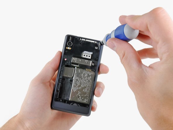

    • Every screw holding the Droid 2 together is cleverly hidden behind the many covers stuck to the rear of the device.

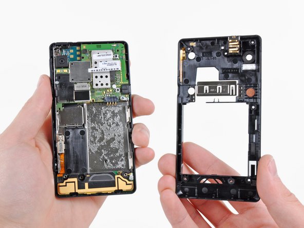

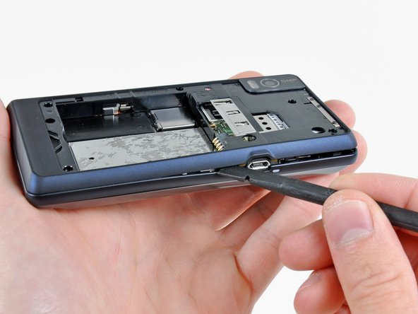

    • A screw here, a screw there, and we're almost in!
    • After prying the rear case off, we finally get to see what makes the Droid 2 tick.

    • Five pressure contacts on the headphone jack press against the gold pads attached to the camera board to exchange data.

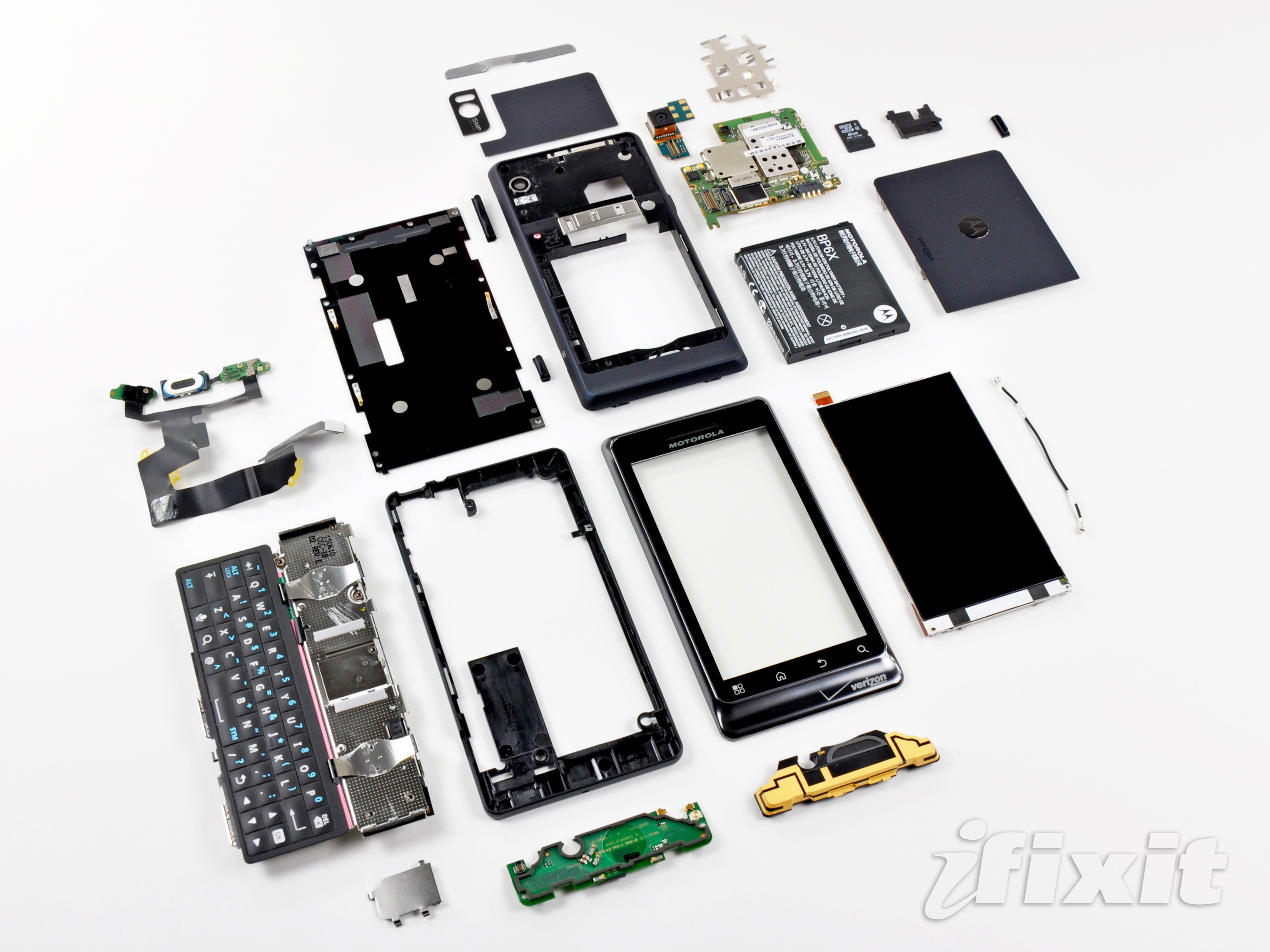

    • Are you wondering if the Droid 2 has the capability to reassemble itself? So are we...in the meantime, here's a before snapshot of all the components. As soon as the Droid 2 reassembles itself, we'll have the after shot.
    • Thanks for joining us today during this exciting teardown.
