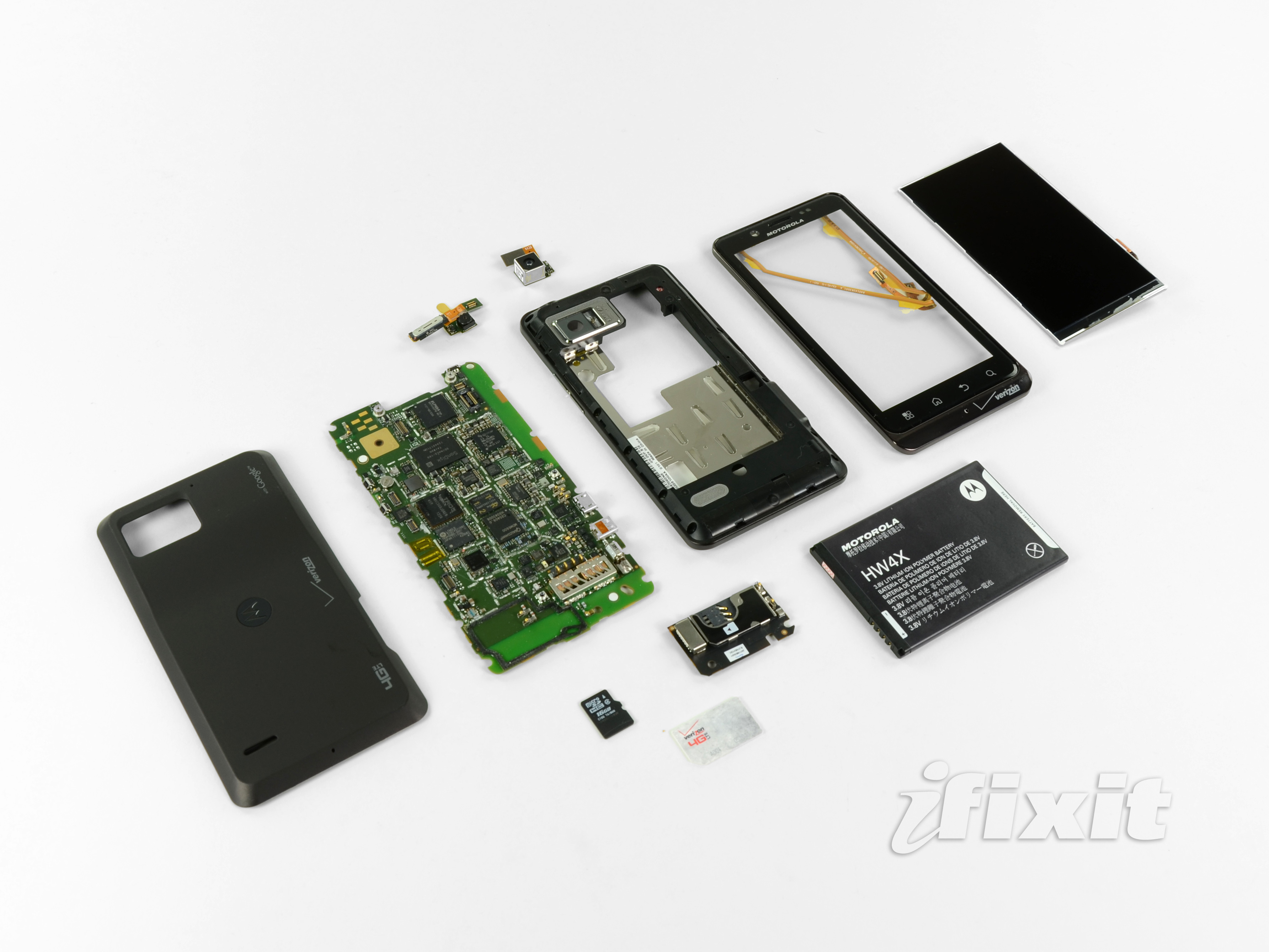

    • After nearly 8 months since its revealing at CES 2011, the Droid Bionic is finally here! And it's packing some serious hardware:
    • 1 GHz Texas Instruments Dual-Core Processor
    • 32 GB storage capacity (16 GB internal, 16 GB external)
    • 1 GB RAM
    • 4.3" qHD Display with Corning Gorilla Glass
    • 8 MP (1080p HD) Rear-Facing Camera
    • Verizon 4G LTE Network Capability

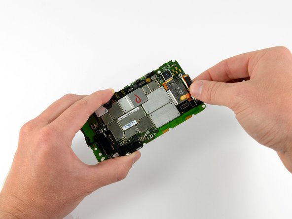

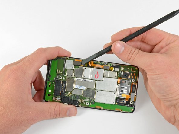

    • We remove the rear case and are instantly greeted by a forest of EMI shields.
    • We remove the loudspeaker from the otherwise unexciting rear case, a speaker ideal for proclaiming the characteristic Drooooooiiiiid upon powering on the phone.

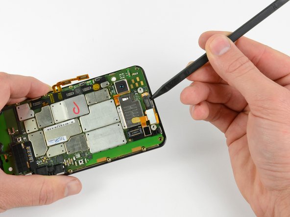

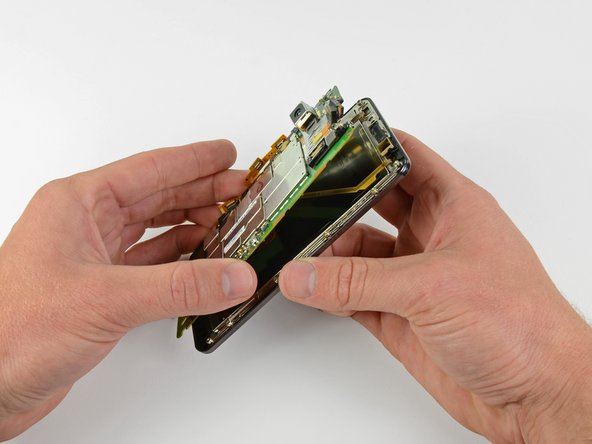

    • The display ribbon cable connector is in the way. Let's find a way to remove it.
    • We continue our quest of ridding the Bionic of its connectors with the help of our trusty spudger.
    • With stickers unstuck, screws unscrewed, and connectors disconnected, we lift the motherboard away from the display assembly.

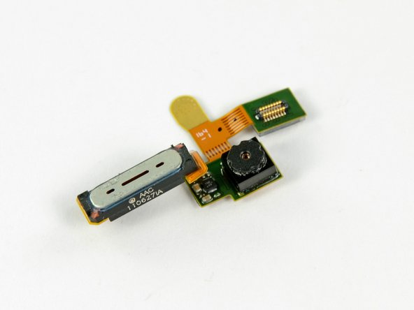

    • First thing off the motherboard: the front-facing camera/ear speaker assembly.
    • We're relieved to see that Motorola isn't using the same long ribbon cables found in some of their other devices.
    • Although Motorola/Verizon never divulged the exact megapixel count of the front-facing camera, its "VGA" quality suggests it to be 0.3MP.

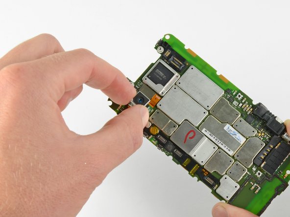

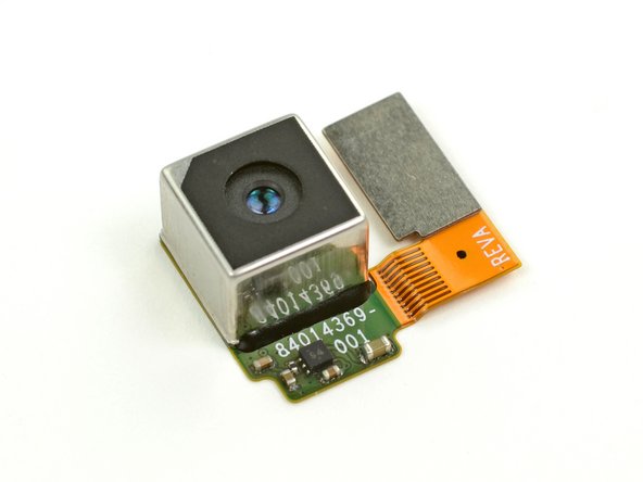

    • The rear-facing camera simply pops out. Inscription on the component is this wonderful gem: "NCAABA 65161 0100698 2001 SH."
    • The Bionic sports an 8 MP camera capable of capturing video at a resolution of 1920 x 1080 (1080p) along with a dual-LED flash.
    • The camera measures in at 7.1 mm x 9.3 mm (length x width) and weighs an astonishing 1.2 grams!
    • Much like the Droid X and Droid X2, the large camera seems to be the main reason behind the "hump" at the top of the phone.

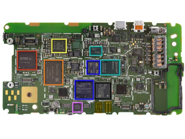

    • After some slash-and-burn on the EMI shield forest, we found the big players on the motherboard:
    • Elpida B8064B2PB-8D-F 1 GB DRAM and TI OMAP 4430 processor
    • SanDisk SDIN4C2-16G 16GB Flash memory
    • ST Ericsson CPCAP 006556001
    • The Qualcomm PM8028 power management chip works in conjunction with the Qualcomm MDM6600 to provide CDMA connectivity.
    • Hynix H8KCS0SJ0AER and Hynix H8BCS0QG0MMR memory MCP containing Hynix DRAM and STM flash
    • ATMEL MXT224E-CCU Touchscreen Controller
    • Motorola T6VP0XBG-0001, believed to be the (LCM 2.0) LTE baseband processor.

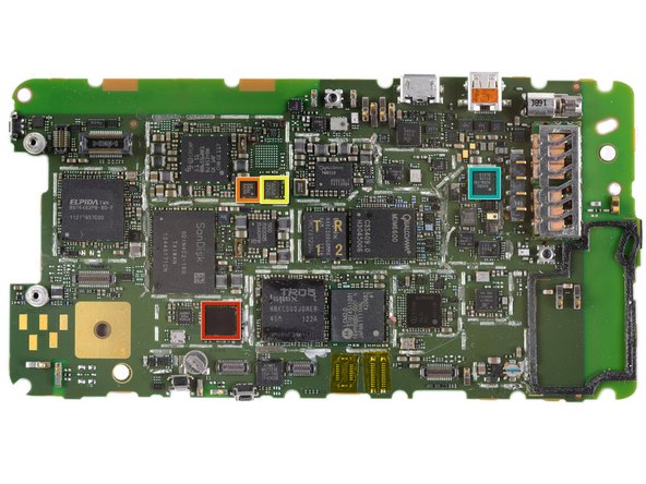

    • There's tons of chips on the front of the board. Other chips of interest include:
    • Texas Instruments WL1271 chip that supports WiFi (802.11 b/g/n), Bluetooth 2.1, FM and GPS technologies (thanks Chipworks!)
    • Kionix KXTF9 accelerometer
    • ST Micro AGD8 2040 S6NBF gyroscope
    • Avago ACPM-7868 quad-band power amplifier

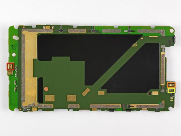

    • What's this? Did we use Content Aware to remove all of the chips from the back of the motherboard? The answer is no; there just isn't much going on with the backside of the board.
    • We find a microphone (red), proximity sensor (orange), ambient light sensor (yellow) on the back.
    • It is possible that Motorola placed all of the chips on one side of the board to keep the thickness of the device to a minimum.

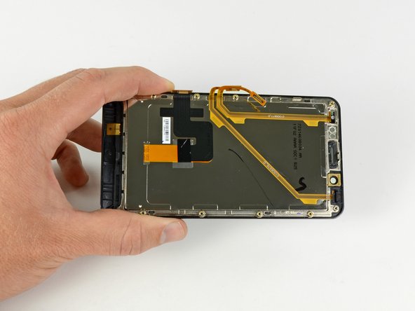

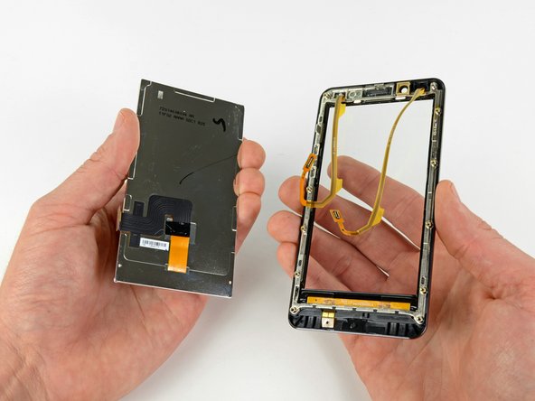

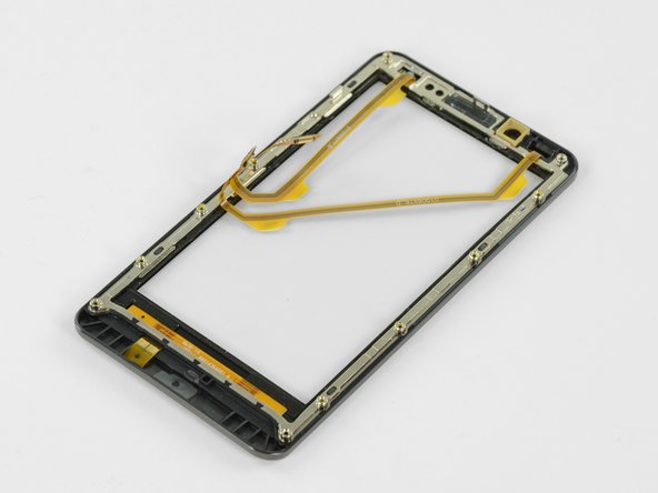

    • Hello there, display assembly. It's time for your monthly checkup.
    • A little turn, a push, and a pop and the LCD is free.
    • The Gorilla Glass front panel houses the capacitive touch Android function buttons and the status LED.
  15. Motorola Droid Bionic Teardown: step 15, image 1 of 1

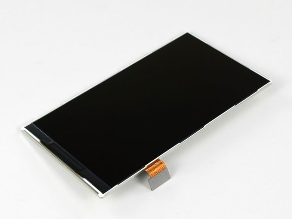

    • The Bionic features a 4.3-inch 960x540 pixel qHD LCD, the same size found in the Droid X2.
    • The qHD display originally appeared in the Motorola Atrix earlier this year, and we've seen one in every Motorola Android phone since.

    • Motorola Droid Bionic Repairability Score: 9 out of 10 (10 is easiest to repair).
    • No tools are necessary for changing the SIM and microSD cards.
    • The battery can be removed in seconds.
    • The phone is held together with a limited number of screws and plastic clips. Adhesive is minimally used in its construction.
    • Many components can be replaced individually, and are not located on large, delicate ribbon cables.
    • The LCD is separable from the glass front panel, making them independently replaceable.
    • You must disassemble the entire phone to replace the LCD or front panel.
    • Replacing the rear-facing camera requires removing one of the motherboard's EMI shields.
