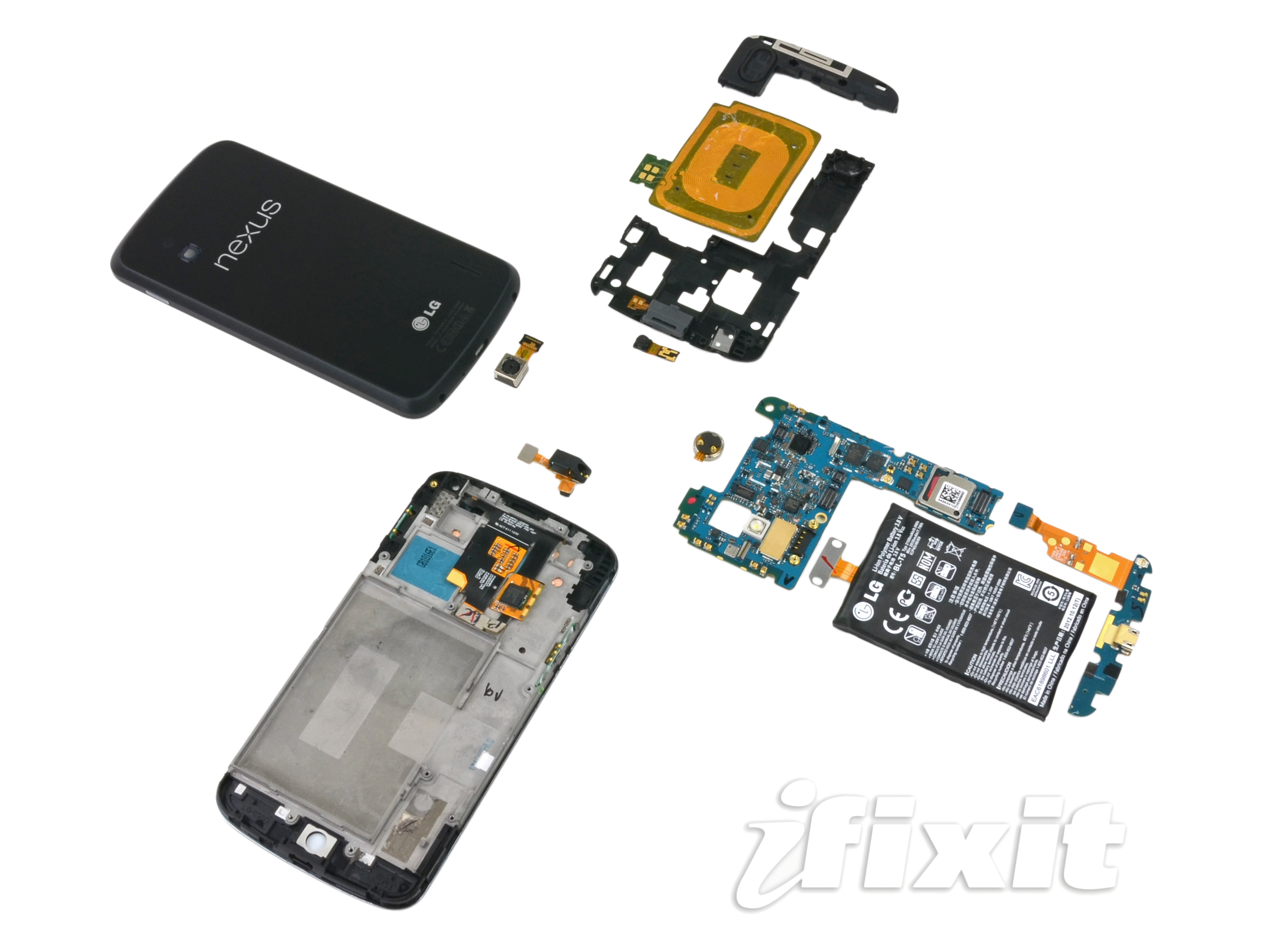

    • After liberating the two T5 Torx screws from their imprisonment, it took a few minutes of diligent work with a plastic opening tool to remove the back cover.
    • It wasn't particularly difficult to open this device, but anyone attempting it without the proper prying tool will face a lot of frustration.
    • Right off the bat we notice that the battery is much harder to replace than in the earlier Galaxy Nexus. This could hurt its repairability score, but it's still early!

    • Screws hold the battery connector in place.
    • We make it look easy, but the battery is secured to the case with quite a bit of adhesive, requiring a lot of prying.
  10. Nexus 4 Teardown: step 10, image 1 of 2 Nexus 4 Teardown: step 10, image 2 of 2
    • Eventually, we're able to pull out the 3.8 V, 2100 mAh battery.
    • Just like Apple did with the iPhone 5, LG is utilizing a 3.8 V battery to power the Nexus 4.
    • Unlike Apple, however, LG manufactures their own battery.
    • Strangely enough, Google doesn't list any specifications for the battery on their product page. We'll have to rely on real-world tests to see what kind of battery life users can expect to achieve.

    • Next up is the obtrusive plastic frame covering the motherboard.
    • With the frame screws removed, the Nexus 4 is officially screw-less. That brings us to a total of only 4 different screw lengths, and 15 screws in total. Here's how they break down on our Magnetic Project Mat.

    • Removing the motherboard requires disconnecting a few connectors.
    • Overall, the process was pretty painless and required minimal effort.

    • The front of the motherboard :
    • Toshiba THGBM5G6A2JBAIR 8GB Flash
    • SlimPort ANX7808 SlimPort Transmitter (HDMI output converter)
    • Invensense MPU-6050 Six-Axis (Gyro + Accelerometer)
    • Qualcomm WTR1605L Seven-Band 4G LTE chip
    • Avago ACPM-7251 Quad-Band GSM/EDGE and Dual-Band UMTS Power Amplifier
    • Murata SS2908001 802.11 a/b/g/n Wi‐Fi and Bluetooth module
    • Avago 3012 Ultra Low-Noise GNSS Front-End Module
  18. Nexus 4 Teardown: step 18, image 1 of 1
    • Back o' mobo:
    • Samsung K3PE0E00A 2GB RAM. We suspect the Snapdragon S4 Pro (APQ8064) 1.5 GHz CPU lies underneath.
    • Qualcomm MDM9215M 4G GSM/UMTS/LTE modem
    • Qualcomm PM8921 Power Management
    • Broadcom 20793S NFC Controller
    • Avago A5702, A5704, A5505
    • Qualcomm WCD9310 audio codec
    • Qualcomm PM8821 Power Management

    • A quick flick of the spudger and we free the daughterboard.
    • The daughterboard is home to the micro-USB port, several spring contacts for the speakers, a hidden unidentified antenna socket, and a microphone (located on the underside.)

    • Front panel—fused LCD, glass, and frame.
    • A Synaptics S7020A touchscreen controller ensures your fingers morph into super-accurate pig-killing machines.
    • The 4.7", 1280 x 768 , WXGA IPS display is manufactured by LG Display.
    • The display is labeled as LH467WX1.
  22. Nexus 4 Teardown: step 22, image 1 of 2 Nexus 4 Teardown: step 22, image 2 of 2
    • Nexus 4 Repairability Score: 7 out of 10 (10 is easiest to repair).
    • Removing the back cover requires nothing more than a common screwdriver, a plastic opening tool, and some patience.
    • The entire device only contains four different length screws—all common screw types—for a total of only 15 screws.
    • Once the back cover and inner frame are removed, pressure contacts make all of the inner components a breeze to replace.
    • The battery is stuck to the frame with a lot of adhesive, so removing it without puncturing the battery can be difficult.
    • The glass is fused to both the display and the display frame. So don't crack the glass unless you're good with a heat gun, or you're fond of replacing the glass, display, and frame together ($$$).
