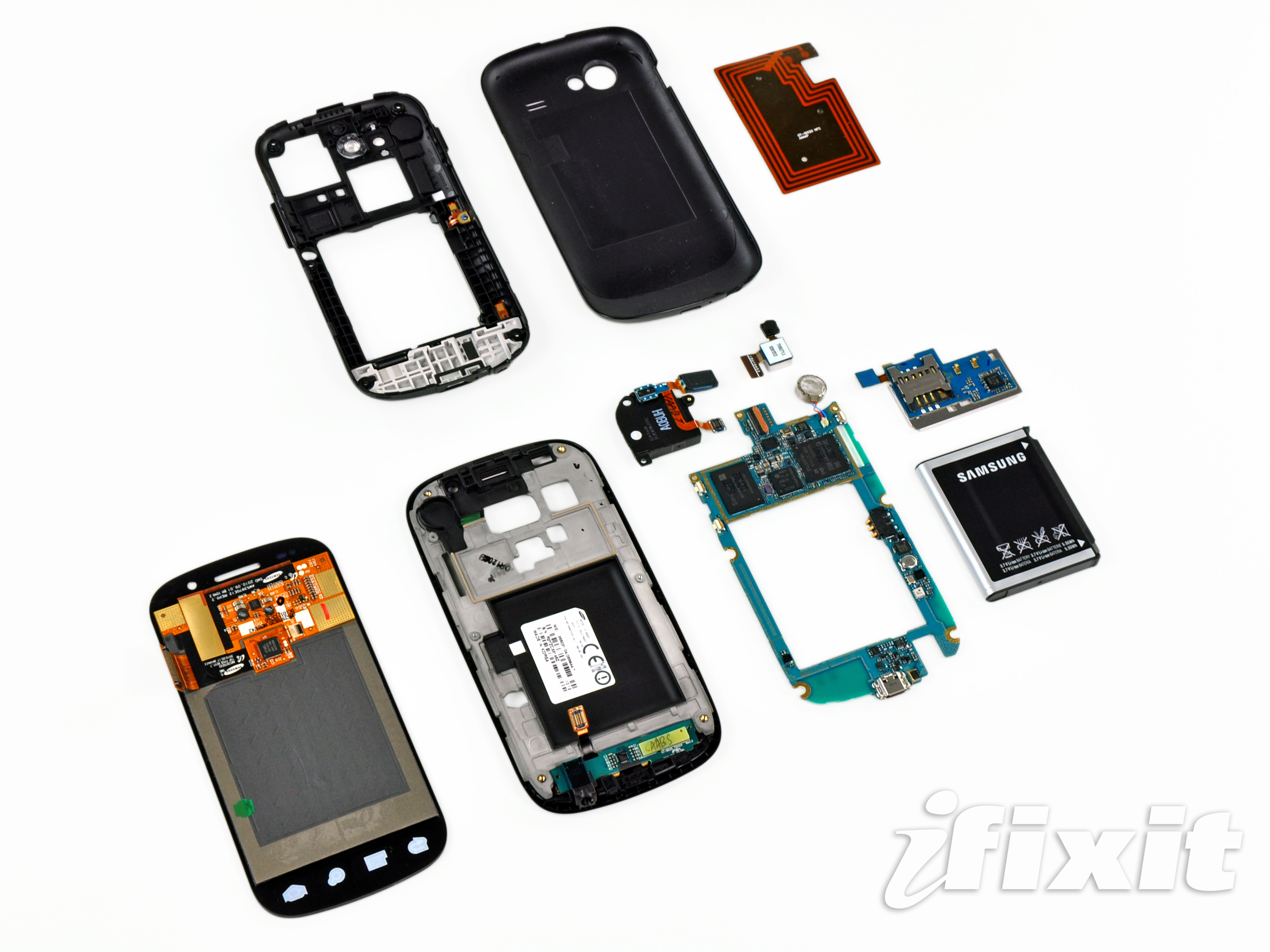

    • Without any further ado, let's start tearing this phone apart!
    • The entire back cover comes right off without a fuss, giving us a first glimpse of the battery.

    • After removing six screws with our trusty Phillips #00 screwdriver, a little prying with a plastic opening tool lets us remove the inner case.
  6. Nexus S Teardown: step 6, image 1 of 2 Nexus S Teardown: step 6, image 2 of 2
    • Taking out the motherboard requires removing three Phillips screws and disconnecting a few cables here and there.
    • The design of the motherboard is peculiar to us. It is designed such that its inner perimeter encloses the battery. We've seen oddly-shaped PCBs before, but rarely do they have giant holes in the middle of them.

  9. Nexus S Teardown: step 9, image 1 of 2 Nexus S Teardown: step 9, image 2 of 2
    • The EM-Tech EME1511AFRC integrates the earpiece speaker, loudspeaker for speakerphone and media use, and a sensor bank all into one unit with a singular shared data connector.
    • This is definitely a win for integration, but at the same time forces users to replace the entire unit if only one component malfunctions.

  12. Nexus S Teardown: step 12, image 1 of 2 Nexus S Teardown: step 12, image 2 of 2
    • Removing the display presented us with the first stumbling block in our disassembly. A heat gun made quick work of the front case assembly, though.

  14. Nexus S Teardown: step 14, image 1 of 2 Nexus S Teardown: step 14, image 2 of 2
    • Nexus S Repairability Score: 7 out of 10 (10 is easiest to repair)
    • Battery is very easily replaceable -- just remove the back cover to swap it out.
    • The motherboard comes out easily once you're inside, as it's held in place by regular screws and connectors.
    • A lot of the phone's components are modular, meaning that they're simpler to replace, but will cost more as replacement parts.
    • Front panel is attached with adhesive instead of screws, so it's harder to take off than on the iPhone.
    • If you shatter the front panel glass, the SAMOLED has to be replaced as well -- they're fused together.
