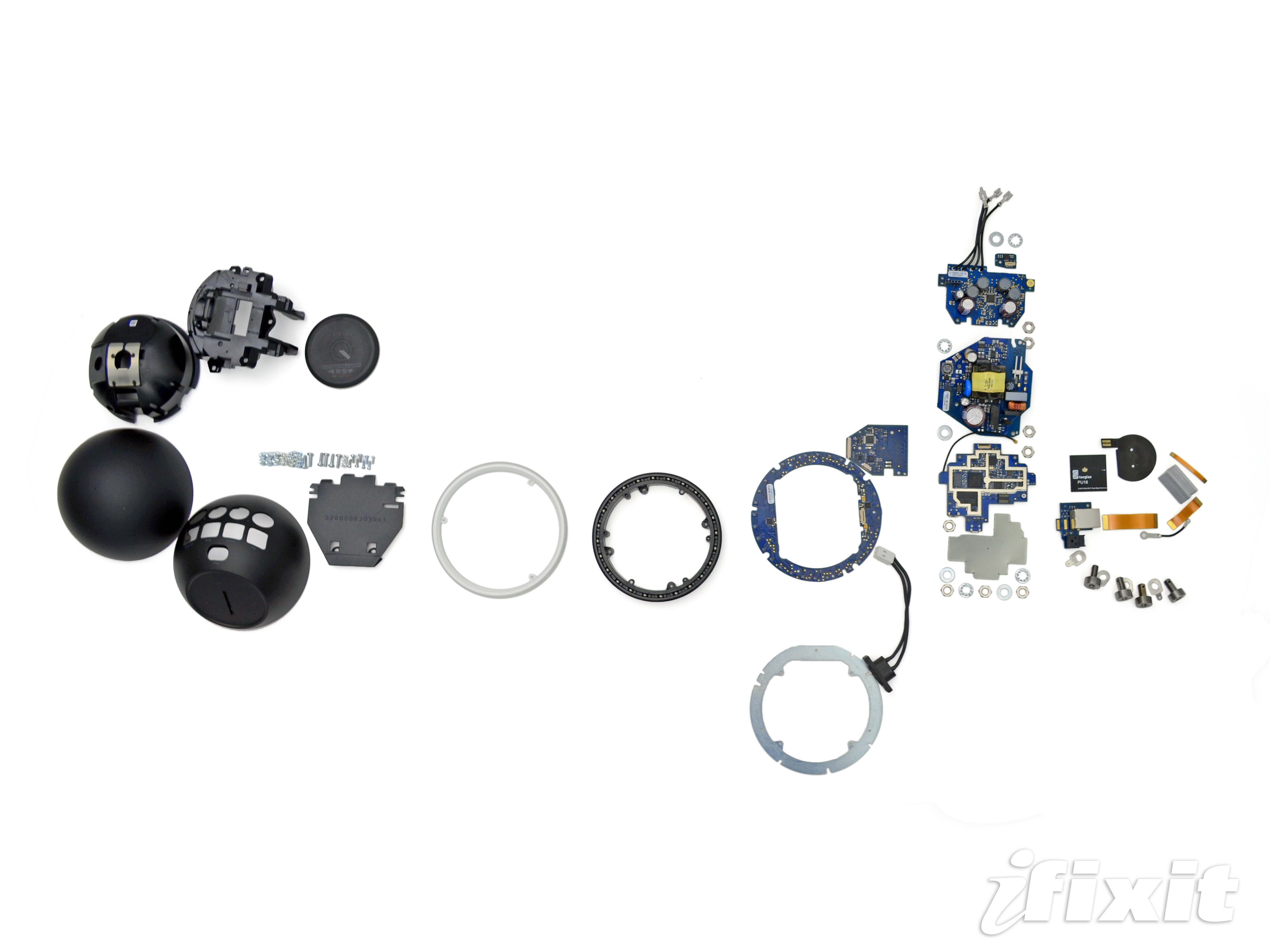

    • It is safe to say that we have never before torn down a device with more circular parts than this. Out comes another one.
    • What at first looks like no more than a plastic bezel turns out to be the diffuser for the Q's perimeter LEDs.
  14. Nexus Q Teardown: step 14, image 1 of 3 Nexus Q Teardown: step 14, image 2 of 3 Nexus Q Teardown: step 14, image 3 of 3
    • Cue the lights! With the diffuser out, we gain access to the LED board. The perimeter of the Q is lined with 32 RGB LEDs, enabling it to put on one heck of a light show.
    • The board also houses two Texas Instruments TLC5947 24-channel, 12-bit PWM LED drivers with internal oscillators, which could've been made in one of several locations in the world.
    • And the rings continue to appear. Could this be the last of them? Only time will tell…

    • Click. Creek. Phwiiip! With a couple typical teardown noises, the rest of the Q's internals are evac-Q-ated.

    • The folks at Google decided to take a cue from us, so we felt the need to reciprocate. Googlers, consider this an outstanding invitation to use the image on the left as a Google Doodle!
    • Nexus Q Repairability Score: 8 out of 10 (10 is the easiest to repair):
    • Removing the top cover requires no tools. Very limited amounts of adhesive and fasteners with no exotic screw heads simplify disassembly.
    • Very few components are soldered to the main boards, making replacing them easier and less expensive.
    • The entire disassembly is pretty straightforward.
    • Lots of components could make you lose track of important parts if you're not careful.
    • Everything is packed very tightly into one package, which makes replacing some components a tad difficult.
    • The power supply is readily exposed once inside, making repairing the device a bit dangerous unless proper caution is taken.
