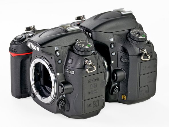

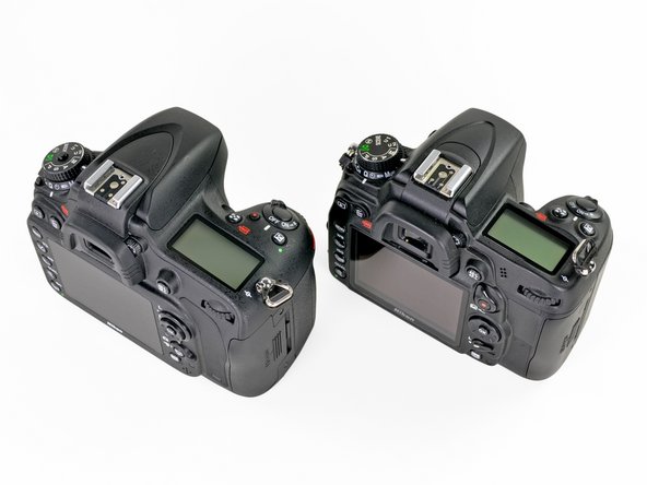

If you're used to wielding a Nikon D7000, holding a D600 may start to feel like déjà vu. Let's compare the two and see how similar they really are.

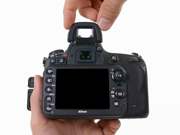

Even without the different exterior markings, distinguishing the D600 from the D7000 is pretty easy once the body cap is removed, exposing the comparatively gigantic viewfinder mirror.

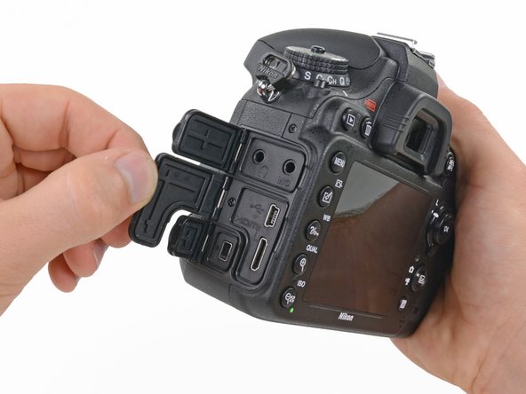

A shot of the camera controls reveals very similar button counts, button locations, and button functions.

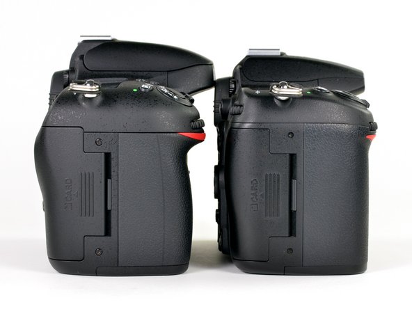

The D600 seems to have a slight size advantage, but how slight is "slight?"
Check out this shot of what appears to be the D7000 by itself. Look closer, though, and you will notice that the D600 hides quite nicely behind the similarly sized D7000. Apparently "slight" really is slight!
Do not get the two cameras confused, though. They may look simlar on the outside, but the full-frame sensor in the D600 will certainly raise the bar as far as photo quality goes.

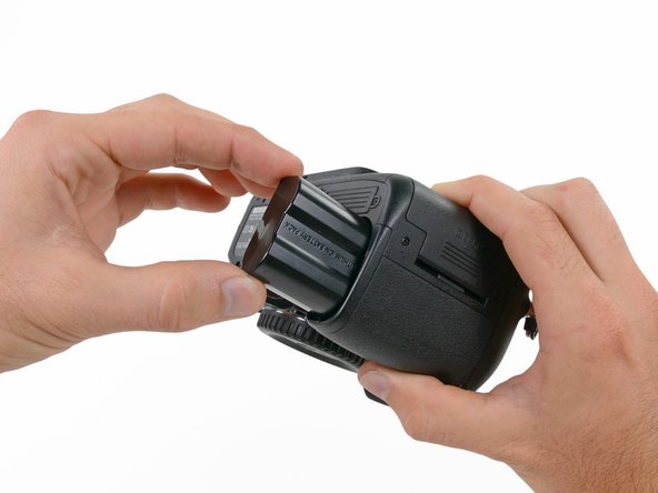

"Safety first!" That's our motto!

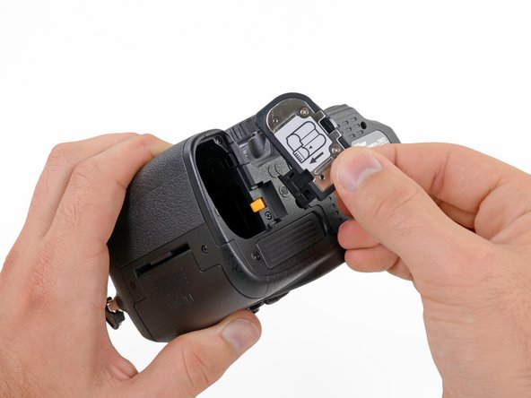

Before we pull this bad boy apart, we remove the battery and battery cover from the device.

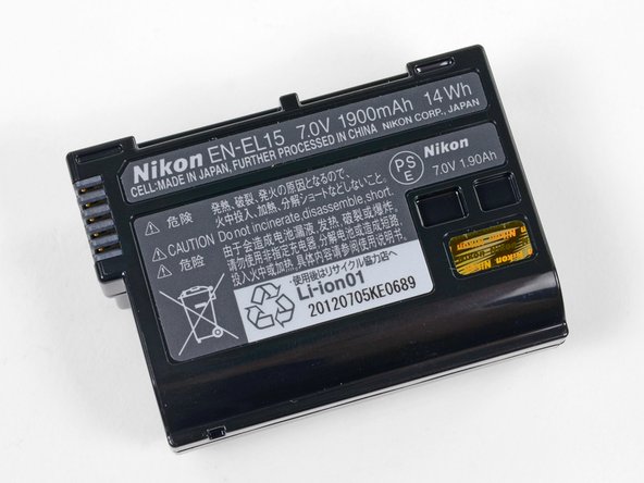

Nikon claims that the 7.0V-1900mAh-14Wh Lithium-ion battery can take 900 shots per charge, an understandable downgrade from the 1,050 of the D7000, most likely due to the improved internals.
It seems that Nikon likes to wait a while to design new batteries. When the D90 debuted in 2008, it used the same battery as its predecessor, the D80. Likewise, the D600 uses the same battery as the D7000.

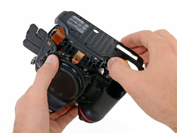

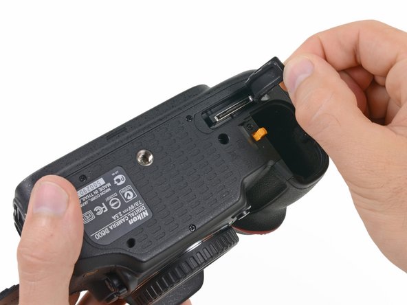

Several Phillips screws hold the bottom cover in place.
Poof! Like magic, the screws are released and we gain our first glimpse of the D600's insides.

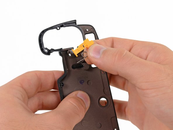

The only goodie on the underside of the bottom case is the battery release mechanism. If—for whatever reason—yours fails, it can be replaced pretty easily.

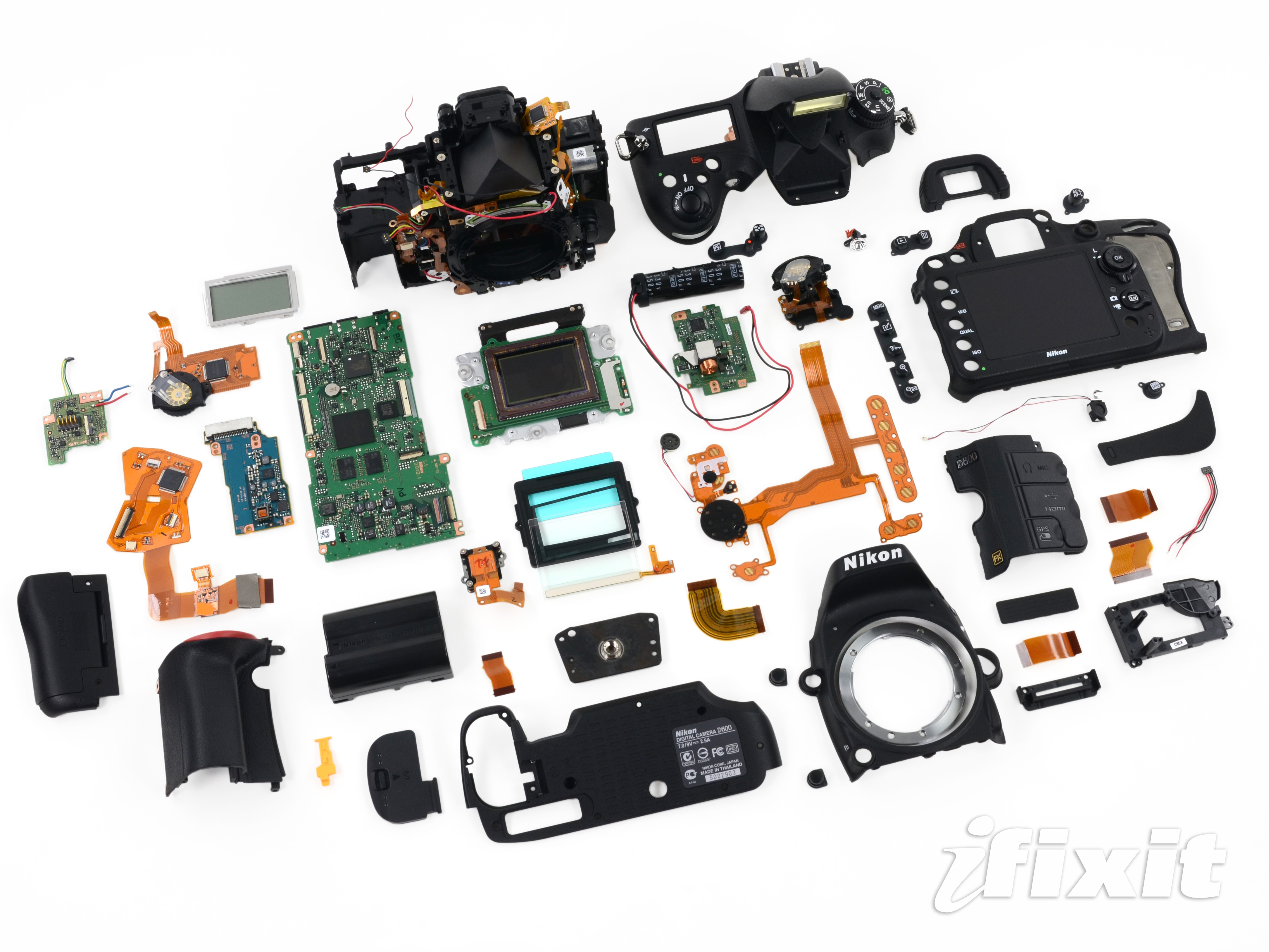

Nikon D600 Repairability Score: 2 out of 10 (10 is easiest to repair)
The battery can be easily replaced by opening the compartment with your thumbnail.
The tripod mount comes off after removing four Phillips #00 screws.
The D600 has several wires that need to be desoldered in order to take it apart.
Many, many screws hold the device together.
The LCD is fused to the rear case, and cannot be swapped without replacing the entire back of the camera.
For absolute safety, you need to discharge the flash capacitor, otherwise you risk accidentally killing your camera (or yourself).
