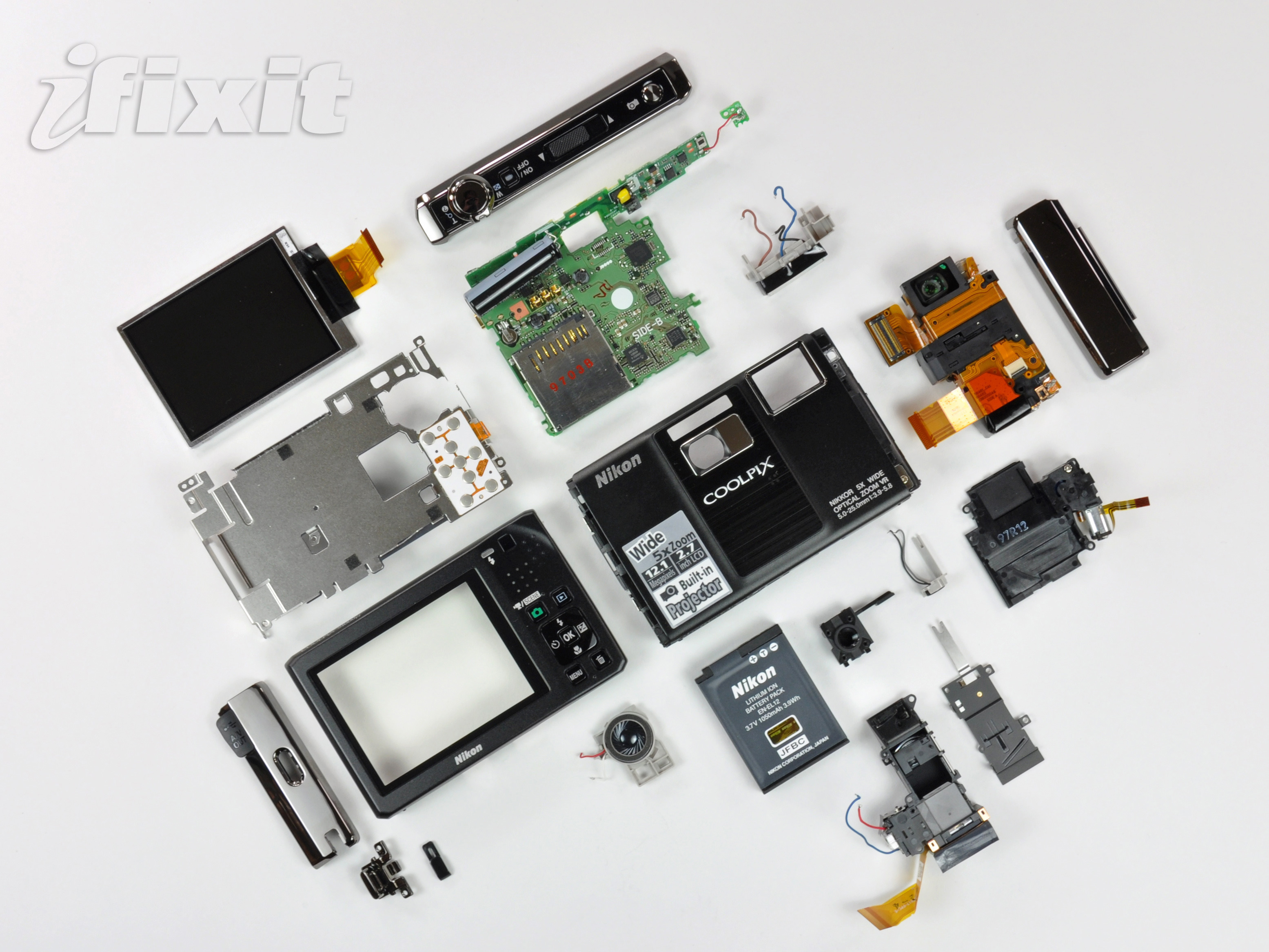

A while back we heard about the nifty Nikon Coolpix S1000pj, a digital camera with a built-in projector. We were very curious how Nikon packaged everything into this little device, so we decided to do what we do best -- tear it apart!

    • Light for projecting images is supplied by a very powerful LED (shown in red) that even has its own heat sink to conduct heat to the aluminum front panel.
    • As light leaves the LED it passes through some filters and lenses (shown in orange).
    • A good deal of engineered optical reflection allows the light emitted by the LED to reflect through a tiny LCD panel (shown in yellow) and head toward the mirror.
    • Before bouncing off the angled mirror and exiting the camera, the projected image passes through a focusing lens (shown in blue) connected to the slider on the top panel.

    • Nikon Coolpix S1000pj...you've just been Torn'd!
    • That's our new phrase, Torn'd.
    • That does it for this edition of iFixit's riveting teardown. Join us next time when we continue our teardown debaucheries!
