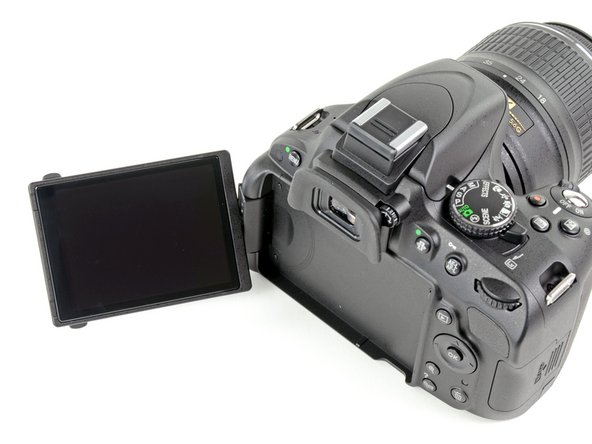

    • The flippy rotating screen is very useful -- especially if you're trying to record yourself for YouTube.
    • Unlike the D90, the top of the camera does not include an informational LCD. Instead, we get the rotating mode selector on the right.

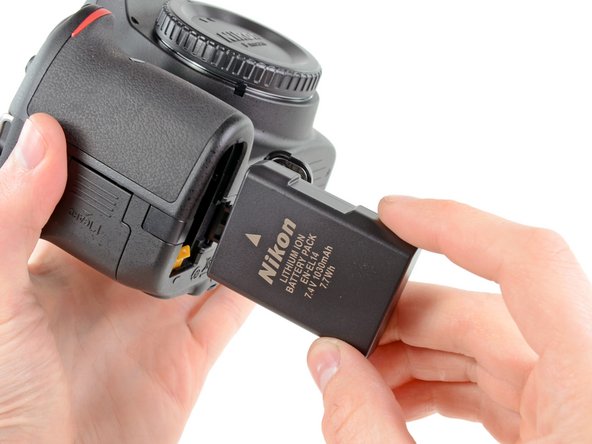

    • First thing's first: take out the battery. We don't want any electric juice running through the D5100's veins while we're taking it apart.
    • Especially not to the large-and-in-charge 330µF flash capacitor.
    • The 7.4 V 1030 mAh EN-EL14 Li-ion battery is used by the D5100, D3100, and the COOLPIX P700. Sadly, it's not compatible with other cameras in the Nikon lineup, such as the D90 and D7000.

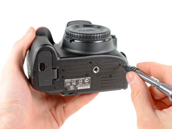

  4. Nikon D5100 Teardown: step 4, image 1 of 3 Nikon D5100 Teardown: step 4, image 2 of 3 Nikon D5100 Teardown: step 4, image 3 of 3
    • The camera has roughly 4 billion screws holding it together. We'll be skipping a lot of the "unscrewing this screw" pictures (like the ones shown in this step) in order to keep the teardown interesting.
    • Trust us, after the 50th screw, it gets boring.
    • As if exposed screws weren't enough, Nikon also chose to hide screws underneath covers and the rubberized thumb grip.

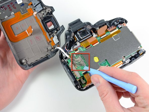

  5. Nikon D5100 Teardown: step 5, image 1 of 2 Nikon D5100 Teardown: step 5, image 2 of 2

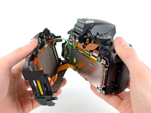

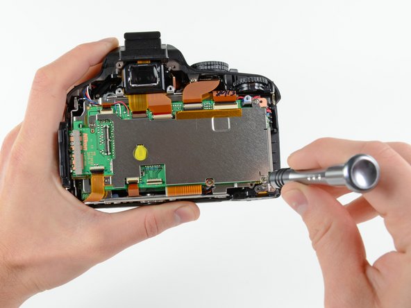

    • After a good twenty #00 Phillips screws were removed from the perimeter of the device, we managed to separate the rear cover.
    • A ribbon cable for the rear control buttons and a hefty 40 pin cable responsible for transmitting information to the rear display still attached the rear cover to the rest of the camera.
    • Fun fact: to eliminate the complexities of a slip ring on the rotating rear display, its motion is limited to 180 degrees.

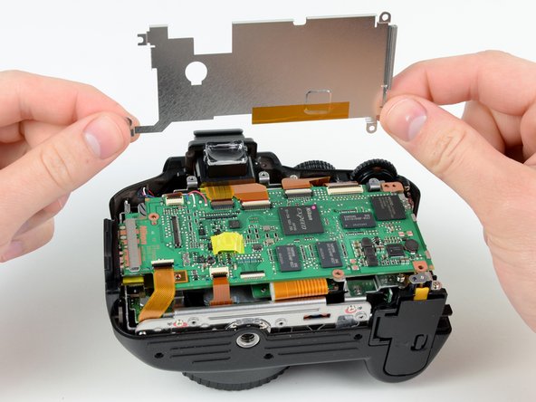

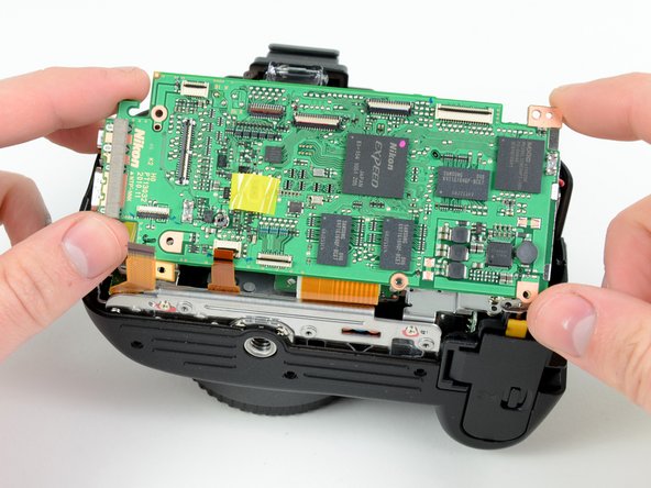

    • After removing a couple more screws, the protective steel shield was removed from the motherboard.
    • Then we had the pleasure of disconnecting nine cables (not all can be seen) and de-soldering a few wires; finally, the motherboard was lifted out of its home.

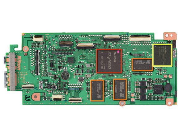

    • Front view of the motherboard. (High-res version of the motherboard, click here):
    • Nikon EXPEED 2 EI-154 1051 Z05 image processor
    • Samsung K4T1G164QF-BCE7 1Gb DDR2-800 SDRAM (total of 3 Gb = 384 MB)
    • MXIC MX29GL128EHXFI-90G 128 Mb parallel flash memory

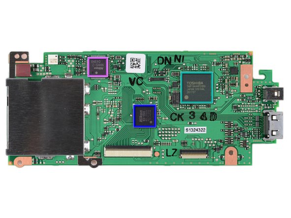

    • Rear view of the motherboard. (High-res version, click here):
    • Toshiba TMP19A44FEXBG low-power microcontroller
    • Nikon EI-155 M4L1BA00 00151044
    • Nikon NHHS-2 049M8

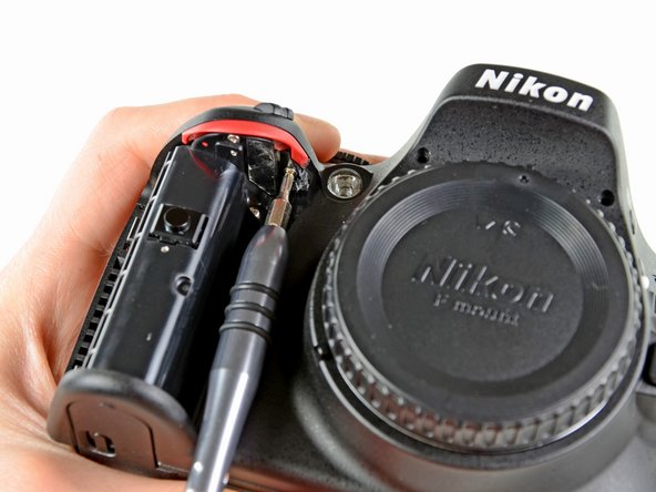

  8. Nikon D5100 Teardown: step 8, image 1 of 2 Nikon D5100 Teardown: step 8, image 2 of 2
    • After much time spent hunting around to figure out how the front cover was attached, we decided to peel off the rubber grip beneath the shutter button.
    • And we found the answer. To remove the front cover, a bunch more creatively-placed screws had to be removed.

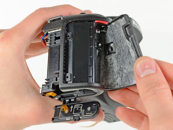

  9. Nikon D5100 Teardown: step 9, image 1 of 3 Nikon D5100 Teardown: step 9, image 2 of 3 Nikon D5100 Teardown: step 9, image 3 of 3
    • And just like that, the front cover can be pulled off the camera body.
    • With it gone, you can get a good look at most of the components that make the D5100 roar.
    • An electric motor (presumably linked to the shutter) can be seen next to the battery door, and the gigantic flash capacitor is housed right behind the lens release button.
    • The light blue pad wedged between the end of the flash capacitor and the bottom frame conducts heat away from the capacitor to cool it down during flash-intensive shooting.

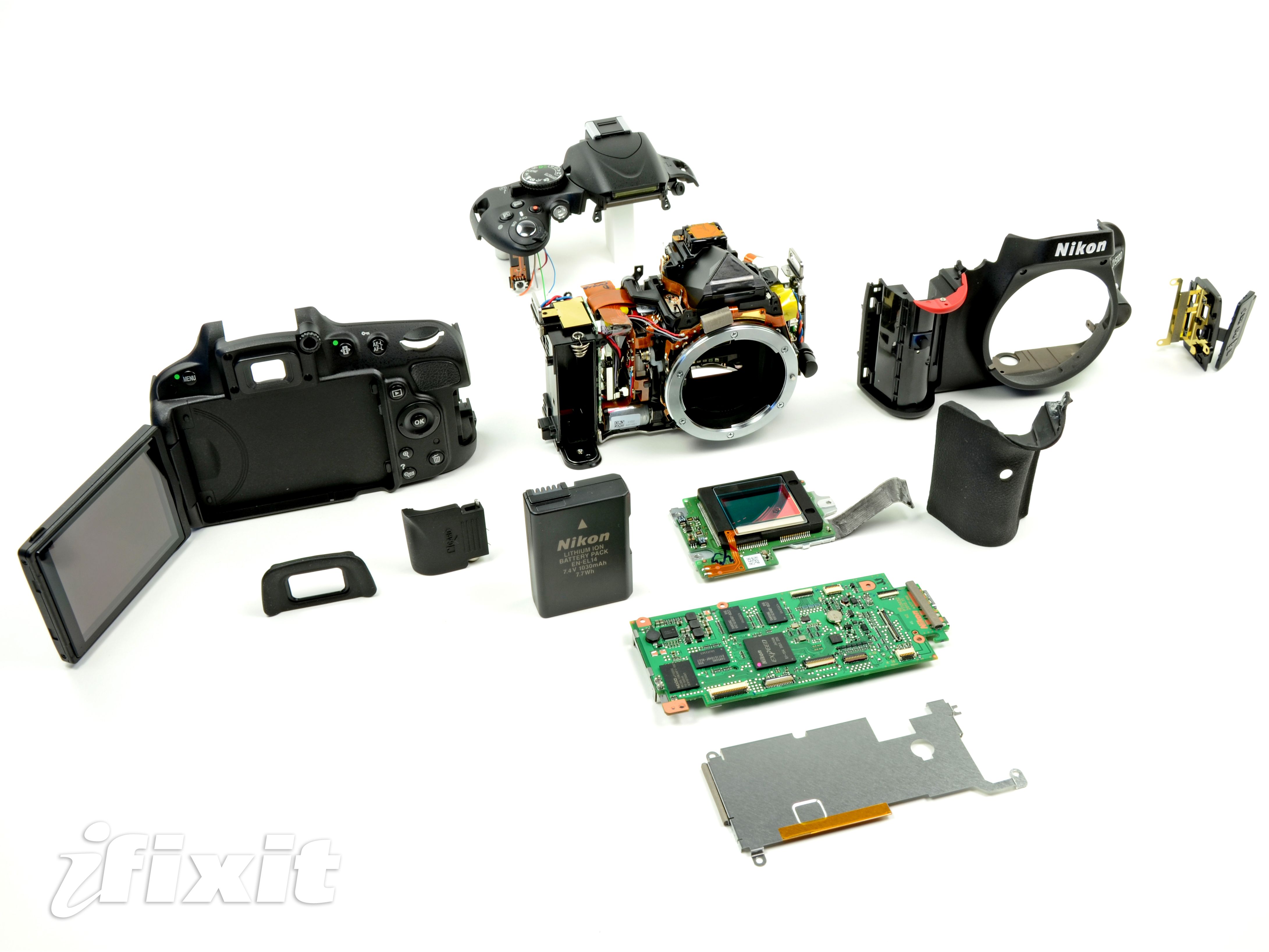

  10. Nikon D5100 Teardown: step 10, image 1 of 2 Nikon D5100 Teardown: step 10, image 2 of 2
    • Nothing to explain here. We're just amazed by the dizzying amount of electromechanical systems contained within a mid-priced SLR camera. Just look at all that stuff!

Super, used this to repair a D3100, the only extra trick was removing the diopter adjuster label to access hidden screw, otherwise as per your guide!
John in NZ - Reply
How did you remove the diopter label?!
Randy11 -
