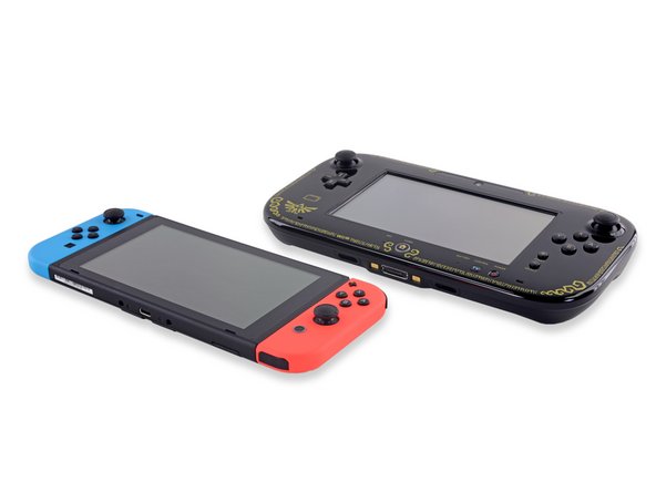

    • Before we get too far, we take stock of Nintendo's offerings. We've got the console itself, two Joy-Cons, a dock, and the Joy-Con Grip.
    • With the Joy-Cons attached, the Switch console measures approximately 9.4" wide, 4" tall, and only half an inch in depth.
    • Despite added functionality, the Joy-Con'd console only weighs 0.88 pounds— less than the 1.1 pound Wii U GamePad.

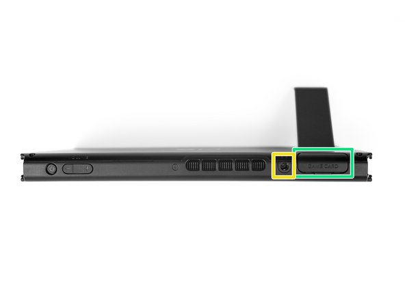

    • The first thing we note is the weird Domino's logo the model number—HAC-001.
    • Doing a quick turnaround, ports include:
    • MicroSD located underneath the (surprisingly stiff) kickstand
    • USB-C (for the dock)
    • Standard 3.5 mm headphone jack
    • Proprietary Nintendo game card slot
    • The fan vents through the top of the device, and initial reports say the Switch makes heavy use of that cooling channel while docked and pushing 1080p graphics.

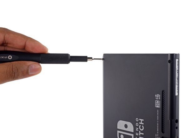

    • Disappointingly, tri-point screws guard the entrance to Hyrule the Switch, but we only have to flex 1/64th of our muscle.
    • Tri-points are Nintendo's version of a "Keep out" sign, but once you're past them the back cover lifts off easily—no clips or adhesive.

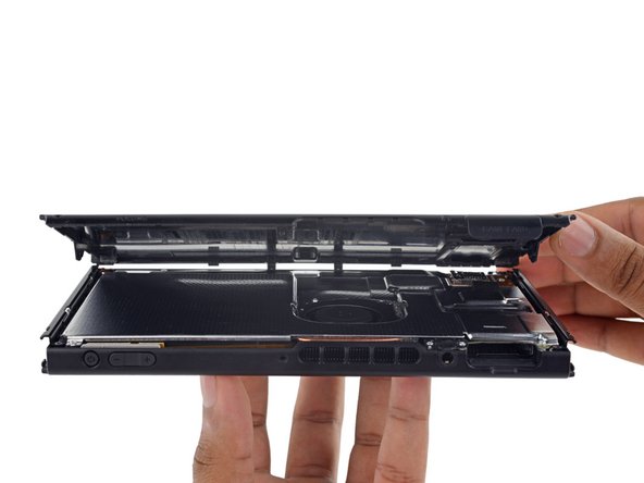

    • And now for the moment we've all been waiting for...the internal reveal. It's finally happening!
    • It... looks like a computer! Battery, heatpipe, thermal paste, fan. It's all there.
    • The Switch's priorities are pretty clearly battery and cooling.
    • By the looks of that purple blob, this metal plate is more than structural support. It's also a heat sink that channels heat from the heat pipe to the rear case.
    • This should diffuse the heat, preventing hot spots that could melt plastic or burn your fingers.

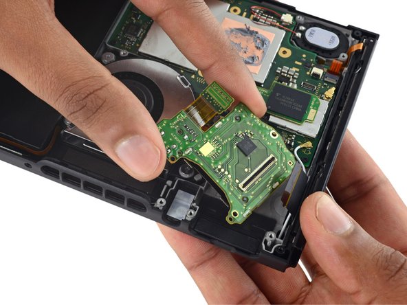

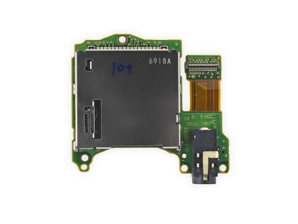

    • So we pop out the game card reader, and attached headphone jack.
    • And no, we didn't lick any cartridges.
    • STMicroelectronics FingerTip touchscreen controller on the opposite side of the game card reader

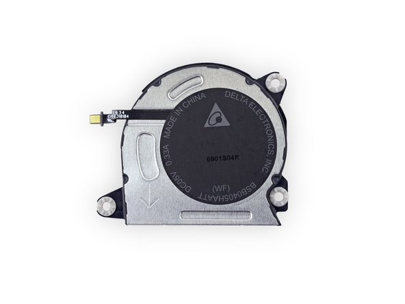

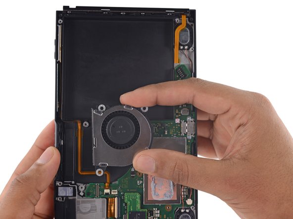

    • With I/O board free, we can focus on the fan.
    • This Delta electronics fan is held in place by three screws with rubber vibration damping mounts, and is rated for 5 V and 0.33 A.
    • A fan can be a death sentence for battery life in any portable device, so it makes sense that rumors have it that the graphics are drastically underclocked when you're undocked.
    • In addition to saving power by pushing fewer pixels, this ought to also let the Switch save juice by running the fan quite a bit less.

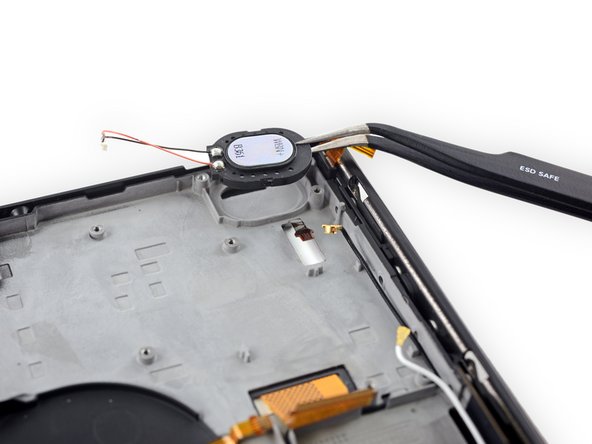

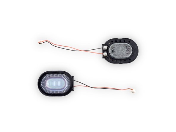

    • The stereo speakers are lightly adhered to the rear case, but don't put up much of a fight.
    • These speakers are trying hard to pump that bass. The larger diaphragms will displace more air, and a ported back allows for booming bass. But initial reports say they still "favor treble."

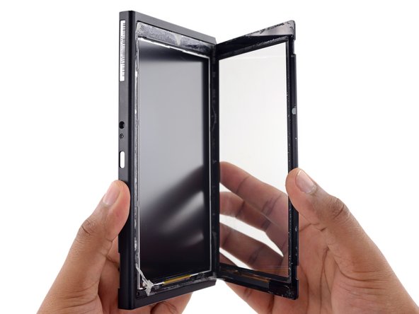

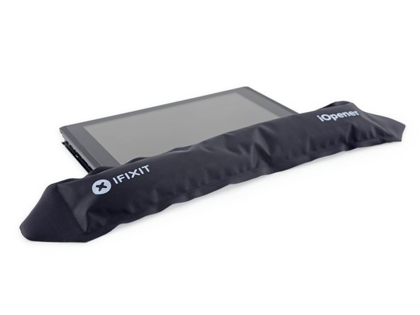

    • Unlike a lot of modern touchscreen devices, the digitizer on the Switch is not fused to the display, meaning you can replace the two parts independently. Thanks for keeping repairability in mind Nintendo!
    • The digitizer is adhered by a double-sided adhesive strip that runs around the perimeter of the display. With a bit of heating and prying, we manage to coax the digitizer off.
    • But in all our excitement, our hasty teardowner severed the digitizer data cable. Fixers be warned, this book opens longways.
  15. Nintendo Switch Teardown: step 15, image 1 of 1

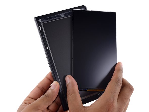

    • And for the cherry on this sundae? The LCD display is easily removable!
    • Increasing a device's portability usually means increasing its likelihood of getting dropped. So way to go Nintendo for making a more breakable device more fixable.

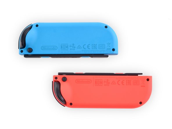

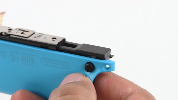

    • Nintendo provided some color coding to remind us that these seemingly identical Joy-Cons actually house different hardware.
    • With different contents come different model numbers: The neon blue controller is designated HAC-015, while the neon red is HAC-016.
    • Neon not your thing? If you're good at stickers, you can mask their true colors with a skin.
    • The Joy-Cons aren't waterproof, and Nintendo even recommends that you don't use them near your fish tank.

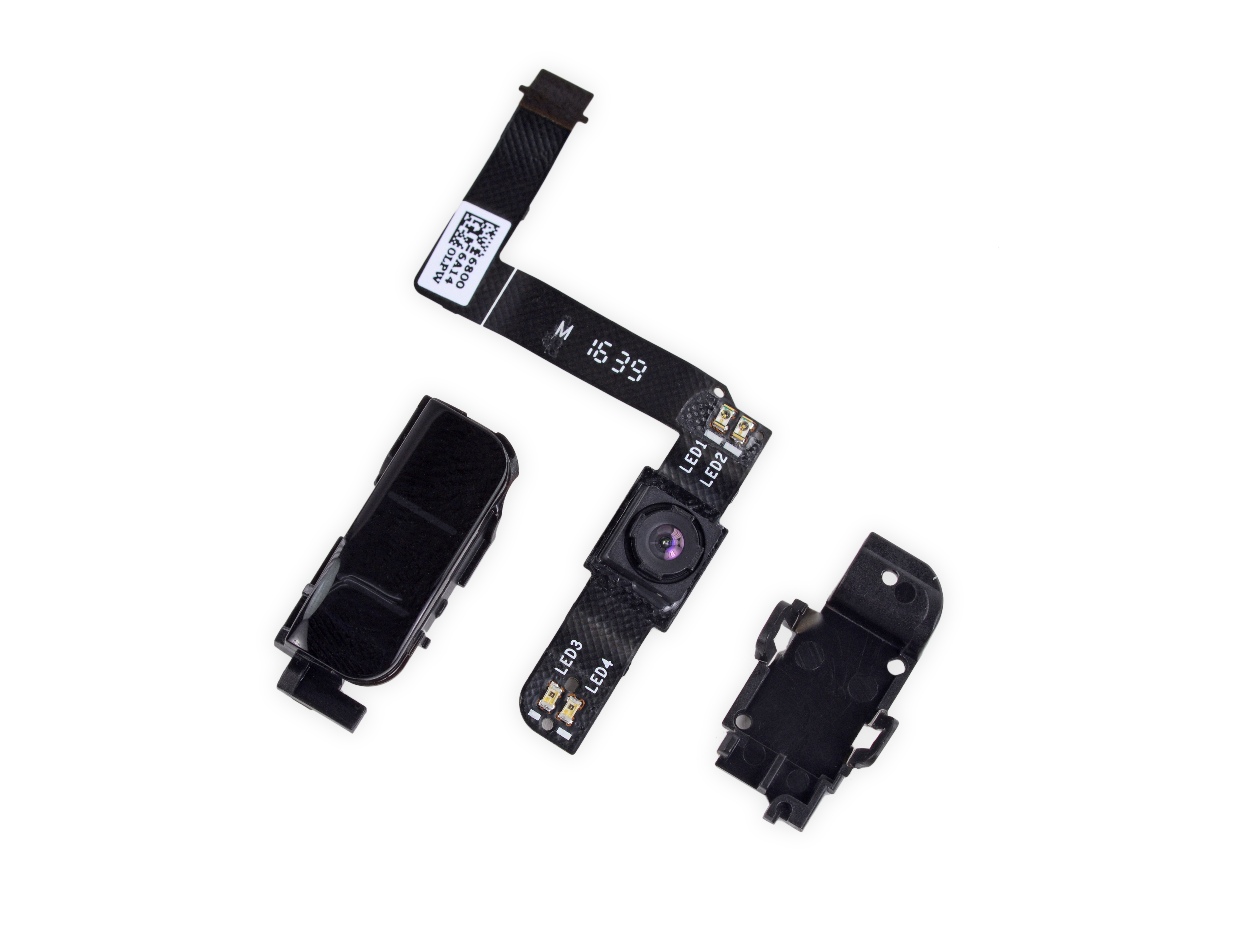

    • The IR hardware consists of an IR camera and four IR LEDs. Nintendo says that the camera can detect different hand shapes, distance, and in the future will be able to record video. As for the LEDs, our bet is that they cast IR light onto nearby objects to make them easier to identify.

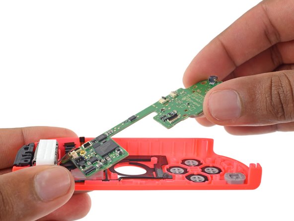

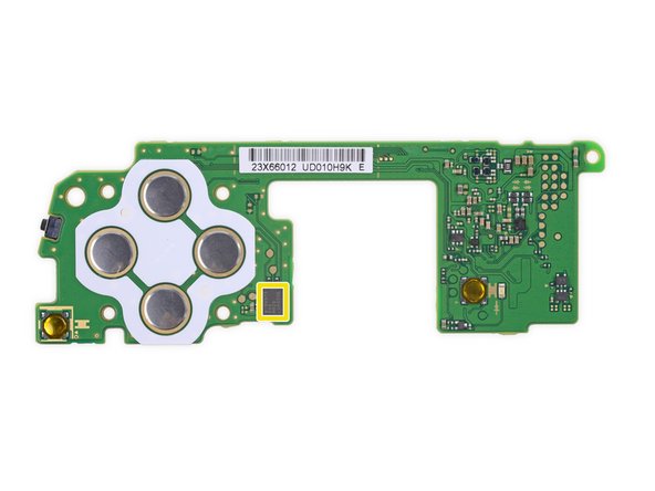

    • We lay out the controller boards in search of more silicon. Here's the feature-rich red board in all its glory (the blue board is shaped a bit differently, but has most of the same bits):
    • Broadcom BCM20734 Bluetooth 4.1/2.4 GHz Transceiver
    • STMicroelectronics ST21NFCB NFC controller
    • Macronix International MX25U4033E 4 Mb CMOS Flash
    • STMicroelectronics STM32P411 32-bit microcontroller
    • STMicroelectronics LSM6DS3H 3-axis accelerometer/gyroscope (likely)
    • Texas Instruments BQ24072 linear battery charger w/ power path management
    • Rohm BD27400GUL mono class-D audio amplifier

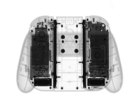

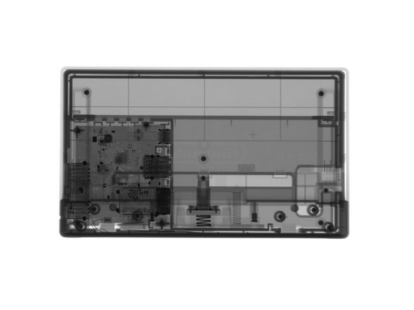

    • Before breaking into the Switch's home, we had our friends at Creative Electron perform some recon. We didn't want to hit any booby traps.
    • Let's be honest: that X-ray image is cooler than our findings. For all intents and purposes, the dock consists of a board in a box with a handful of ports including:
    • Two USB 2.0 Ports
    • AC Adapter Port
    • HDMI Port
    • One USB 3.0 Port
    • According to Nintendo, the rear USB port will only have USB 2.0 support at launch. A future update will bring USB 3.0 support.

    • It's time to hit you with our best shot some layout shots! Here are the Nintendo Switch's delicately laid out internals.
    • Thanks again to our super-vision-having heroes over at Creative Electron!

    • Aside from the digitizer, screws are used instead of adhesive to hold components in place.
    • Most components, including the analog sticks, game cartridge reader, and headphone jack are modular and can be replaced.
    • Batteries, while adhered to their housing, are modular and can be replaced by end users.
