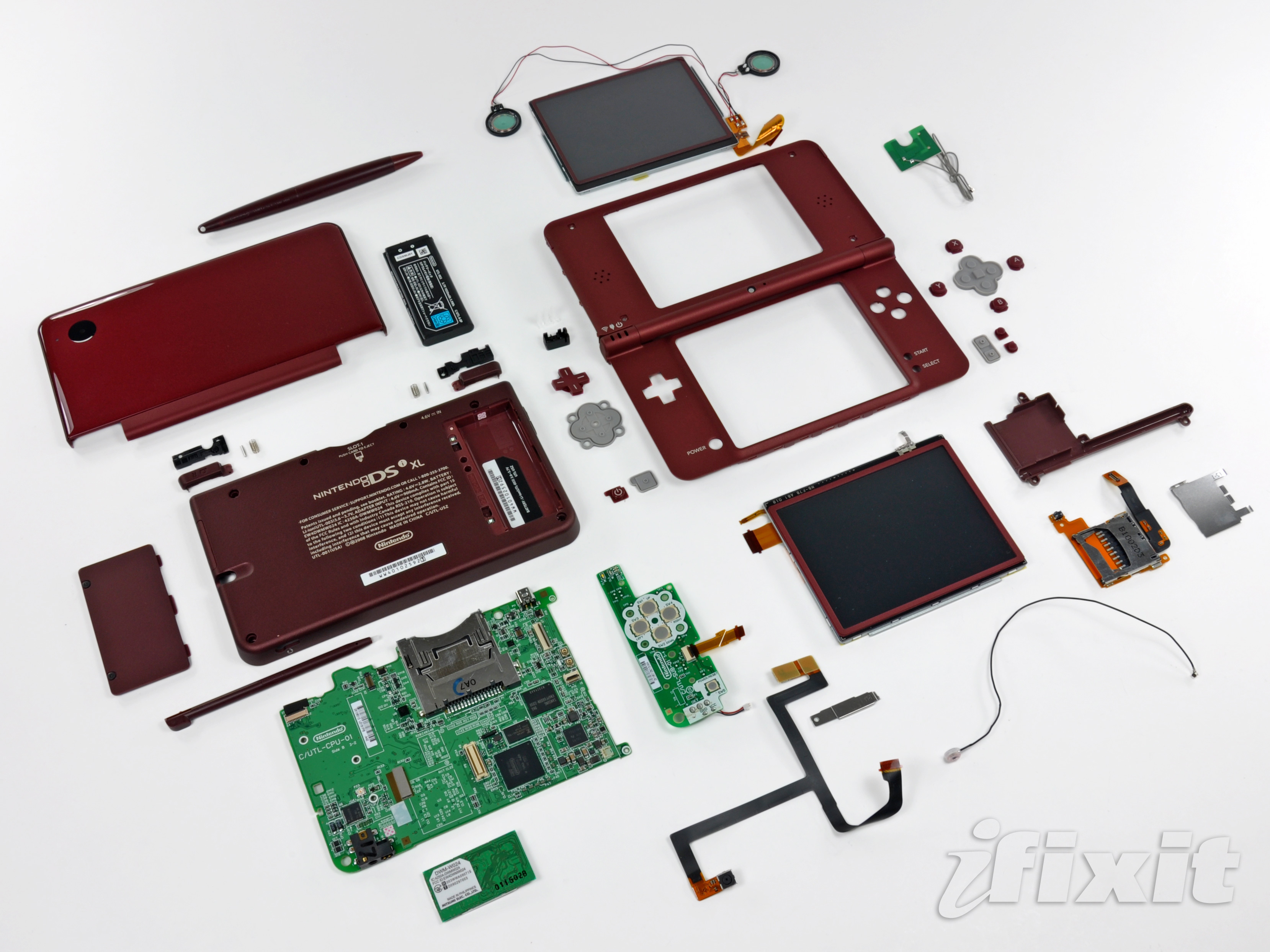

    • A total of seven Phillips screws are all that stand in the way between us and the innards of the DSi XL.
    • Keep track of each screw's location because they have different lengths.
  8. Nintendo DSi XL Teardown: step 8, image 1 of 1
    • After a bit of careful prying, the lower case comes off without a hassle.
    • An orange ribbon remains connected to both cases. Pry with care to prevent any damage to this connector.

  10. Nintendo DSi XL Teardown: step 10, image 1 of 3 Nintendo DSi XL Teardown: step 10, image 2 of 3 Nintendo DSi XL Teardown: step 10, image 3 of 3
    • Lift the Wi-Fi board from its edge nearest the center of the DSi, and it comes right off the logic board.
    • Use the flat end of a spudger to pry both antenna cable connectors from their respective sockets on the Wi-Fi board and logic board.
  11. Nintendo DSi XL Teardown: step 11, image 1 of 2 Nintendo DSi XL Teardown: step 11, image 2 of 2
    • Removing the main board is a piece of cake:
    • Remove the five Phillips screws.
    • Disconnect the six connectors on the front side, flip the board over and remove the one last connector hiding on the back.
    • Whenever unlocking flat ribbon cable sockets, use your fingernail to flip up the small retaining flap.
  12. Nintendo DSi XL Teardown: step 12, image 1 of 1
    • The lower display is held in place by the pressure of the board secured over it. No screws!
    • After freeing it from the light adhesive around its perimeter, lift the lower display out of the DSi XL.
    • The displays on the DSi XL conveniently integrate the digitizer, LCD, and backlight into one package.

  19. Nintendo DSi XL Teardown: step 19, image 1 of 2 Nintendo DSi XL Teardown: step 19, image 2 of 2
    • Remove the seven Phillips screws securing the left trigger, right trigger, and the stylus holder to the bottom outer case.
    • Lift the SD board and the stylus holder out of the case.
    • The electronic right trigger button is integrated into the SD board.
    • Reassembling the triggers is quite difficult. Take them apart if you dare.
  20. Nintendo DSi XL Teardown: step 20, image 1 of 2 Nintendo DSi XL Teardown: step 20, image 2 of 2
    • Samsung and Fujitsu chips are identical to the DSi:
    • Samsung 1st generation MoviNAND KMAPF0000M: 256 MB NAND Flash and MMC controller. The integrated MMC controller allows the CPU to offload the complex work of directly talking to the flash memory.
    • 82DBS08164D-70L: Fujitsu Ltd 128-bit FCRAM (fast-cycle RAM) chip.
    • TI (TXN) 72071B0 power managing and charging circuit. This used to be a Mitsumi chip in the smaller DSi.
    • PAIC3005B: We assume it stands for Primary Antenna Interface Controller, given that it's located right by the antenna.
    • Primary Nintendo ARM CPU, manufactured the last week of 2009. This chip's markings are identical to the DSi. It's definitely not the Tegra chip that had been rumored.
