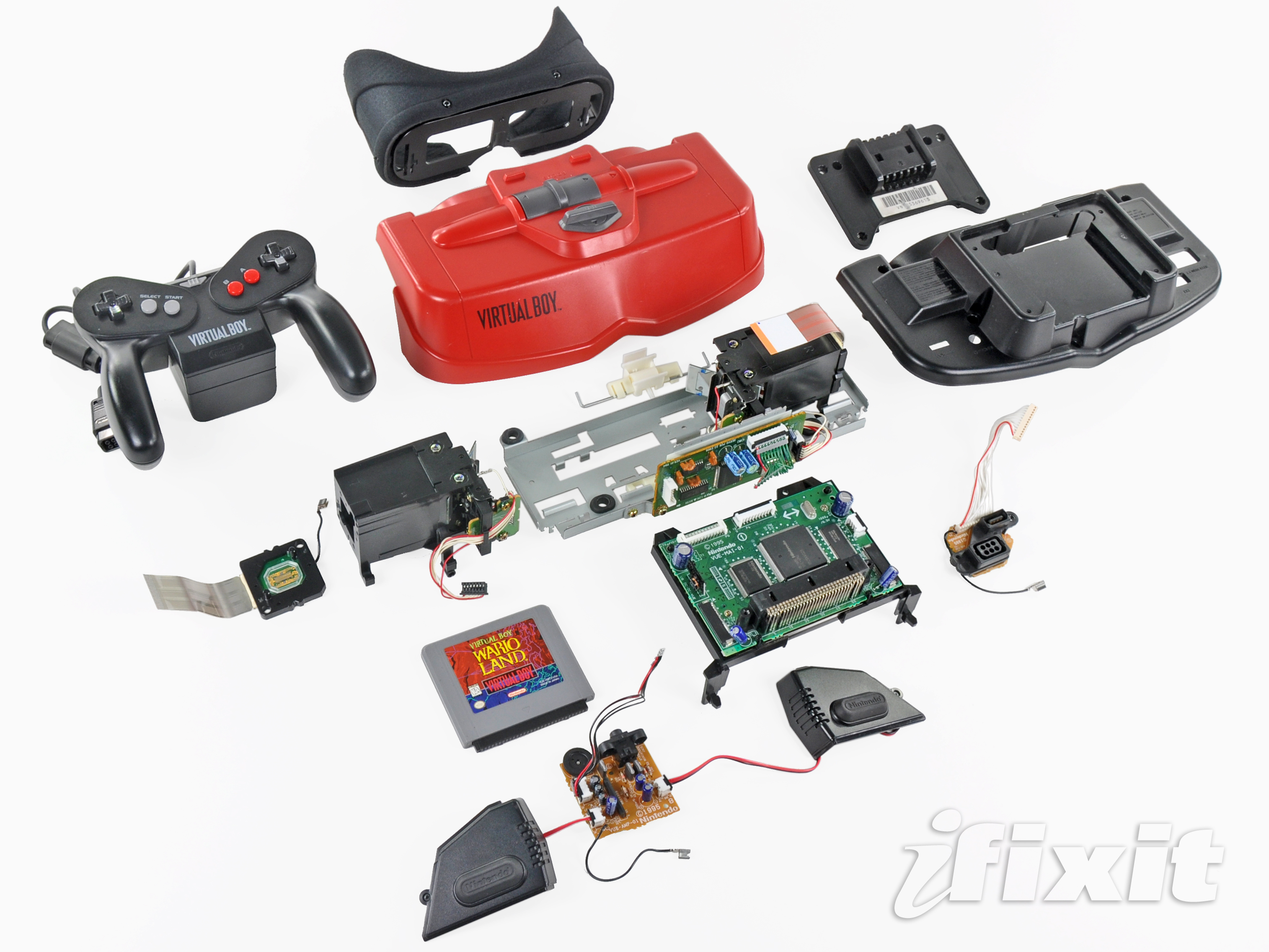

    • Unfortunately, taking the Virtual Boy apart is not a walk in the park.
    • When we found out that our 1/4" drive gamebit did not fit down into some of the recessed screw holes, we had to get creative.
    • After donning safety glasses and throwing many sparks from our rotary cutoff wheel, we ended up with a nice little gamebit socket that is easy to turn with a flathead screwdriver.
    • With that out of the way, we can finally start taking this thing apart.
  5. Nintendo Virtual Boy Teardown: step 5, image 1 of 3 Nintendo Virtual Boy Teardown: step 5, image 2 of 3 Nintendo Virtual Boy Teardown: step 5, image 3 of 3
    • The neoprene eye shield and its frame pop right off the rear of the Virtual Boy.
    • After making short work of the screws securing the tripod base with our custom gamebit, it can be lifted off the lower case.
    • Nintendo apparently had repair in mind when they designed the tripod base, as it is easily removable in the [likely] event that the tripod base would break during a fall.
  6. Nintendo Virtual Boy Teardown: step 6, image 1 of 3 Nintendo Virtual Boy Teardown: step 6, image 2 of 3 Nintendo Virtual Boy Teardown: step 6, image 3 of 3
    • After removing the rest of the hard-to-access screws, you can lift off the lower case from the Virtual Boy.
    • Several ribbon cables attach the main board to the main components across the Virtual Boy. After disconnecting them, the board easily comes out.

    • The main board is responsible for taking inputs from the controller, loading game cartridge data, sending audio data to the speaker amplifier, and driving the LED displays. The silk screened chips include:
    • Nintendo '95 VUE-VPU, 9520KK023
    • Nintendo NVC-VUE, (C) NEC '91 '93 9520KX003
    • Nintendo VRM-VUE, 9508KU028
    • Toshiba TC511664BJ-80 128 KB of DRAM
    • Toshiba TC511632FL-70
    • Nintendo '95 VSU-VUE ATT, 9507A3014
    • Texas Instruments 57A5CXK, HCU04

    • A couple Phillips screws secure the controller port and sound boards to the upper case.
    • After removing the screws, both boards can be lifted out of the Virtual Boy.
    • The modular construction of the Virtual Boy indicates it was designed with repair in mind. A damaged controller port or audio system could be individually replaced rather than replacing a single all-encompassing motherboard if one of its components failed.
  9. Nintendo Virtual Boy Teardown: step 9, image 1 of 1
    • The controller board and the sound system come out, followed by the display assembly.
    • As you'll soon find out, the rubber isolators between the metal display assembly chassis and the upper case are designed to dampen vibrations originating from the Virtual Boy's two oscillating mirrors.

    • The Virtual Boy employs an extremely creative way of producing its unique binocular (and 3D) graphics.
    • A one-pixel-tall row of LEDs at the far end of each display unit projects light through a lens in the middle of each unit.
    • After passing through the lens, light is reflected off a mirror situated at 45o that oscillates about its central axis.
    • The mirror oscillates and the LED refreshes with such speed that the human eye perceives a single image across the view plane.
  12. Nintendo Virtual Boy Teardown: step 12, image 1 of 2 Nintendo Virtual Boy Teardown: step 12, image 2 of 2
    • To oscillate the mirror, alternating electrical current at high frequency is passed through a copper coil attached to the mirror. A stationary iron core is attached to the display unit, forming a solenoid to produce the motive force needed for oscillation.
    • To tell the oscillator circuitry how fast the mirror is moving, an arm attached to the mirror passes back and forth through an optical sensor attached to the lower circuit board.
  13. Nintendo Virtual Boy Teardown: step 13, image 1 of 1
    • The board you see here is responsible for driving the oscillation of both mirrors.
    • The chips on this board receive display information from the main board and ensure that the mirrors are oscillating at the correct frequency by receiving feedback signals from the optical sensors shown in the previous step.
    • An 8 MHz crystal soldered to the board is used for timing the oscillation of the mirrors.
