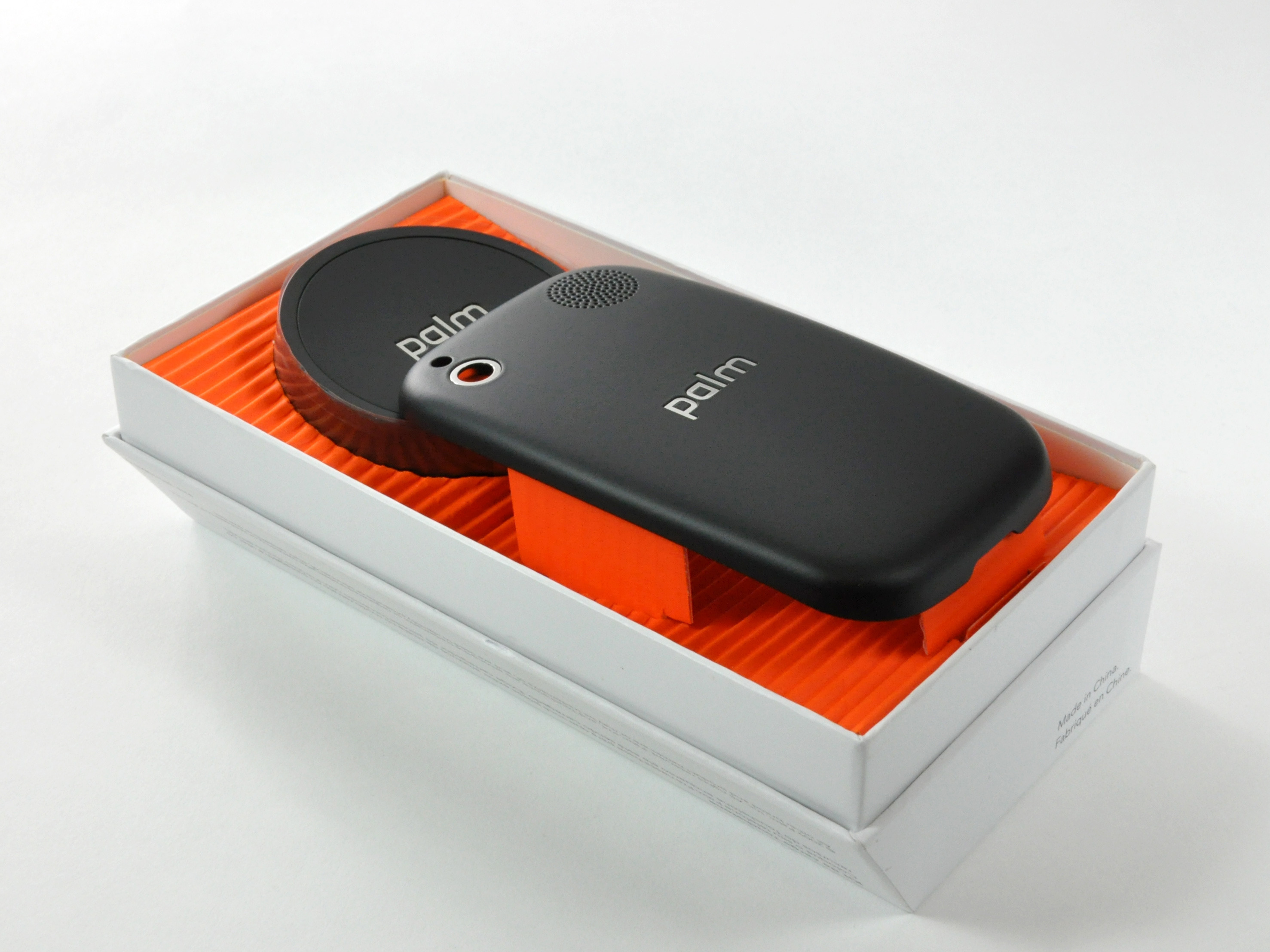

    • The beautifully designed packaging includes:
    • Touchstone charging dock.
    • Touchstone back cover.
    • User guides and warranty information.

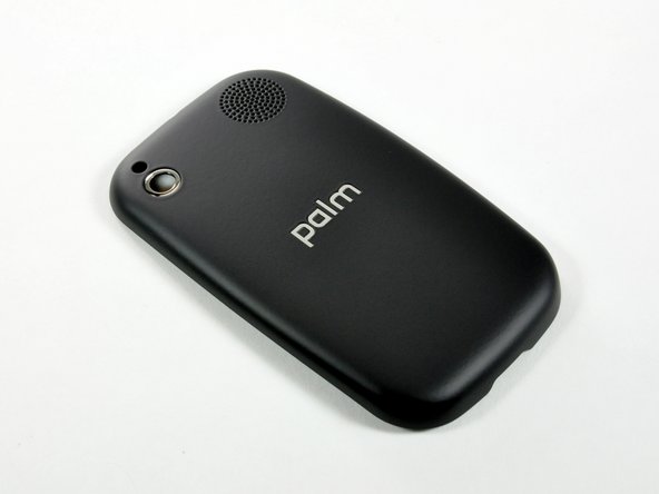

    • Side-by-side view of the Touchstone back and the standard Pre rear panel.
    • The Touchstone rear panel has a matte finish, probably to reduce visible wear from constant contact with the dock.
    • The outline of the induction loop (large circle) is visible on the inside of the Touchstone rear panel. The current produced by induction flows into the Pre via two gold plated pressure contacts.
    • The four small circles are magnets that align the Pre to the Touchstone dock, similar to the way Best Buy's iPod displays always align the iPod right side up.

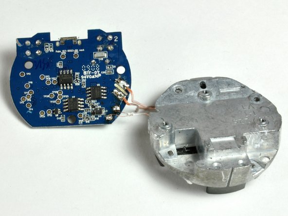

    • The inductor charging base assembly.
    • The new Palm Touchstone wireless charger works on the principle of resonant induction. When you move a magnetic field near a coil of wire, it induces a current in the wire.
    • Taking advantage of this principle, the Touchstone creates an electrical coupling between two coils of wire that are not physically connected. It does this with a primary coil of wire in the base unit which transmits energy to the secondary coil of wire in the phone via a magnetic field.
    • The magnetic field generated by the base unit flips back and forth rapidly, generating a magnetic pulse that is carefully tuned to the dimensions of the wire coil inside the phone. This oscillating magnetic field induces a current inside the phone, allowing the battery to be charged.
    • Similar technology is used to transmit power to some battery-operated toothbrushes, razors, etc.
