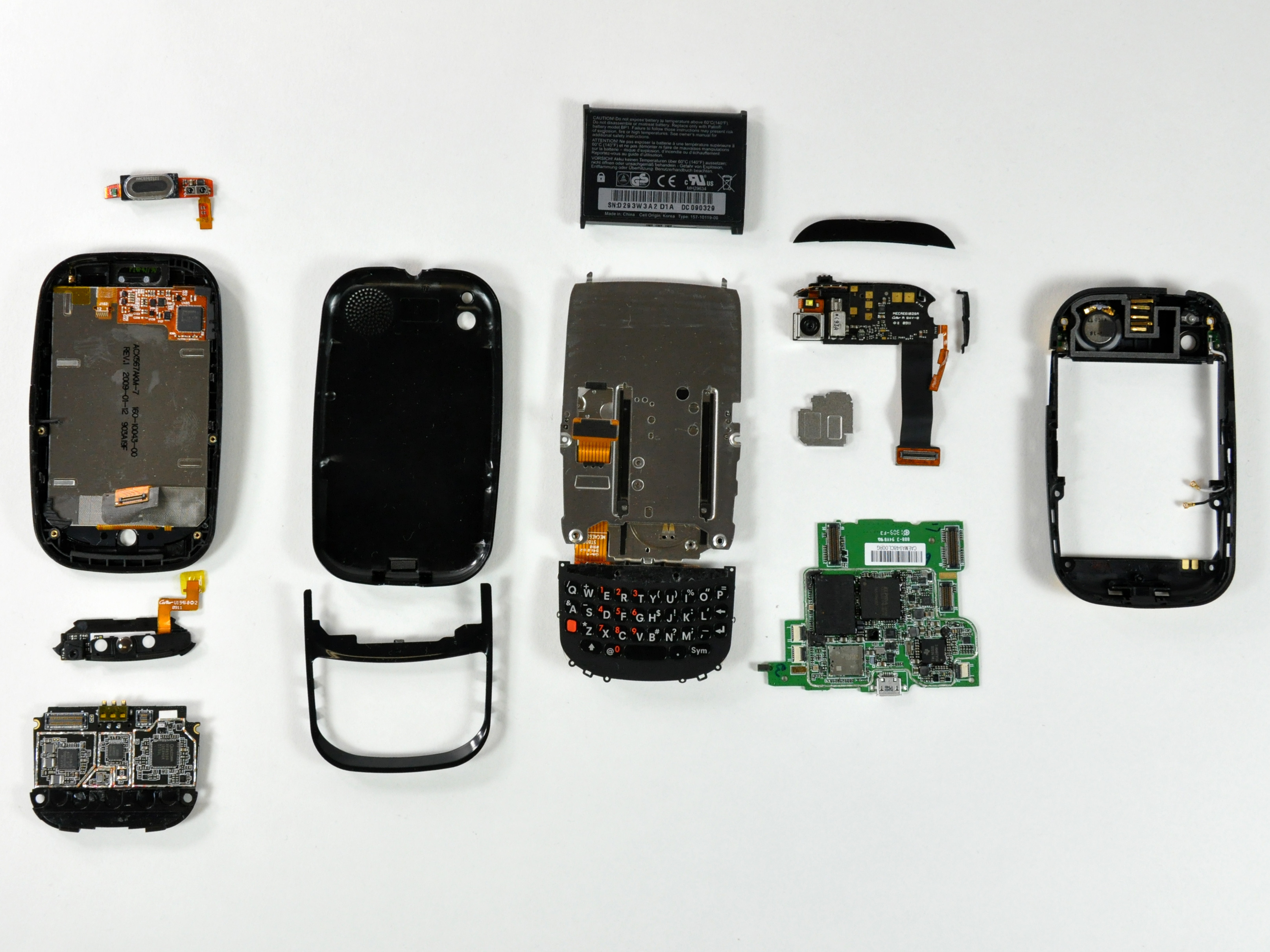

    • Internal components, from left to right:
    • Earpiece speaker, LCD display and digitizer, microphone, communications board.
    • Original rear panel and plastic framework.
    • Battery, internal metal framework and spring mechanism, keyboard.
    • Camera board and main circuit board.
    • Main plastic framework containing antennas, antenna cabling, and the surprisingly excellent speakerphone.
