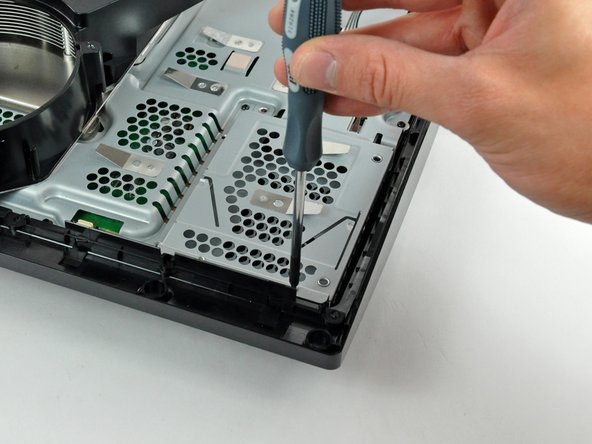

    • Remove the three (or on some models, four) TR8 security Torx screws on the underside of the PS3 slim.
    • What's that, you say? Security screws? Yes, that's right. These screws have a pin in the center of them that prevents an ordinary Torx screwdriver from working. These screwdrivers are widely available, just not quite as easy to come by as a normal Torx.
    • Sony did this to prevent people like us from taking it apart.
    • Those three TR8 security Torx screws seem to be the only non-Phillips head fasteners on the entire device.
    • This seems a little spiteful-- hardware hacking is a fine American tradition. No worries, we'll make sure it's easy for you to get these screwdrivers.

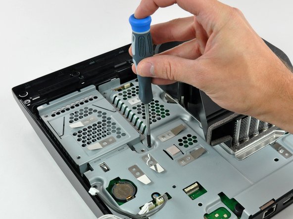

  7. PlayStation 3 Slim Teardown: step 7, image 1 of 2 PlayStation 3 Slim Teardown: step 7, image 2 of 2
  8. PlayStation 3 Slim Teardown: step 8, image 1 of 1
    • Seven Phillips screws need to be removed from the bottom.
    • Interestingly enough, the rubber pad on the front-right corner of the PS3 has no screw hidden underneath it. Imagine our surprise when we removed it!

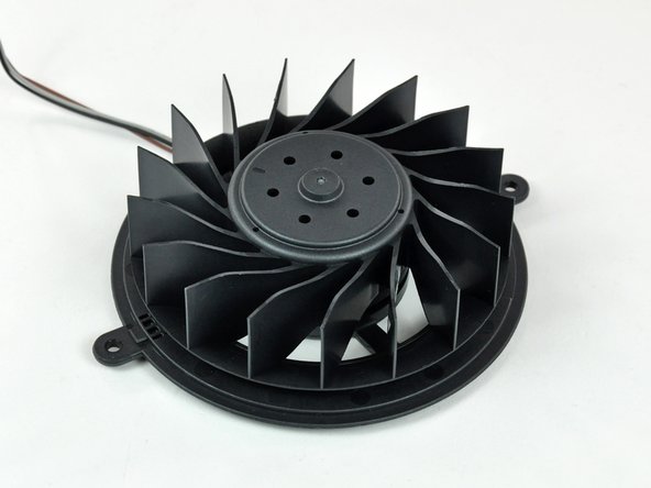

  14. PlayStation 3 Slim Teardown: step 14, image 1 of 3 PlayStation 3 Slim Teardown: step 14, image 2 of 3 PlayStation 3 Slim Teardown: step 14, image 3 of 3
    • This is the largest fan we've come across in a consumer electronics device of this size.
    • Sony is really taking cooling quite seriously.
    • The ~95 mm diameter 17 blade impeller was definitely designed with quiet in mind. It is extremely stiff and presumably made of ABS plastic.

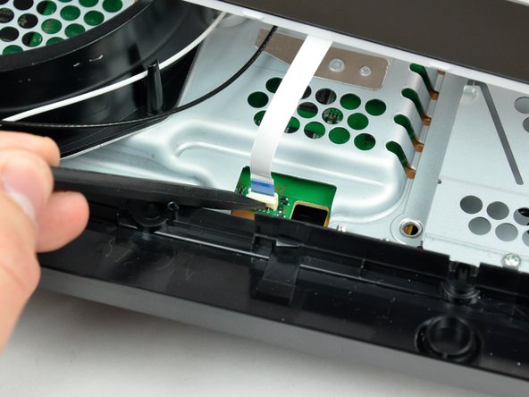

  15. PlayStation 3 Slim Teardown: step 15, image 1 of 2 PlayStation 3 Slim Teardown: step 15, image 2 of 2
    • Tape holding down antenna and power cables.
    • That tape is just begging to be ripped off.
    • We indulged.

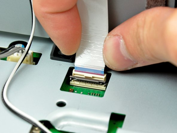

  16. PlayStation 3 Slim Teardown: step 16, image 1 of 3 PlayStation 3 Slim Teardown: step 16, image 2 of 3 PlayStation 3 Slim Teardown: step 16, image 3 of 3
    • A tug at the plug, a twist of the screwdriver...

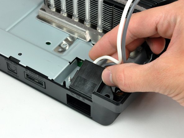

  18. PlayStation 3 Slim Teardown: step 18, image 1 of 3 PlayStation 3 Slim Teardown: step 18, image 2 of 3 PlayStation 3 Slim Teardown: step 18, image 3 of 3
    • More connectors and screws to unplug/unscrew.
    • The design aesthetic of this machine is quite a bit more bare-bones-functional than Apple's, but is still beautiful in its own way.
    • Several components, including the AC power inlet, are simply held to the unit by the pressure of the screws connecting the top and bottom cases.

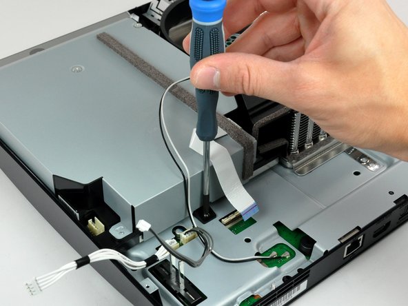

  19. PlayStation 3 Slim Teardown: step 19, image 1 of 3 PlayStation 3 Slim Teardown: step 19, image 2 of 3 PlayStation 3 Slim Teardown: step 19, image 3 of 3
    • A few more screws, and the logic board lifts free of the chassis!
    • Those three T8 security Torx screws seem to be the only non-Phillips head fasteners on the entire device.

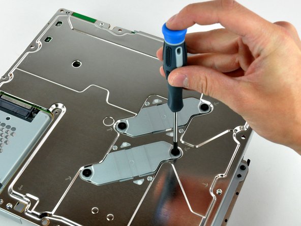

  20. PlayStation 3 Slim Teardown: step 20, image 1 of 2 PlayStation 3 Slim Teardown: step 20, image 2 of 2
    • Unscrewing several screws securing the EMI shield.
    • The two identical matte finished brackets in the first picture are designed to apply pressure to the center of the processors, keeping them firmly planted on their heat sinks.

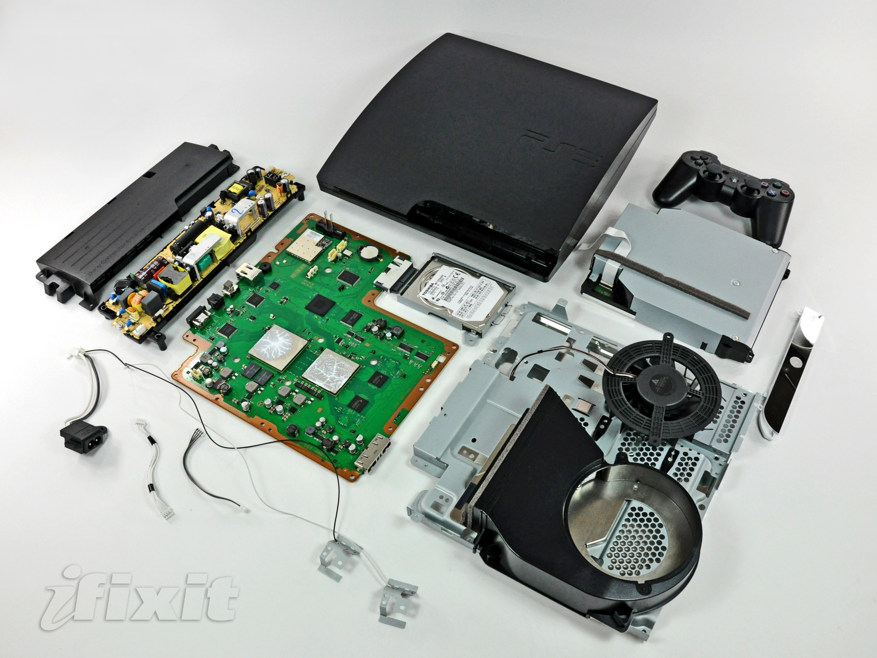

    • The whole [slim] enchilada!
    • Counterclockwise from the left:
    • Power supply, main board, hard drive, EMI shield, heat sink, fan, Blu-ray drive, controller, and plastic case.

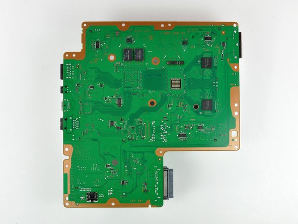

    • That's it for the disassembly, but we'll continue to post board photos and analysis as the information pours in.
    • The logic board. Sony's going green on the inside, to reflect their commitment to the environment.
    • We've never seen cool snowflake-like patterns in the thermal paste after we removed a heat sink before. This may indicate that the thermal paste was overapplied or that it was not distributed evenly.
    • If you look closely at the thermal paste, you'll see it is a fractal!

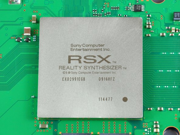

    • The Cell processor looks very spiffy under our lights.
    • We didn't think it was possible to synthesize reality, but the RSX chip (from an Acura?!) proves us wrong.
    • Chip labels: RSX Reality Synthesizer CXD2991EGB 0916HFZ 114477

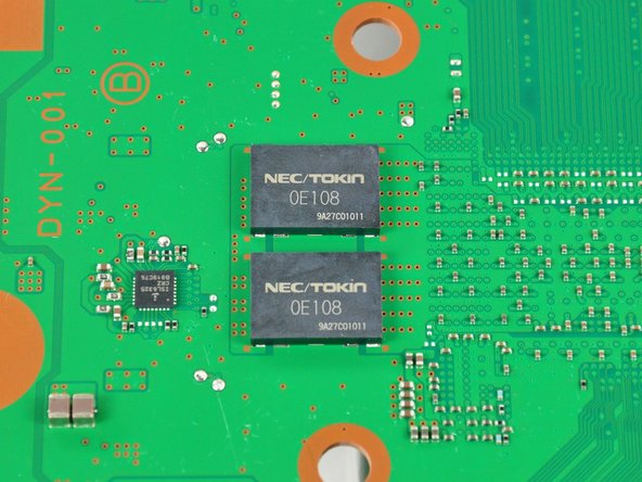

    • Multiple manufacturers, multiple functions. The first picture shows two of the four NEC/TOKIN 0e108 capacitors.
    • NEC/TOKIN Corporation creates "next-generation, value-added devices that integrate." Whatever that means.
    • High Speed Decoupling Device Proadlizer PF/A SeriesProadlizer PF/A Series.
    • Dual Elpida 512Mbit RAM chips (there are four total on the board).

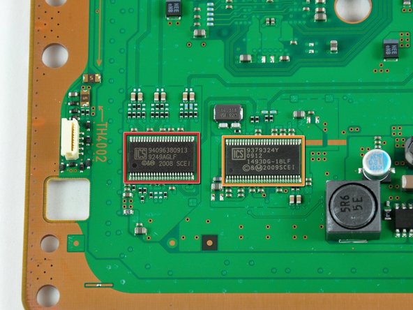

  26. PlayStation 3 Slim Teardown: step 26, image 1 of 2 PlayStation 3 Slim Teardown: step 26, image 2 of 2

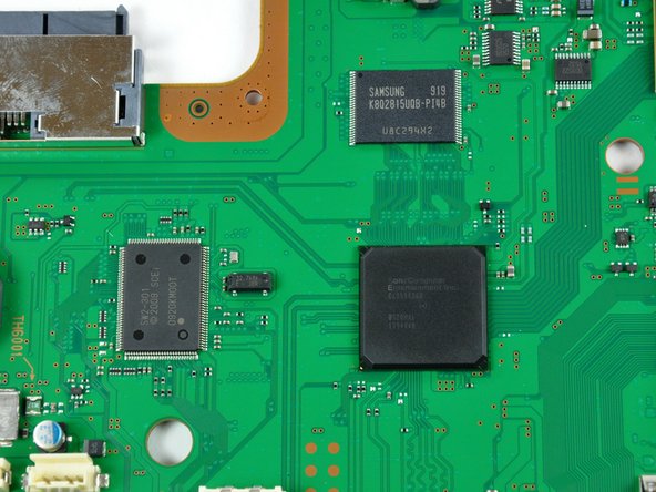

    • But wait -- there's more!
    • Clock generators from left to right:
    • Clock generator (1): ICS 9249AGLF
    • Clock generator (2): ICS 1493DG
    • Samsung K8Q2815UQB-PI4B
    • SW2-301 0920KMOOT
    • Sony CXD9963G8
