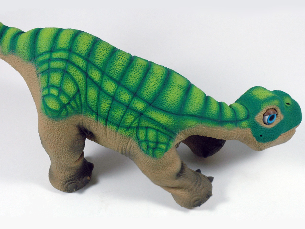

    • We received our Pleo this week, and resisted the urge to take him apart-- but only briefly.
    • We immediately bonded to the little dinosaur. This was the most difficult take apart we've ever done. Disassembling inanimate iPods is one thing, but Pleo was more. Ah, Pleo-- we hardly knew you.
    • Warning: This guide is not for the squeamish. If violence to robotic creatures causes you emotional distress, stop reading now.
  2. Pleo Teardown: step 2, image 1 of 1
    • The obvious place to begin disassembling any organism is the belly. Pleo has two screws on each foot.
    • The battery compartment is in the middle, along with the the USB port and SD slot. There's also a debug port hidden underneath a cover next to the power switch.
    • Pleo came with a USB cable, but it's not clear what it's intended for. Ugobe's instructions for add-ons like their Holiday behavior require a SD card and reader.

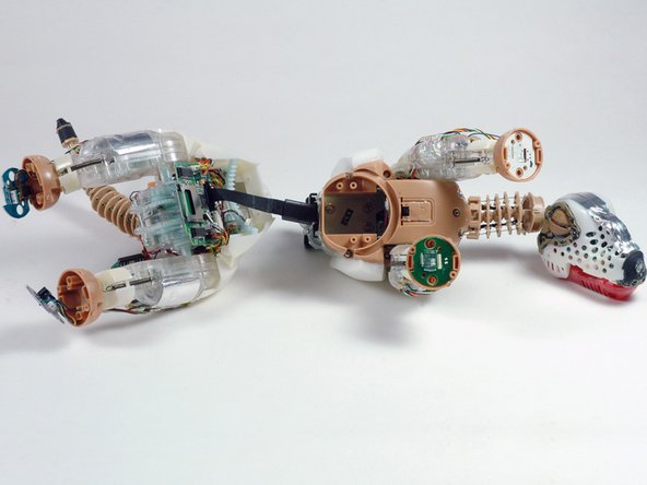

    • The ghost of Pleo.
  18. Pleo Teardown: step 18, image 1 of 1
    • The tail has four wires, and each pair is connected at a gear. One motor can move the tail from side to side and the other moves it up and down. Combining these two movements in varying proportions gives the tail an amazingly flexible range of motion.

    • This is Pleo. Like every life form, he is tremendously complex. We left most of the gearboxes intact, and we still have dozens of components.
    • While we didn't break anything, we're not so sure we can put humpty-pleo back together again. We were pretty attached to him, so we may have to get another one.
    • We have a tremendous amount of respect for the engineering team at Ugobe. We've met them briefly a few times, and they are very eager to push the envelope in human-machine interaction. The cute, friendly exterior of Pleo belies the tremendous complexity required to attain it. Pleo is a surprisingly flexible technology platform, and we're excited to see what third-party programmers can do with it once Ugobe releases their SDK.
    • We are very excited to see what the creators of Pleo give birth to next!
