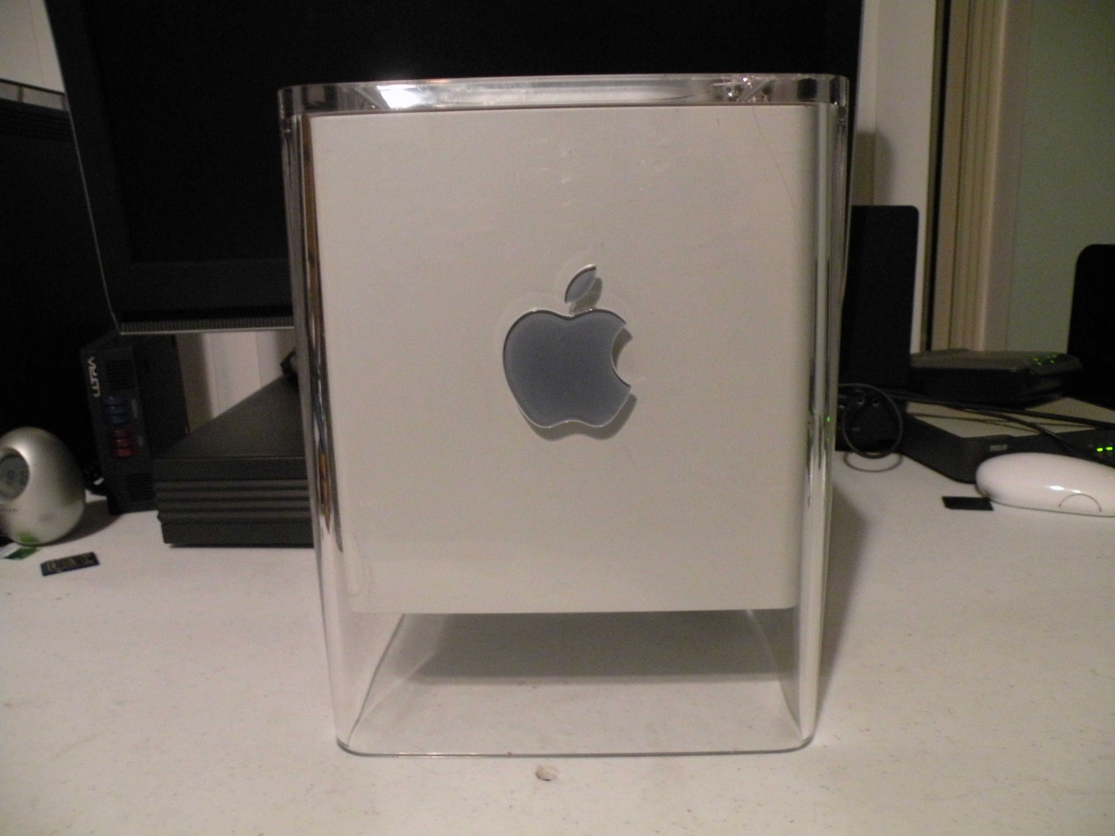

    • The Cube!

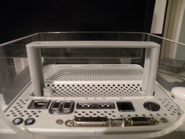

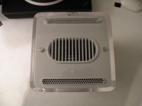

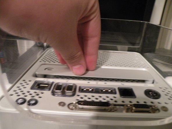

    • To Start The Dissasembly, Flip The Cube Upside-Down, and unplug it.
    • Next, push on the handle, it should pop up.
  3. Power Mac G4 Cube Teardown: step 3, image 1 of 3 Power Mac G4 Cube Teardown: step 3, image 2 of 3 Power Mac G4 Cube Teardown: step 3, image 3 of 3

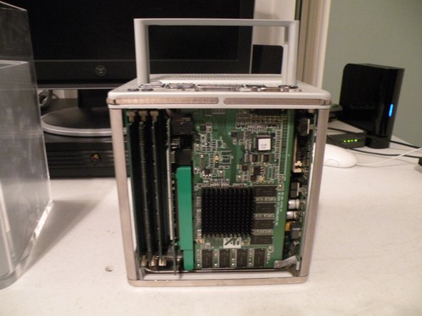

    • Now, pull up on the cube by the handle, all of the guts should come out.
    • As you might notice, the cube's guts only go in one way, the ports facing the back of the enclosure

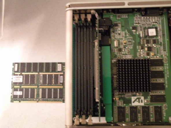

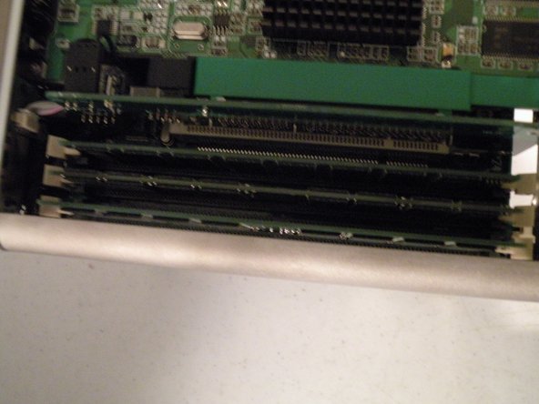

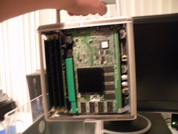

    • Removing the Ram
    • Start by fliping the cube so that the side with the graphics card is facing you, you may want to push the handle back in.
    • There are 3 RAM Slots, they are Standard PC100 Ram. The cube can support up to 1.5GB of ram, that's a 512MB Stick In All 3 Slots.
    • Remove the ram, just like any other kind of ram.

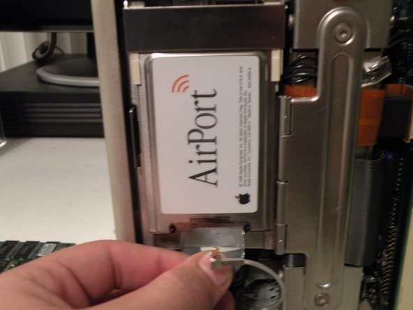

    • Airport Card
    • The Cube Uses the standard PCMCIA 802.11b Airport card commonly found in macs from 1999-2004
    • Flip the cube to the side with the airport card attatched. Remove the antenna cable, then grasp the card by the plastic tab, and pull it out of it's socket.

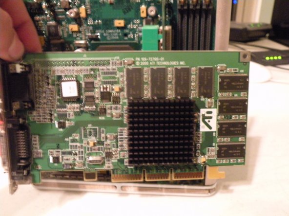

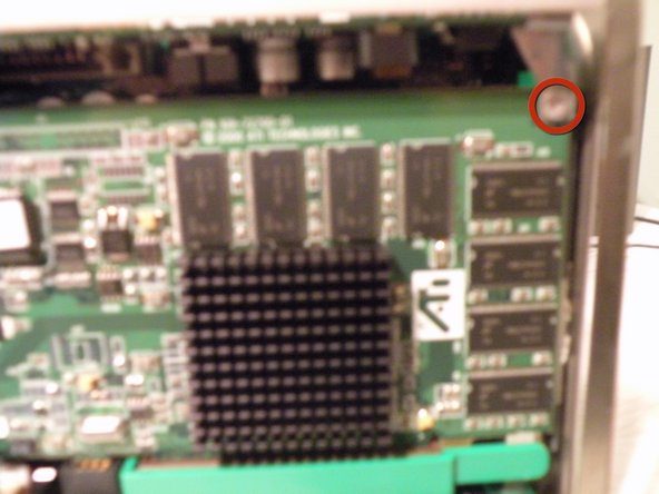

    • The Graphics Card
    • The Cube came standard with a Mac ATI Rage 128 Pro 16MB AGP Card. ATI Radeon (32MB) and nVidia GeForce 2MX (32MB) cards were BTO options.
    • There are few Cube compatible mac cards, due to the cube's small size, heat dissipation limitations, and limited power supply capabilities.

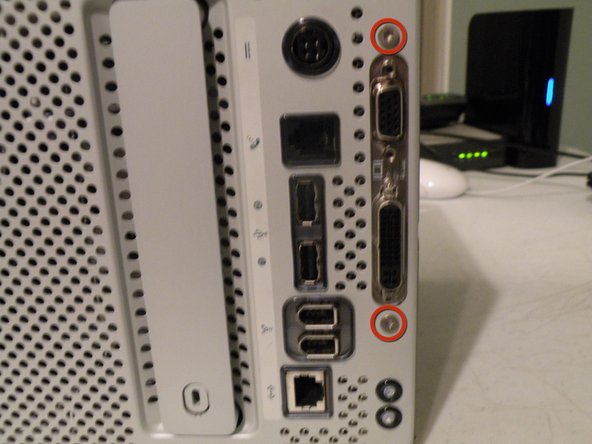

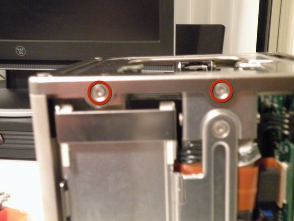

    • Remove these T10 screws:
    • Then, pull the top piece of metal off of the computer,
    • There is a small fragile cable coming from the top if the cube for the power button/LED, before fully removing the piece, unplug this cable from the logic board.

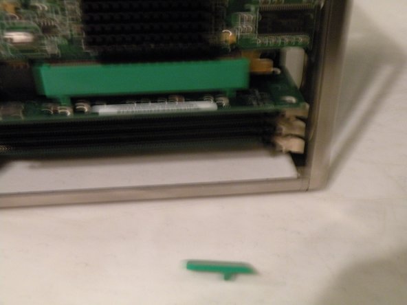

  8. Power Mac G4 Cube Teardown: step 8, image 1 of 3 Power Mac G4 Cube Teardown: step 8, image 2 of 3 Power Mac G4 Cube Teardown: step 8, image 3 of 3
    • Now to free the card, pull this tab towards you and with some persuasion, the card should come free.
    • Oops! Oh well, even without the brittle plastic tab, the card isn't going anywhere.
    • Then, remove the card and set it aside.
