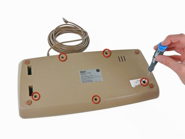

    • A meager five screws are all that hold the two halves of the Studio II together. That's 500% more screws than in the Odyssey 100, but half the screws required to open the top cover on a PS3 Slim.
    • Lifting off the bottom cover reveals...

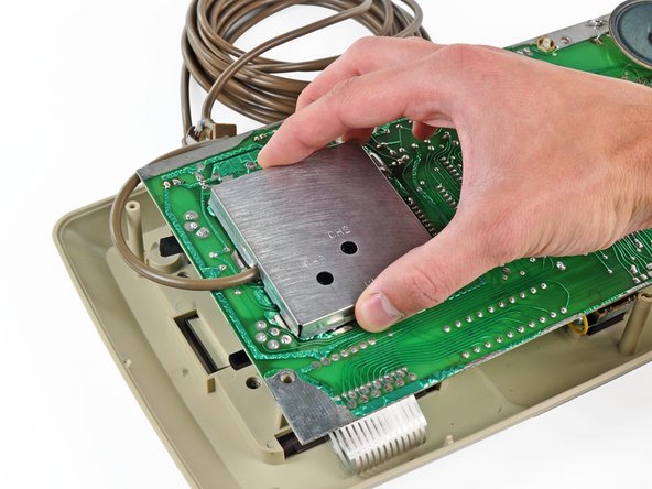

    • Ooo, a metal cover. Must be something interesting under there...
    • ...Or not. The shield covers the radio frequency section on both sides, and prevents interference from being broadcast.
    • The Studio II's singular 18-foot-long [seriously] I/O cable is soldered right to the board. Who needs connectors anyway?

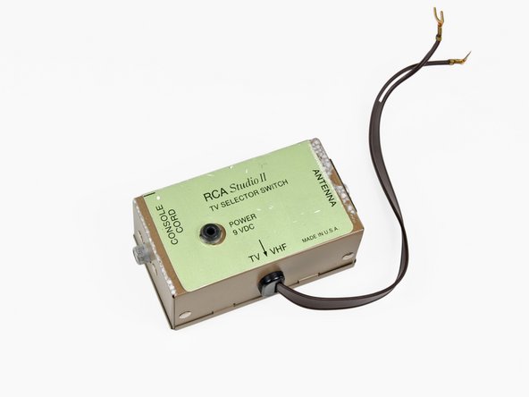

    • Speaking of the I/O cable, here's the Studio II's RF switch.
    • The Studio II has no power button on the unit; instead, it employs a unique method of powering on. When you select "Console Cord" on the RF switch, power goes into the Studio II and data is fed to the TV set. When you select the "Antenna" on the RF switch, the unit powers off and your antenna signal is routed to the television set.
    • And inside the RF switch? Some capacitors and inductors that were undoubtedly hand-assembled.
