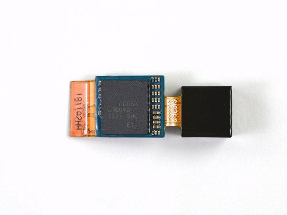

Before diving in any further, we take a brief moment to admire the 8.0 megapixel rear-facing camera and microSD slot.

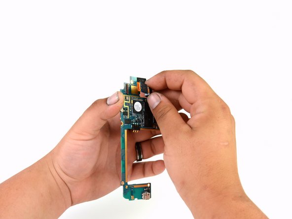

After freeing a few more Phillips #00 screws, a handful of connectors, and a sticker from the firm grips of the Epic 4G's Touch, off comes the motherboard.
Cool your soldering stations everybody, we are pleased to announce that the device doesn't house a smorgasbord of EMI shields and that its single EMI shield is removable with only a few gentle pries.
The front side of the motherboard contains the following major chips:
Toshiba TC31501AAMBG WiMax package. According to Chipworks, "This device operates in the 2.5GHz frequency band and offers high-speed connectivity in the mobile environment with low power consumption." (Thanks guys!)
Broadcom BCM4330XKFFBG 802.11 a/b/g/n MAC/Baseband/Radio with Integrated Bluetooth 4.0+HS and FM Transceiver/Receiver
Maxim MAX8997 Power Management IC
WIP4255H
Avago CFI120 223713
Maxim MAX8893C Power Management IC
We continue identifying the chips located on the rear-side of the motherboard:
Samsung K3PE7E700B-XXC1 Dual-Core 1.2 GHz Processor
Samsung Electronics Corporation (SEC) K521H12ACE
Samsung KLMAG4FEJA-A003 16 GB Flash Memory
Avago ACFM-7325 Band Class 14 PCS/Band Class 10 Cellular Band Quadplexer
Qualcomm QSC6085 CDMA Processor
Silicon Image 924480
Yamaha YMU823 Audio Codec

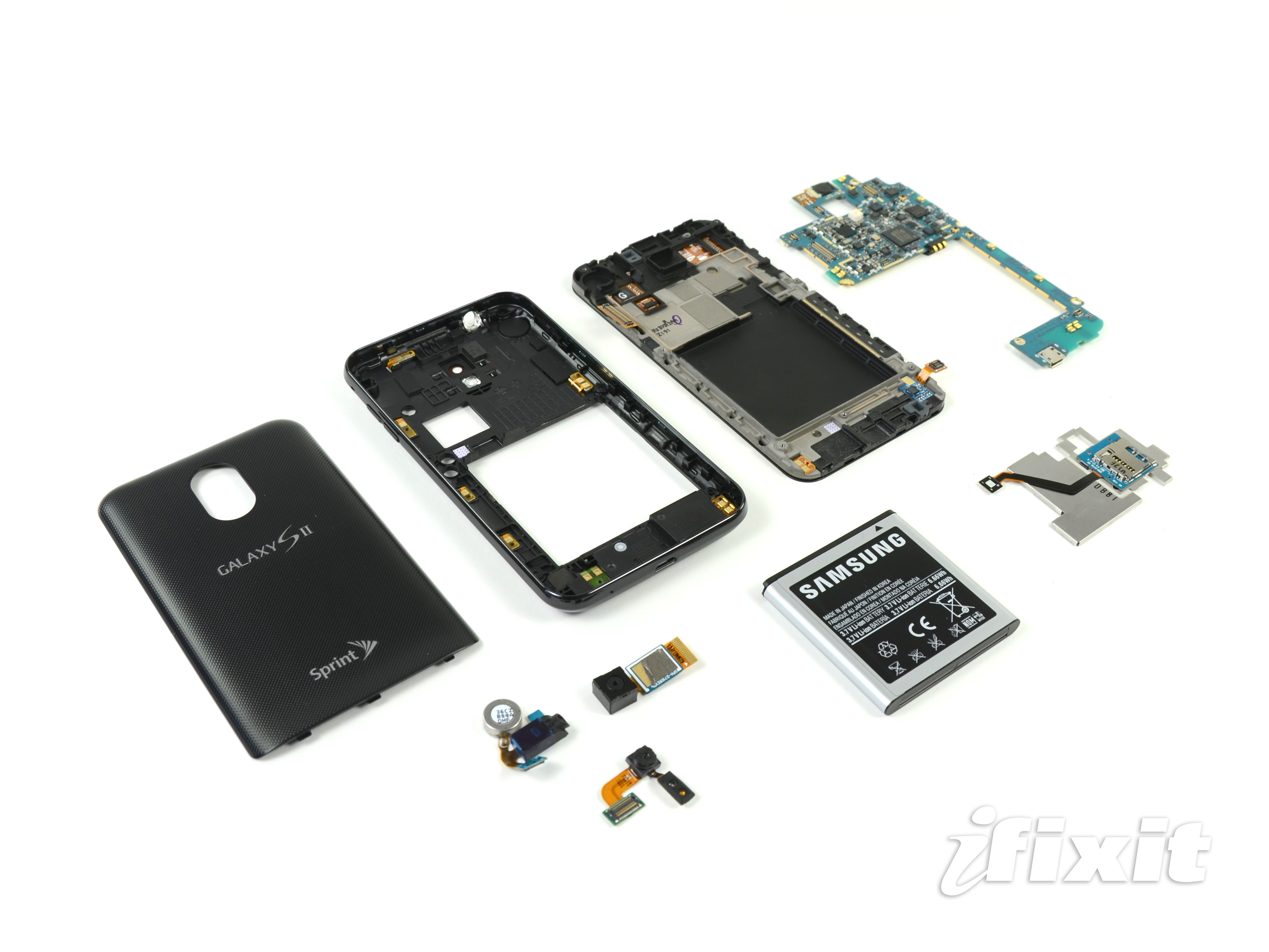

Samsung Epic 4G Touch Repairability Score: 7 out of 10 (10 is easiest to repair).
Battery and microSD card can be accessed by simply removing the back cover.
There's a total of 9 Phillips #00 screws to remove to gain access to the majority of the device.
Most of the disassembly was straightforward and easy, and accomplished with standard tools.
Some components share the same ribbon cable (front-facing camera and ambient light sensor, for example), thereby increasing repair costs.
Speaker is soldered to the motherboard, making replacement more difficult.
Glass panel and Super AMOLED Plus display are fused, making cracked screens a costly repair (and requires the use of a heat gun).
