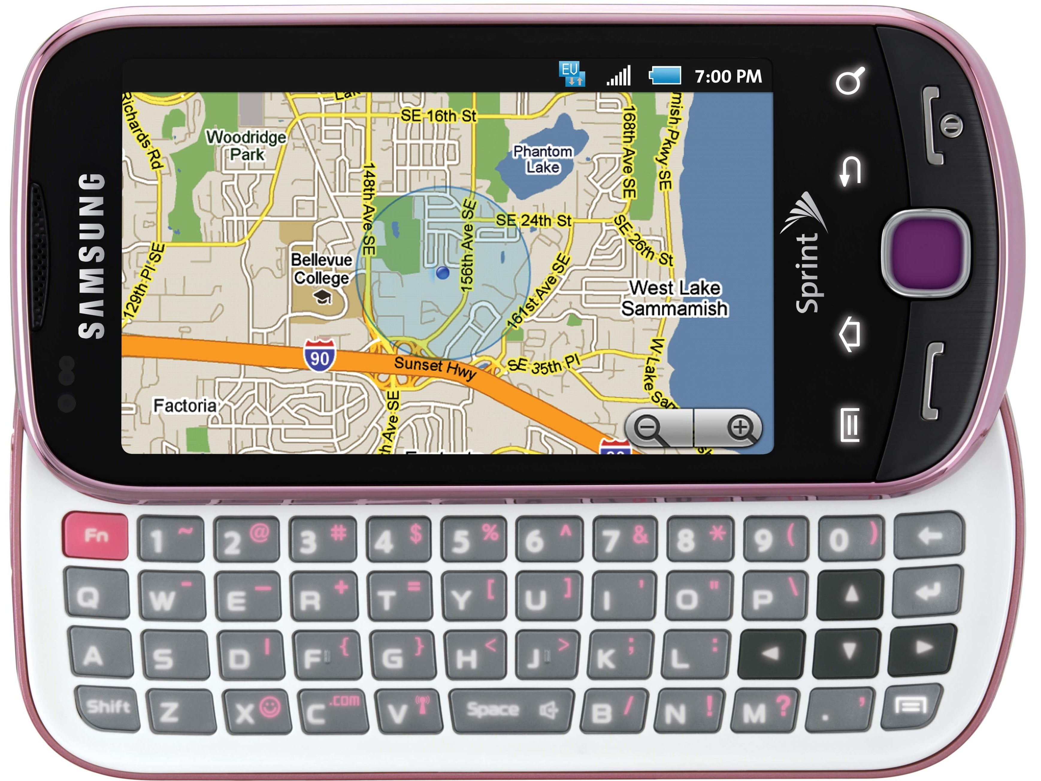

This teardown is not a repair guide. To repair your Samsung Intercept, use our service manual.
  1. Samsung Intercept Teardown, Samsung Intercept Teardown: step 1, image 1 of 1
