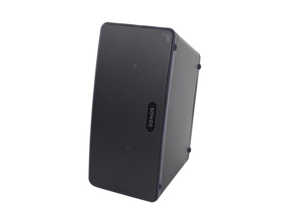

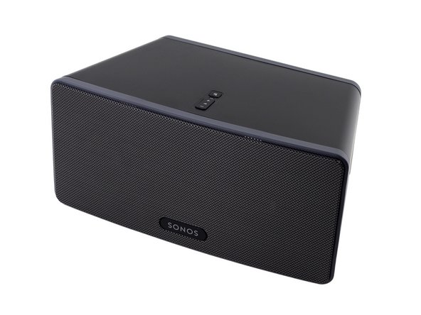

    • Ladies and gentlemen, allow us to introduce the Sonos Play:3 all-in-one wireless* music player.
    • *Amazon puts it best: The Play:3 "easily connects to your wireless router with included Ethernet cable or wirelessly anywhere with addition of Sonos Bridge." So if you want to use it wirelessly, you'll need to shell out another $50 for the Sonos Bridge. Otherwise, Ethernet's the only way to connect to it.
    • What exactly does this all-in-one music player contain? We're glad you asked:
    • Three Class-D digital amplifiers
    • Three-driver speaker system—two mid-range woofers and a tweeter
    • A classy grey box that works both horizontally or vertically

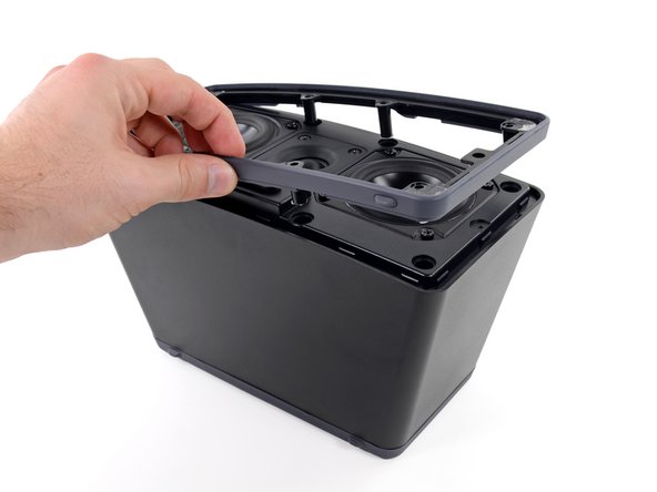

  3. Sonos Play:3 Teardown: step 3, image 1 of 3 Sonos Play:3 Teardown: step 3, image 2 of 3 Sonos Play:3 Teardown: step 3, image 3 of 3

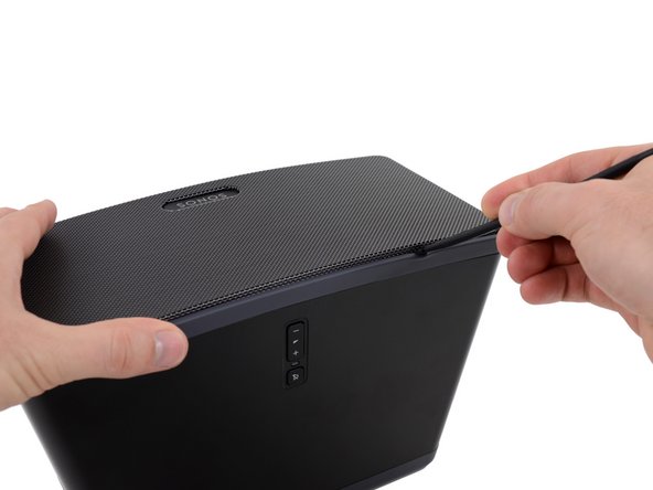

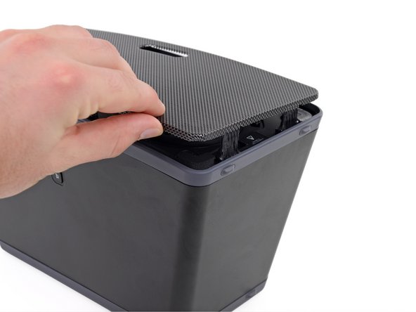

    • A flick of our spudger allows us to remove the speaker grille with relative ease, although the gooey adhesive on the perimeter clips was reluctant to let go.
    • Our first peek inside reveals exactly what we expected—speakers!

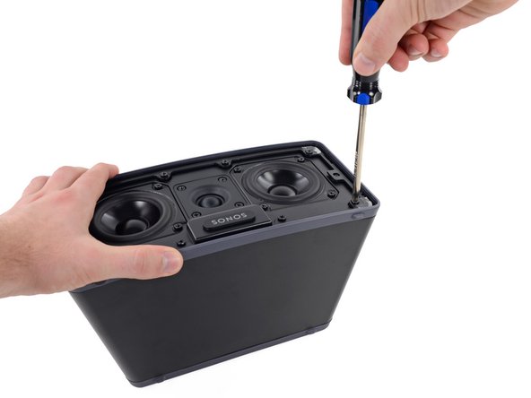

  4. Sonos Play:3 Teardown: step 4, image 1 of 3 Sonos Play:3 Teardown: step 4, image 2 of 3 Sonos Play:3 Teardown: step 4, image 3 of 3

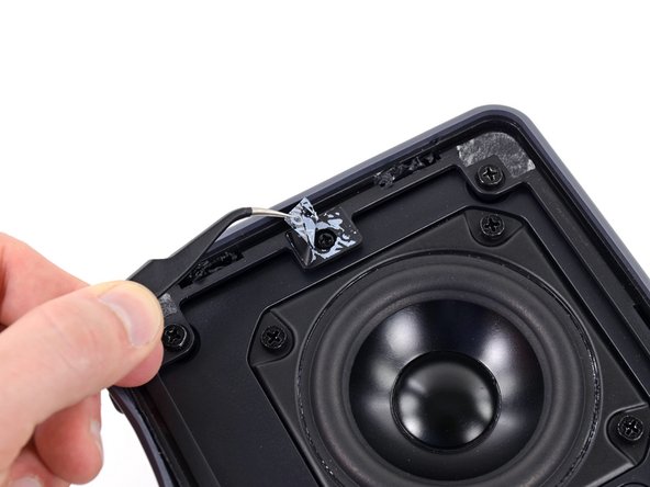

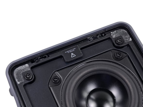

    • What do we have here? If it isn't our good friend, the "Warranty void if opened" sticker.
    • Alas, cousin, we hardly knew ye.

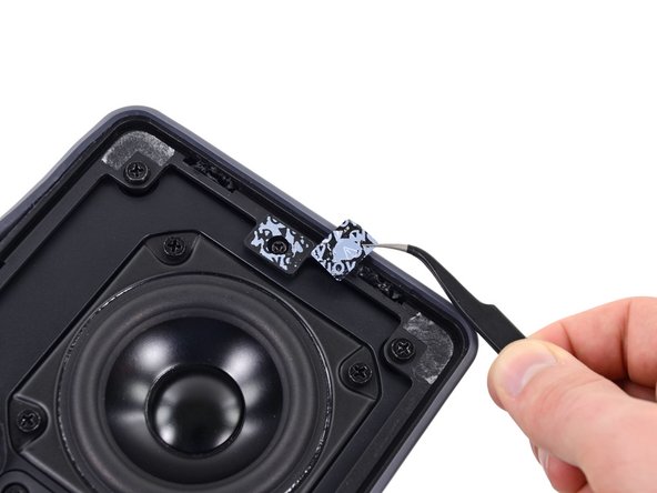

    • Just as we thought, there is a hidden screw located underneath the "you shall not pass" sticker.
    • The fragile sticker comes off easily, but leaves its impression on the front bezel: a repeating pattern of the word "VOID." It seems Sonos doesn't want users servicing their own players
  5. Sonos Play:3 Teardown: step 5, image 1 of 2 Sonos Play:3 Teardown: step 5, image 2 of 2
    • Well, here's a tool we don't normally get to take out of our armory, the beefy Phillips #2 screwdriver.
    • While our bit driver kits come equipped with a #2 bit, the small driver will leave you with some very buff forearms.
    • Ten screws later, the front bezel is on its way out.

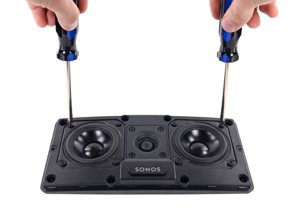

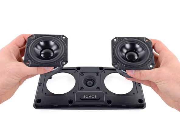

  7. Sonos Play:3 Teardown: step 7, image 1 of 3 Sonos Play:3 Teardown: step 7, image 2 of 3 Sonos Play:3 Teardown: step 7, image 3 of 3
    • How difficult is it to replace the two mid-range drivers and the one tweeter? Not very difficult. Each is held in by four Phillips screws, for a total of twelve to pull out the trifecta of music-emitters.
    • With these speakers out of the front panel, maybe we can drop something a little larger in there.

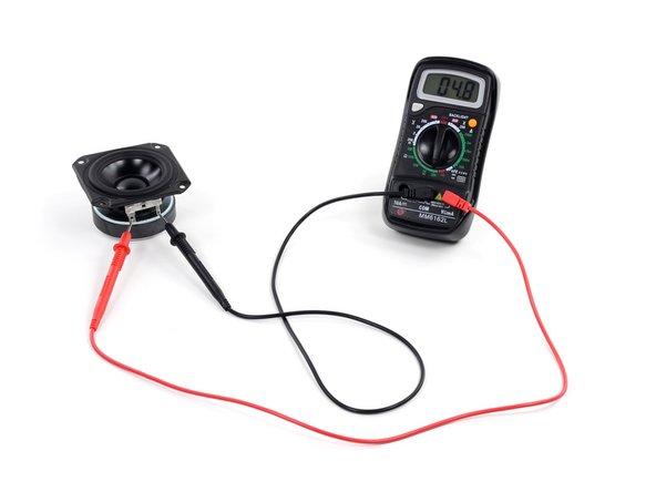

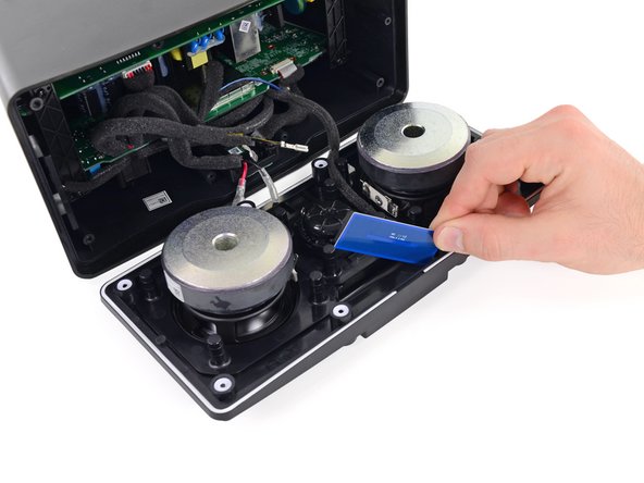

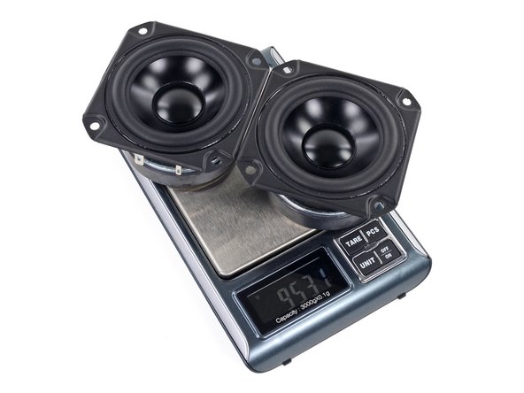

    • The mid-range drivers have pretty impressive permanent magnets, accounting for 37% of the device's total 5.7 lbs.
    • Want more specs on the speakers? So did we. Since Sonos is hush-hush about them, we decided to do some poking and prodding of our own. Here's what we came up with:
    • 2 ¾" mid-range drivers (2" composite speaker cones)
    • 4.8 Ω measured resistance
    • 1" silk dome tweeter
    • 3.7 Ω measured resistance (tweeter)
    • Why do we stress that these are measured resistances? While speaker ratings are given in ohms, the unit of resistance, they're actually values of impedance, which is dependent on the specific frequency being played. Home stereo speaker impedances are usually 8 Ω, but because a multimeter can only read resistance, our measurement will be lower.

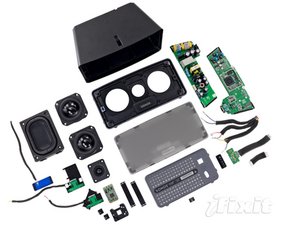

    • With the motherboard removed and stripped down, we finally get to see the control behind the music. The following prominent ICs power this device:
    • MPC8314VRADDA low-power PowerQUICC II pro 266 MHz processor
    • STMicroelectronics NAND 512W3A2SN6
    • Nanya NT5TU32M16DG-3C 512 Mb DDR2 RAM
    • STMicroelectronics STA339BW 2.1-channel high-efficiency digital audio system, capable of outputting 2 x 20 W into 8 Ω at 18 V (we assume these two chips make up the "three class-D digital amplifiers" listed on Sonos' website)
    • Maxim 78Q2123 10/100 fast ethernet MicroPHY
    • HanRun HY601680 10/100Base-T transformer module
    • On the back: Texas Instruments TPS54226 4.5 V to 18 V input, 2 A synchronous step-down SWIFT converter

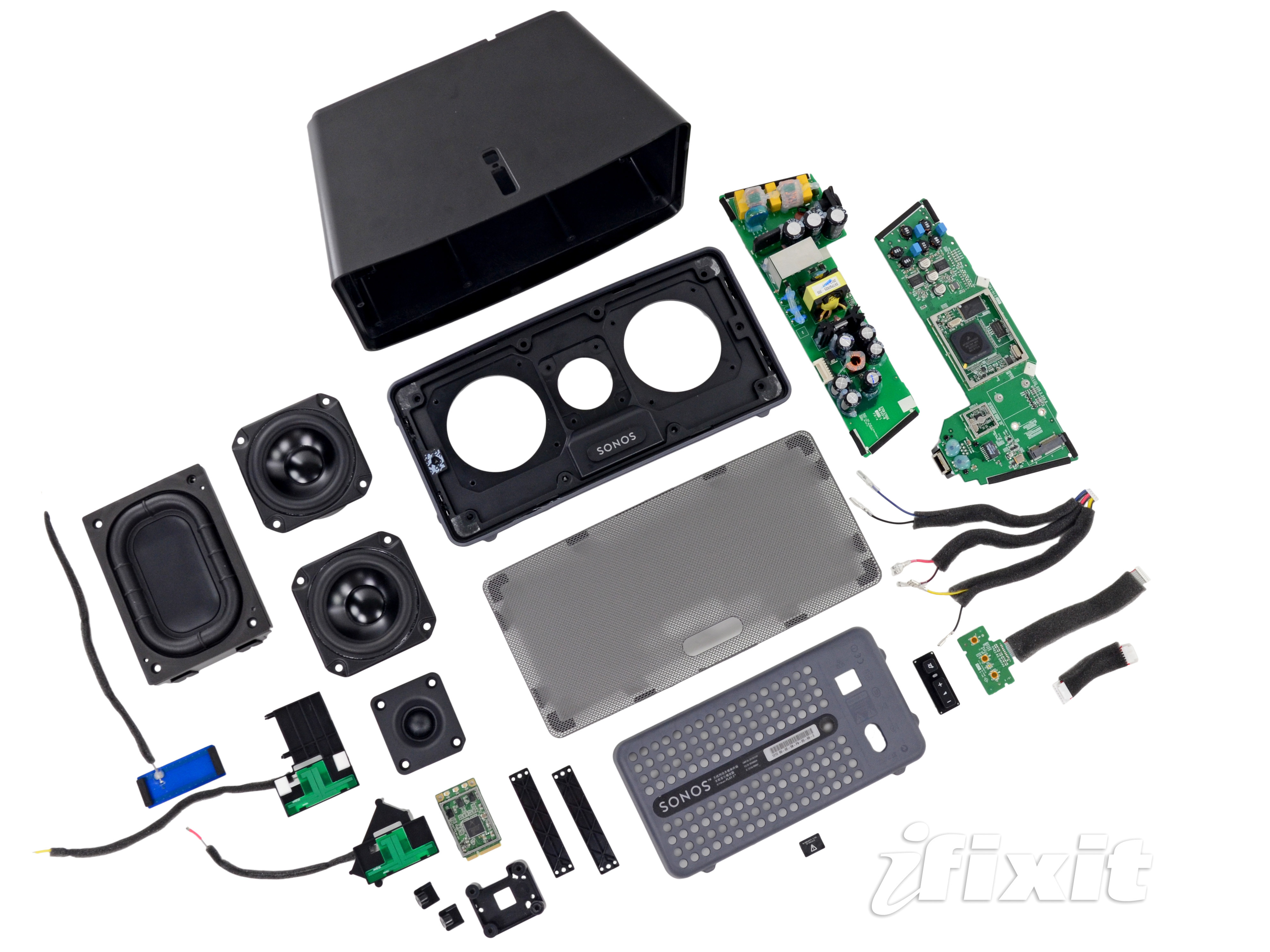

    • Sonos Play:3 Repairability Score: 8 out of 10 (10 is easiest to repair)
    • All major components are held in place with Phillips screws, many of them the same size.
    • The entire disassembly is pretty straightforward.
    • Modular design means that nearly every component can be replaced individually.
    • Glue and adhesive are not impossible to overcome, but definitely need to be reapplied to dampen vibrations.
    • A "warranty void" sticker stands between you and any repairs.
