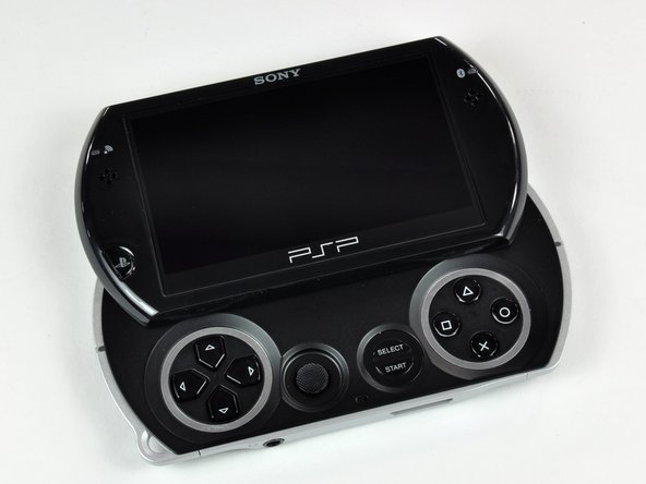

    • Such an elegant backside... But where is the UMD drive? Let's have a moment of silence. R.I.P. UMD drive, we hardly knew ye.
    • The PSP Go measures at 128 x 16.5 x 69 mm and weighs in at 5.6 oz (including the internal battery).
    • Unlike previous PSP models, the PSP Go makes do with 16 GB of internal flash memory.
    • Oooooh it slides up to reveal the gamepad!

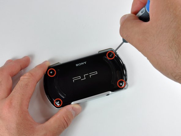

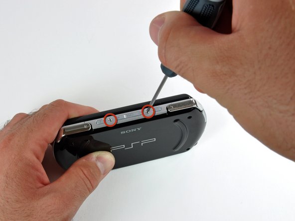

    • Removing the necessary screws required to gain access into the innards of the PSP Go.
    • On this device, all screws are readily accessible and use a common Phillips #0 head. No hidden tabs or tri-wing screws here.
    • With a non-soldered battery and Phillips head screws, why doesn't Sony approve of DIY battery replacement?
    • We can think of only one reason: it starts with "cha," and ends with "ching." That's right, the sound of the cash register.

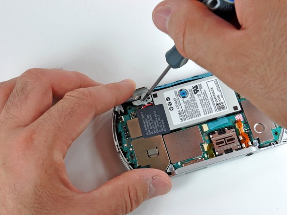

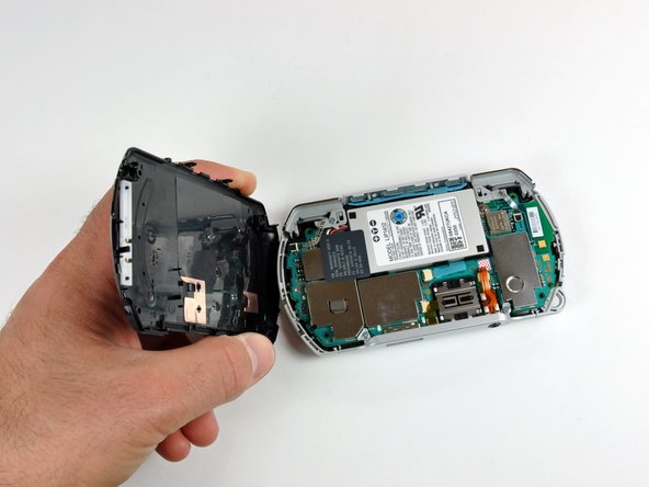

    • A simple flick of a PSP opening tool and presto!
    • Ladies and Gentlemen, behold! The inside of the PSP Go.
    • Unlike the Zune HD or the iPod Classic, the Go uses no metal internal framework. In fact, it has no internal framework; all structural integrity is provided by the plastic outer cases.

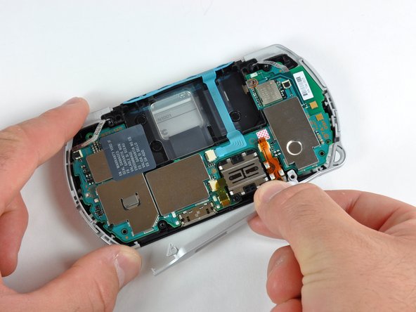

    • We begin our dissection by disconnecting a few connectors and removing a couple screws.
    • It was clear the board wouldn't come out without first removing the triggers. So we decided to start with the left trigger button.
    • The trigger button ribbon cables are connected to the board with ZIF connectors; a careful flick with the PSP opening tool released the clamp and freed the ribbon cable.

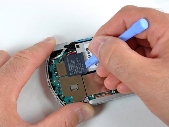

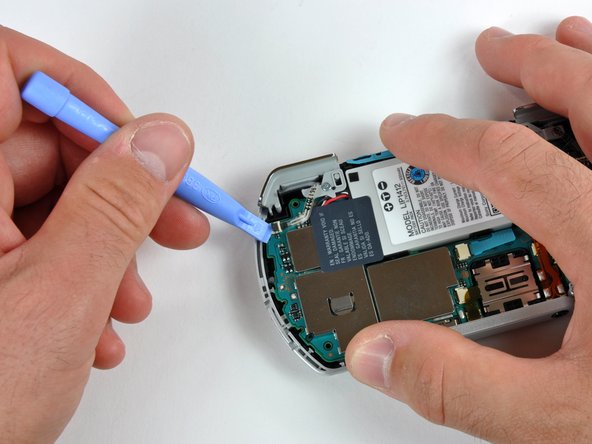

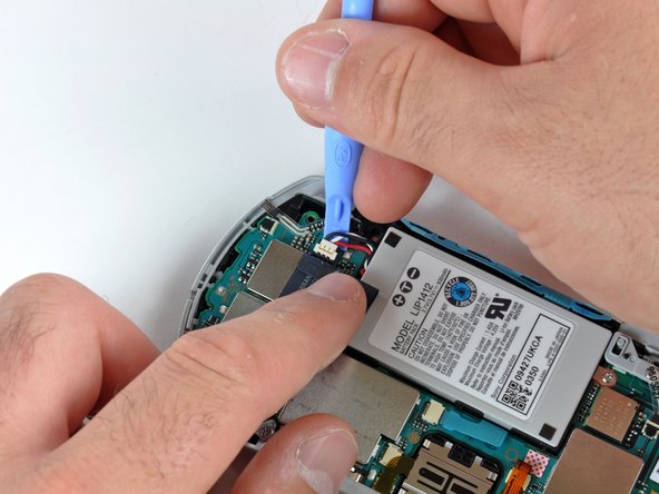

    • Firmly stuck to the battery is a trilingual Warranty Void seal. They really covered all bases with this one, as long as you know English, French, or Spanish.
    • Good news: the battery is not soldered to the board.
    • Bad news: unfortunately, you have to peel the warranty sticker back to remove the battery.
    • But more good news: if you're careful, you can remove the battery without disturbing the "VOID" portion of the seal, but we didn't tell you that.
    • Just slide a PSP opening tool in between the battery and sticker. Work your way gently side-to-side, until the battery is free from the sticker. Presto-changeo!

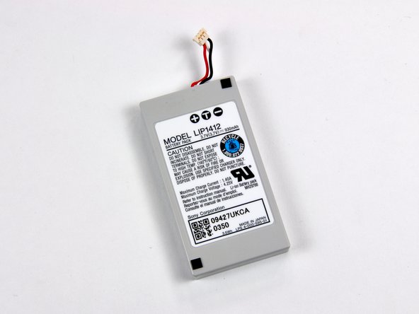

    • The battery's a Li-ion 3.7V, 930 mAh, 3.5Wh unit.
    • Here's how the three major handheld gaming devices stack up in the battery department:
    • PSP Go: 930 mAh, unofficially user replaceable
    • DSi: 840 mAh, officially user replaceable
    • iPod touch 3rd Gen: 789 mAh, unofficially user replacable, requires difficult soldering
    • The PSP wins on capacity, and the DSi wins on serviceability. The touch, well, if you can't say something nice...

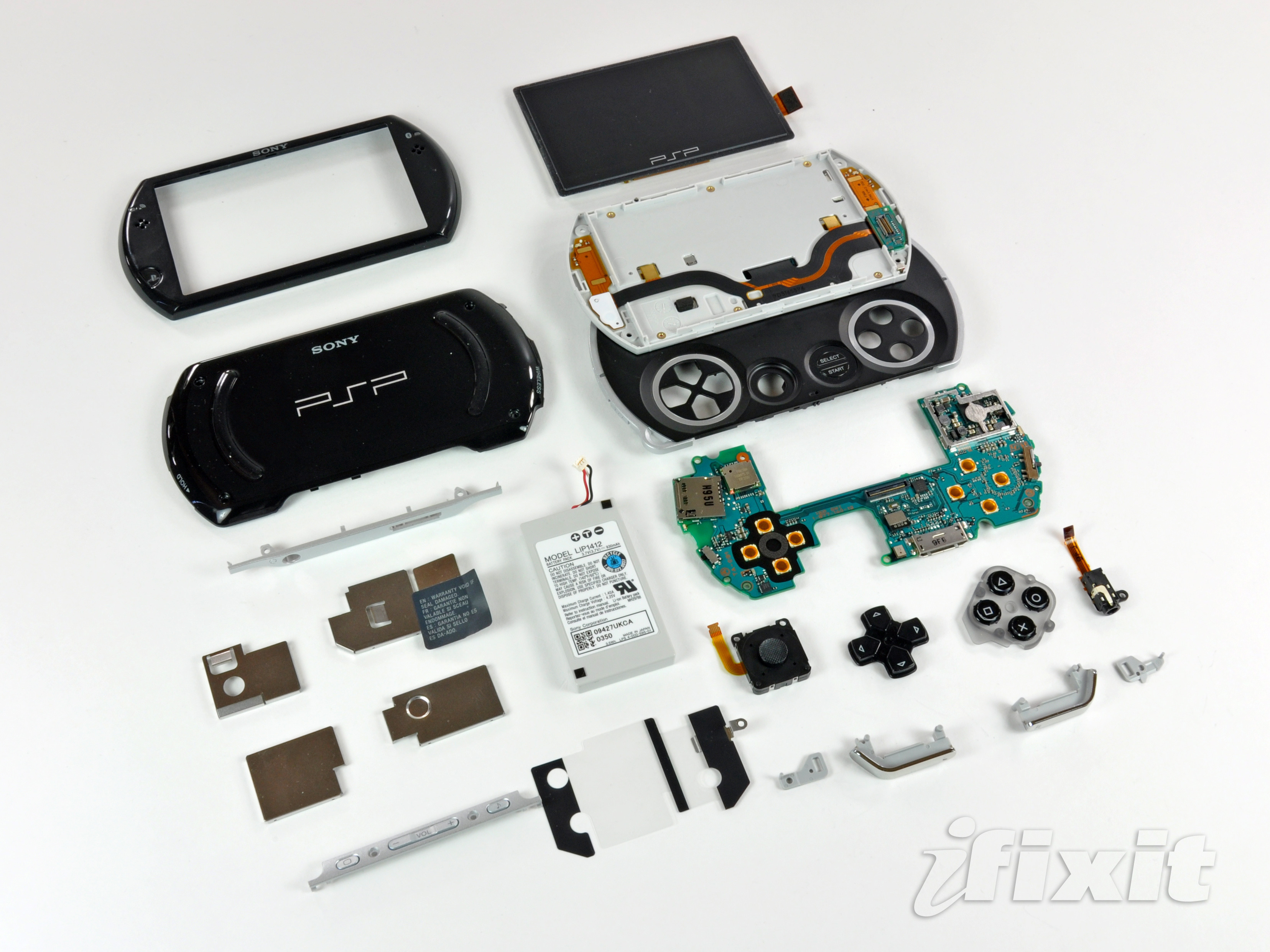

    • And there you have it: the Go in pieces.
    • Curious how the PSP stacks up the the handheld gaming competition on the inside? We have both a DSi teardown and an iPod touch teardown.
