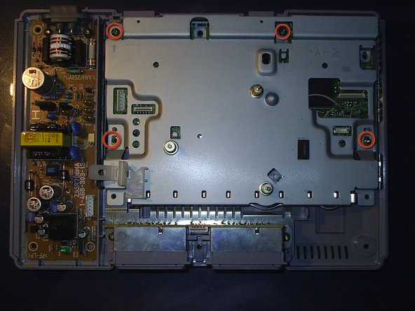

  6. Sony PlayStation SCPH-9002 Teardown: step 6, image 1 of 1
    • Remove the four screws and the metal cover.
  7. Sony PlayStation SCPH-9002 Teardown: step 7, image 1 of 2 Sony PlayStation SCPH-9002 Teardown: step 7, image 2 of 2
    • Now you have the motherboard!
    • And the power supply.
    • Remove the four screws from the motherboard and the power supply.
