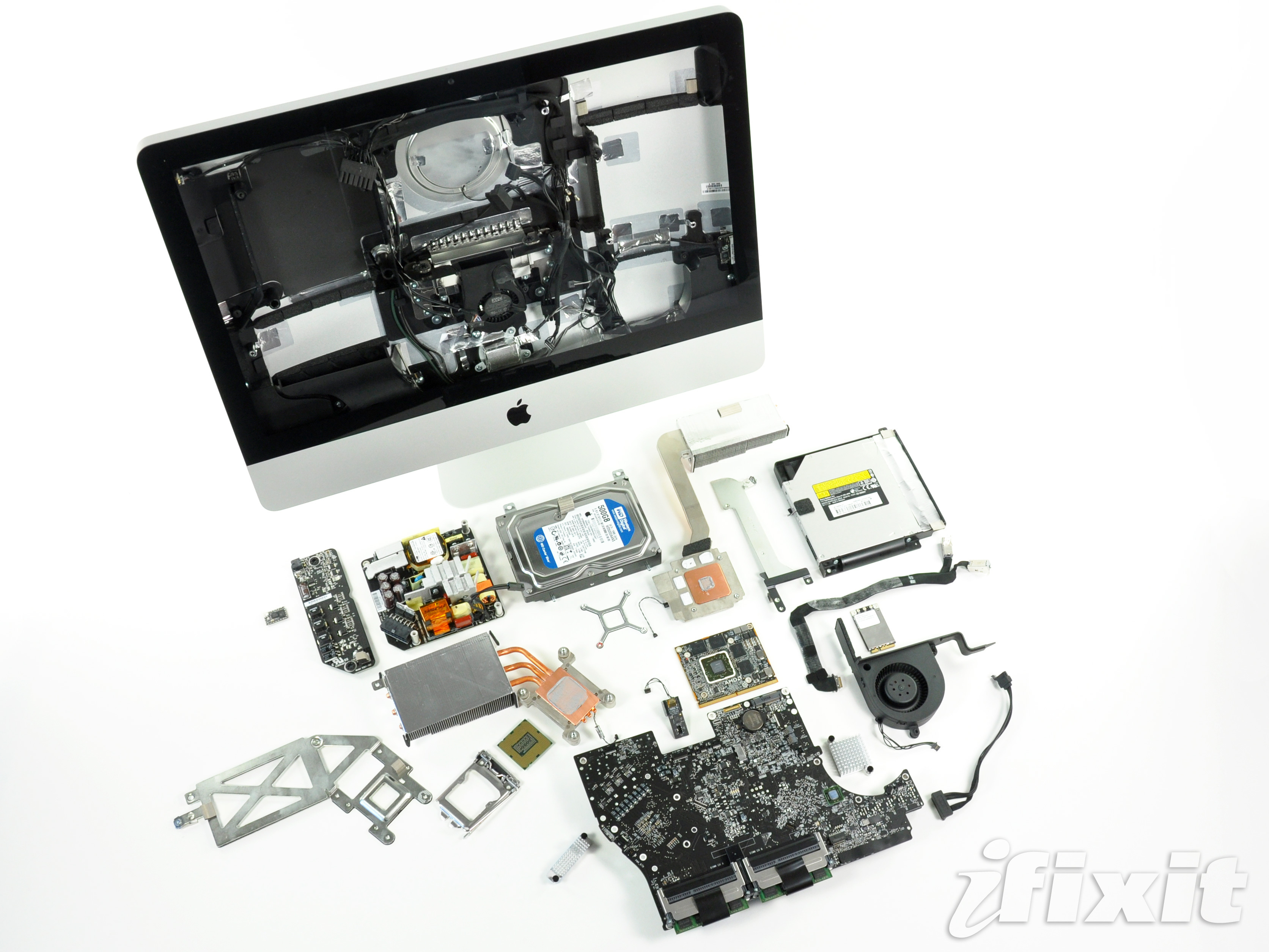

    • In the next few steps, we remove many components that are very similar to the last 21.5" iMac.
    • The WD Caviar Blue hard drive is held to the front bezel by a few screws and, as always, the SATA data/power connectors.
    • The WD Caviar Blue drive is a non-standard SATA drive. The power connector features 7 pins, rather than the standard 4. The drive also has non-standard firmware. This means you can only use Apple's own hard drives and not any standard after-market SATA drive.
    • Removing the power supply requires disconnecting the AC inlet cable from the logic board.
    • The LED driver board comes out next after successfully removing the power supply.
  8. iMac Intel 21.5" EMC 2428 Teardown: step 8, image 1 of 3 iMac Intel 21.5" EMC 2428 Teardown: step 8, image 2 of 3 iMac Intel 21.5" EMC 2428 Teardown: step 8, image 3 of 3
    • Good-bye optical drive, we hardly knew ye...
    • The new iMac carries a Sony Optiarc optical drive, model number AD-5690H.
    • The area shaded in red in the third picture is presumably where the optional SSD is housed. The three mounting points within the shaded area have nothing attached to them in our machine, since this option is only available on 2.7 GHz 21.5" iMacs.

    • Is it just us, or does the logic board layout (with heat sinks) look a bit like the original Starship Enterprise?
    • In usual Apple fashion, one heat sink is reserved for the CPU, while the other oversees the GPU.
    • And, in usual Apple fashion, you have to void the warranty in order to get a peep at the processing power underneath.
    • In the RAM department, this iMac has space for four 204-pin PC3-10600 SO-DIMM chips.
