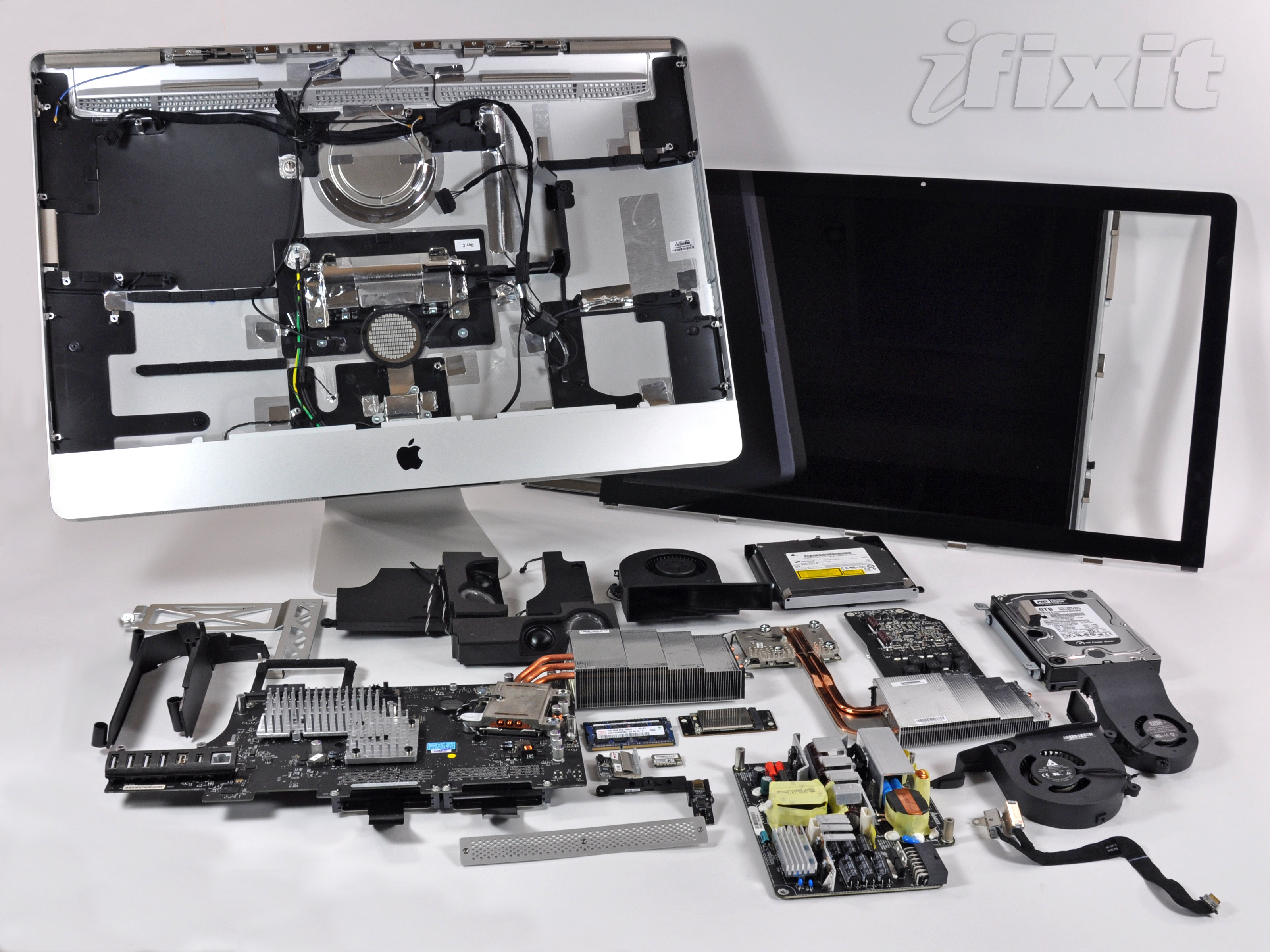

  24. iMac Intel 27" EMC 2309 and 2374 Teardown: step 24, image 1 of 1
    • After such a tedious teardown, you can't blame us for just piling everything up into one ginormous heap of parts.
    • However, curse our guilty conscience, being the nice and awesome professionals we are, we felt an urge and a slight sense of responsibility to do it right.
    • The final layout picture for all to see. Enjoy!
