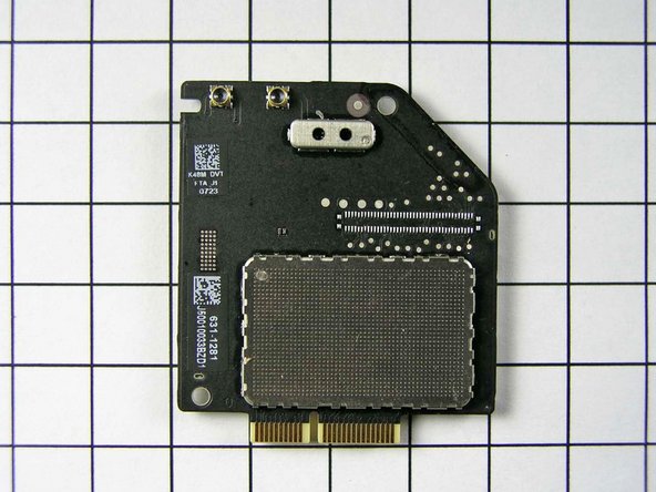

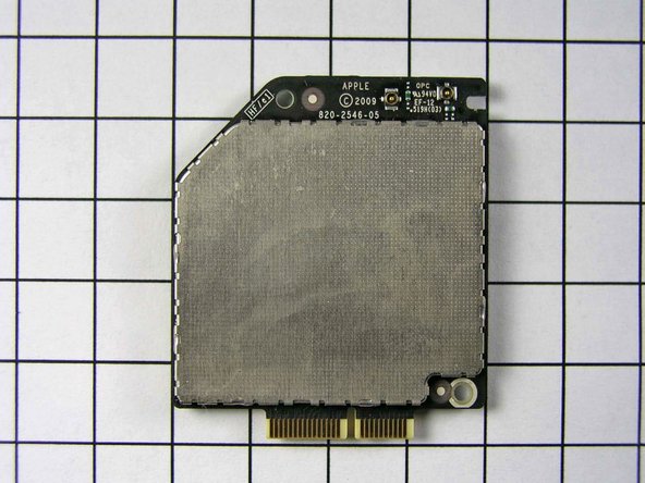

  16. iPad FCC Teardown: step 16, image 1 of 3 iPad FCC Teardown: step 16, image 2 of 3 iPad FCC Teardown: step 16, image 3 of 3
    • A shot of the 3G communications board.
    • The connector is 25 pins total; a group of 15 and a group of 10.
    • Unfortunately, no, this doesn't mean you just drop this card into your iPad to add 3G. The 3G connectivity requires extra antennas and a modified rear casing.

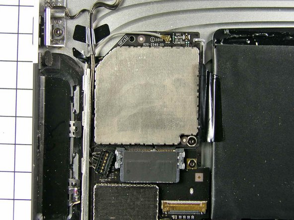

  17. iPad FCC Teardown: step 17, image 1 of 1
    • The iPad 3G has a black plastic strip along the top edge of the rear case for transmission of signals. The large black plastic piece at the top of this picture is the 3G antenna assembly.
    • The odd looking structure boxed in red is what the 3G chip and possibly the logic board are fastened to. It is resistance welded to the rear case and probably serves as a ground point for the boards attached to it.
