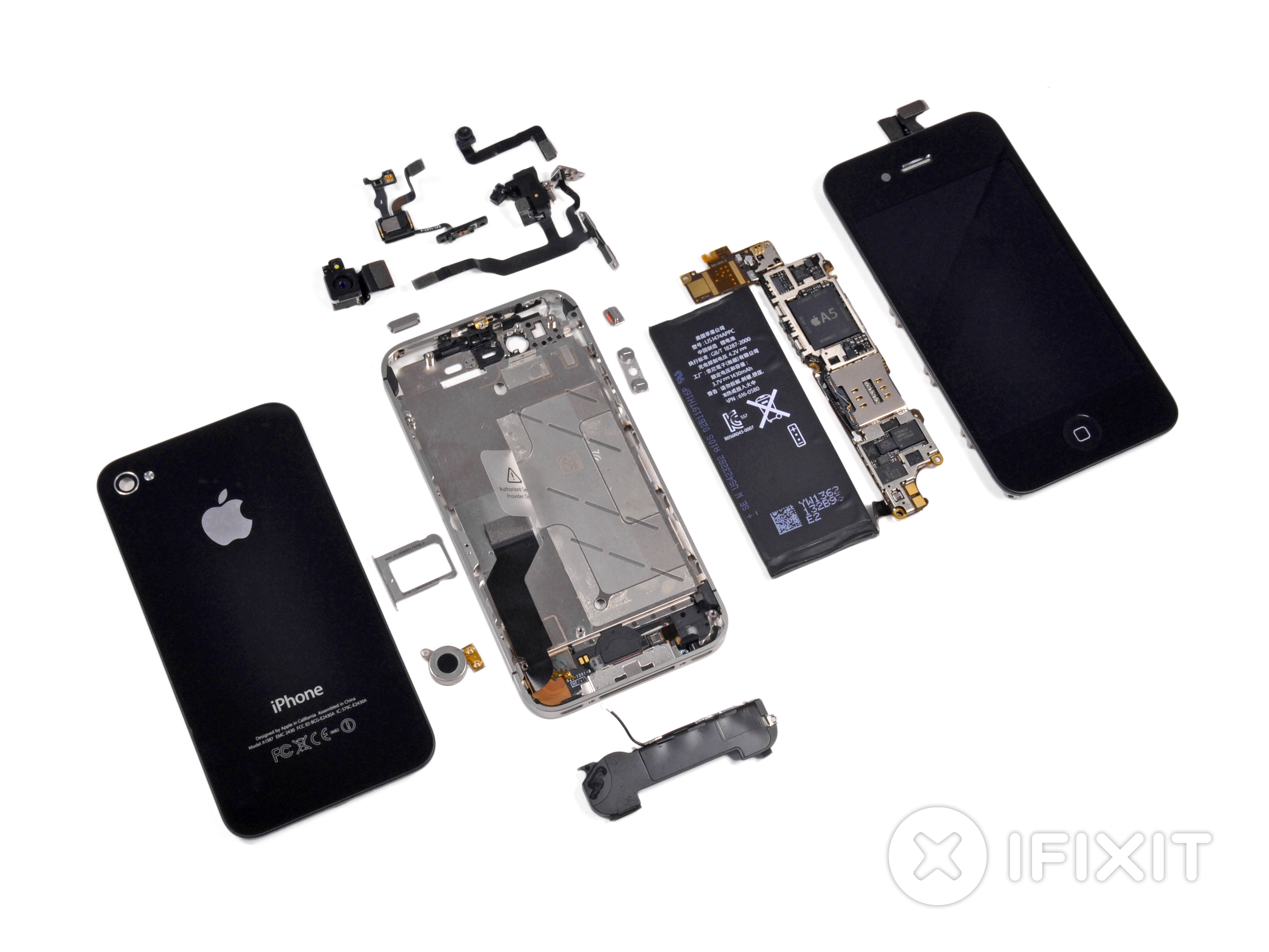

    • Let's see what's on the other side. Siri, roll over... Thank you.
    • Qualcomm MDM6610 chipset (an upgrade from the iPhone 4's MDM6600)
    • Apple 338S0973, which appears to be a power management IC, according to Chipworks.
    • Reading the covered chip at an angle reveals "PM8028," which is a Qualcomm power management IC.

    • Taking self portraits a la Myspace Facebook Google+
  19. iPhone 4S Teardown: step 19, image 1 of 2 iPhone 4S Teardown: step 19, image 2 of 2
    • We have reached the end of our journey. We are happy to announce that not a single trace of any Cyberdyne Systems components were found...it seems for the time being our judgment day is not upon us.
    • iPhone 4S Repairability Score: 6 out of 10 (10 is easiest to repair). Very little has changed from the iPhone 4 in terms of repairability.
    • The iPhone 4S is still held together primarily with screws and limited adhesive.
    • The rear panel and battery are both easy to remove and replace (provided you have the correct screwdriver).
    • Apple is again using Pentalobe screws to secure the rear panel and keep people out
    • The LCD and glass -- a carryover from the previous generation -- are fused together, making cracked glass repair more costly.
