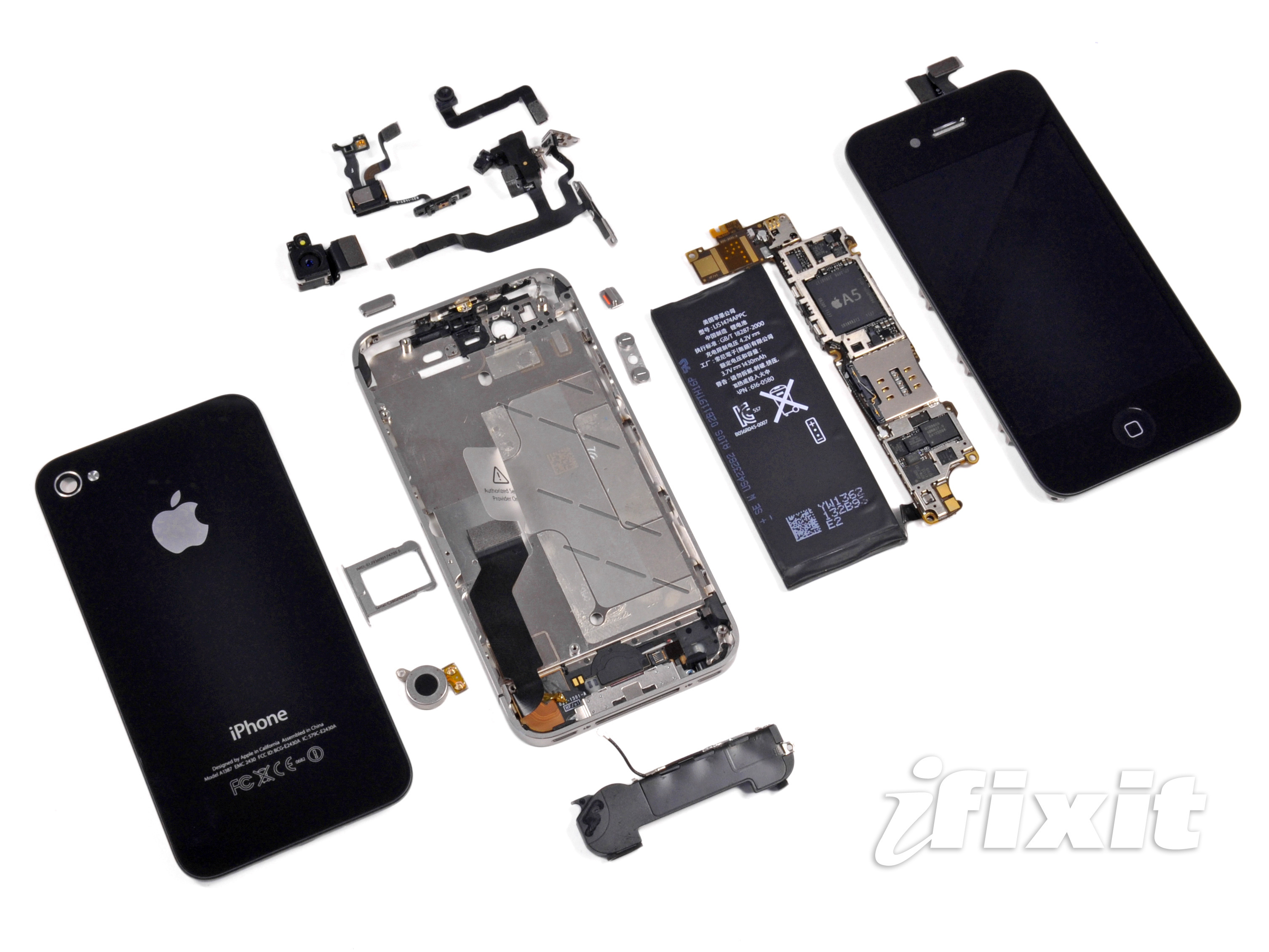

    • You asked, we delivered! The new iPhone 4S steps up to the grandest stage of them all, and iFixit is here to expose it.
    • The tech specs:
    • Apple's A5 System-on-a-Chip: 1 GHz Dual-Core Processor
    • 8 MP Rear-Facing (1080p Video Capture) + VGA Front-Facing Cameras
    • 802.11 b/g/n + Bluetooth 4.0 (oo-la-la!)
    • LED Backlit IPS TFT LCD Retina Display with a resolution of 960 x 640 pixels
    • Quad-band GSM/GPRS/EDGE + Dual-band CDMA/EV-DO Rev support (World phone)

    • We have reached the end of our journey. We are happy to announce that not a single trace of any Cyberdyne Systems components were found...it seems for the time being our judgment day is not upon us.
    • iPhone 4S Repairability Score: 6 out of 10 (10 is easiest to repair). Very little has changed from the iPhone 4 in terms of repairability.
    • The iPhone 4S is still held together primarily with screws and limited adhesive.
    • The rear panel and battery are both easy to remove and replace (provided you have the correct screwdriver).
    • Apple is again using Pentalobe screws to secure the rear panel and keep people out
    • The LCD and glass -- a carryover from the previous generation -- are fused together, making cracked glass repair more costly.
    • Lots of smaller components are soldered to one ribbon cable, increasing the cost of repairing just one component.
