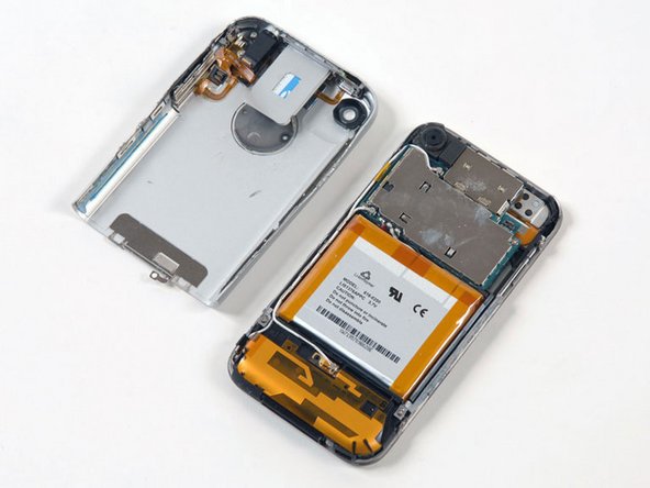

  8. iPhone 1st Generation Teardown: step 8, image 1 of 1
    • Separating the front and back case.
    • There's a headphone jack cable to disconnect before you can completely remove the back panel.
    • The headphone jack is recessed into the case, so most headphone jacks won't fit without an adapter (even if they're the right 1/8" plug).
    • Apple did this to reduce the strain on the narrow metal jack when you yank on the headphones. With this design, the hard plastic cable jacket absorbs most of the impact.
    • The headphones have a microphone built in, with a button that you pinch to answer a phone call.
  9. iPhone 1st Generation Teardown: step 9, image 1 of 1
    • At last! The moment you've all been waiting for.
    • The battery is huge, and soldered to the logic board.
    • You can see the SIM card bracket and headphone jack on the rear panel.

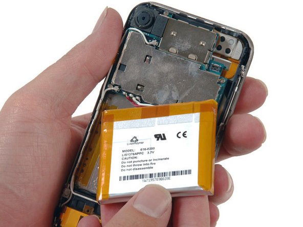

  10. iPhone 1st Generation Teardown: step 10, image 1 of 1
    • It is a 3.7 volt Li-Ion Polymer battery.
    • You can see at least two antenna cables connecting to the logic board.

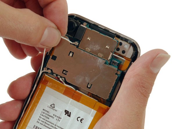

  11. iPhone 1st Generation Teardown: step 11, image 1 of 1
    • Disconnecting the two antenna cables.
    • There's a dab of glue underneath both of the antenna connectors, presumably for reliability.
    • One has to imagine that Apple was extra-paranoid about reliability on this phone. They've certainly learned their lessons from the iPod.

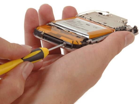

  12. iPhone 1st Generation Teardown: step 12, image 1 of 1

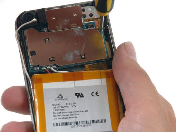

    • Removing three Phillips #00 screws securing the logic board to the front panel. The screws are:
    • Where the screwdriver is.
    • Underneath the black camera in the upper right hand corner.
    • To the left of the battery wires that are soldered to the logic board.

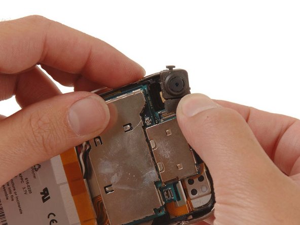

  13. iPhone 1st Generation Teardown: step 13, image 1 of 1
    • Removing the camera on the top of the phone.
    • Sadly, there aren't any software settings—it's just point and click.

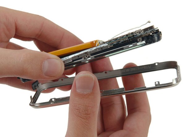

    • Removing ten Phillips #00 screws around the perimeter of the iPhone.
  15. iPhone 1st Generation Teardown: step 15, image 1 of 1
    • The battery has Apple model number 616-0290 L1S1376APPC.

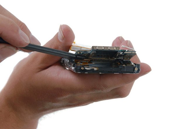

    • Lifting up the logic board. There are three connectors underneath. They are speaker, touch sensor, and display cables.
    • Disconnect the two connectors on the left side of the image.

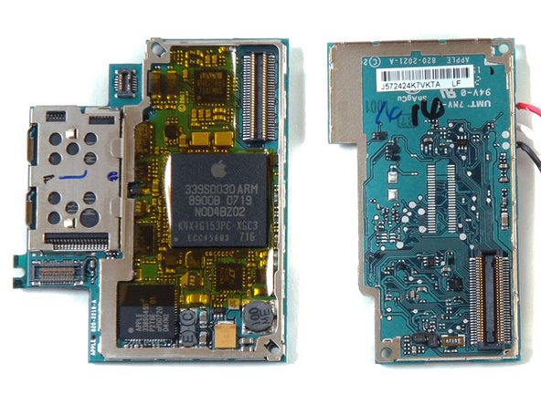

    • After further examination, we found a way to open the logic board without completely destroying it.
    • Samsung chip underneath the metal shield on the left side of the board on the left. Ours reads K9MCGD8U5M. The 4 GB model that Think Secret took apart had K9HBG08U1M on it, which is a 4 GB chip
    • Samsung memory stacked with a 620 MHz ARM architecture processor, ARM1176JZF. Could be a Samsung S3C6400. Numbers: 339S0030ARM, 8900B 0719, NOD4BZ02, K4X1G153PC-XGC3, ECC457Q3 716. The processor is likely stacked on the SDRAM, which could be two 512 Megabit chips. The processor could have H.264 and MP3 hardware decoding built in.
    • The chip above the ARM is a Wolfson audio chip. Part numbers WM8758BG and 73AFMN5.
    • The chip underneath the ARM is a Linear Technology 4066 USB Power Li-Ion Battery Charger, which Apple uses in the iPods as well.

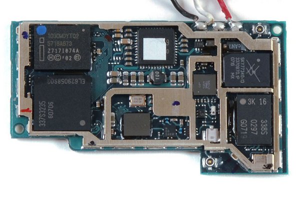

    • The chip on the bottom center that looks blank in our image actually has this text: MARVELL, W8686B13, 702AUUP. This is Marvell's 802.11b/g 18.4mm2 chip.
    • The chip in the upper right is a Skyworks GSM/Edge Power amplifier (SKY77340).
    • The silver chip to the left of the Skyworks chip reads CSR 41814 3A06U K715FB. This is a CSR BlueCore4-ROM WLCSP single chip radio and baseband IC for Bluetooth 2+EDR.
    • The chip covered by the white sticker in the photo has the part numbers 338S0289 and 8G60710 on it. EETimes claims this is an Infineon M1817A11.
    • The chip with the blue dot on it is rumored to be an Intel Wireless Flash stacked 32 Mb NOR + 16 Mb SRAM chip. Part numbers 1030W0YTQ2, 5716A673, and Z717074A. EE Times adds the part #PF38F1030W0YTQ2.
    • The chip in the lower right reads 338S 0297 G0719. Some claim this is an Apple-branded chip, but it's purpose is currently unknown.
    • The chip in the lower left is an Infineon PMB8876 S-Gold 2 multimedia engine. Part numbers: 337S3235, 60708, and EL629058S03.
