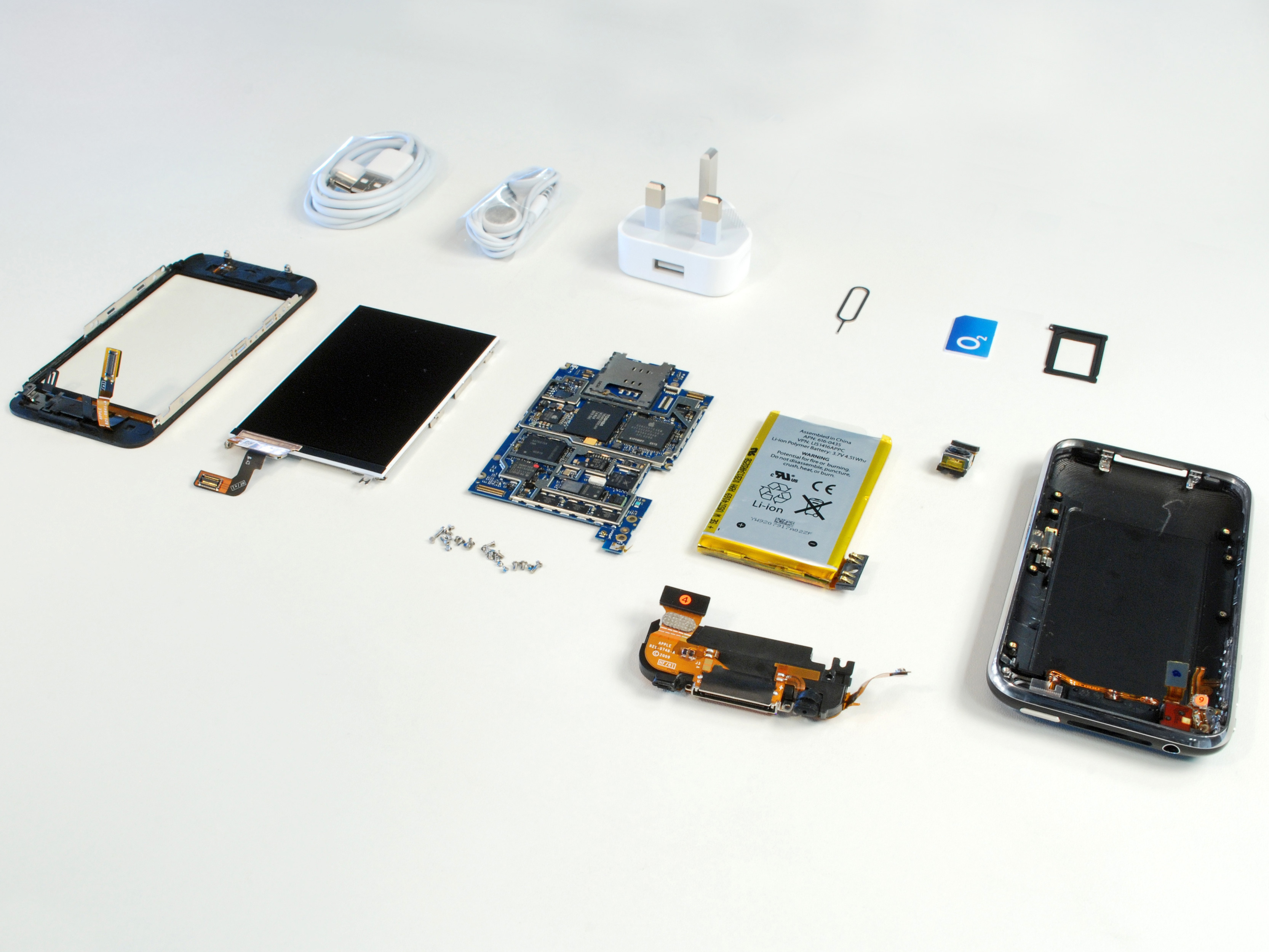

  16. iPhone 3GS Teardown: step 16, image 1 of 1
    • Here's all the parts. We'll continue to perform further analysis, so check back for updates, or follow @ifixit on Twitter.
  17. Final Thoughts
    • LCD and front glass are not fused and can be replaced individually.
    • Standard Phillips screws used throughout.
    • Battery is buried under the logic board, making it difficult to replace.
