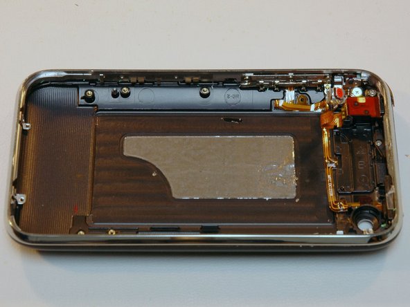

Behold, the iPhone! Can you see the 3G bits inside?
The two boards (logic and communications) are now one. Rather than stacking them, as in the last model, they laid it out along the entire length. We're guessing this allowed them to make the battery longer.

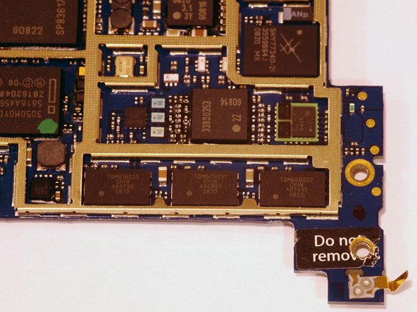

The largest chip in the top left corner is an Infineon 337S3394 WEDGE baseband marked SP836175 G0822.
Small chip to the right of the NOR: Infineon BGA736 (Tri-Band HSDPA LNA). Just beneath that is an Infineon UMTS Transceiver marked 338S03532Z 60814.
Skyworks power amplifier SKY77340 (Power Amplifier Module Quad) on the top right: Octopart datasheet
The chip in the top middle is SMP 3i 6820, Infineon SM-Power3i. From Infineon: the part is "optimized to support modem and data card applications based upon X-GOLD208 and X-GOLD 608, with features ranging from EDGE up to 3G and HSDPA."

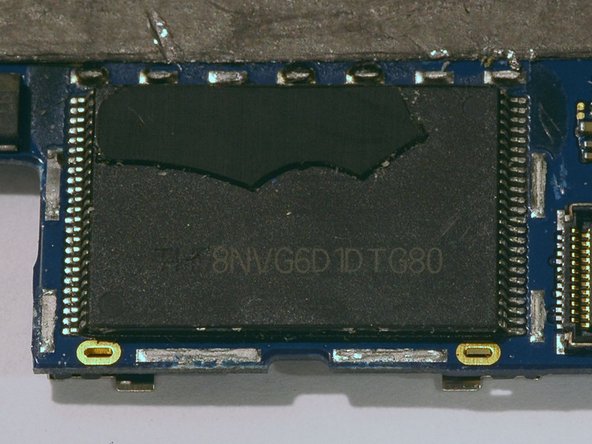

Processor markers: 339S0036 ARM EMC567DB 819 8900B N182F0A3 0825 7511.101 ZPD8163Y, 5974V CKUFBG HE0819 870628 P12 N3. Samsung DDR on the chip (K4X1G163PC-DGC3) is slightly different from the first iPhone, which was K4X1G153PC.
SST SST25VF040B 1MB SPI Serial Flash to the left of the SIM card, along with a National Semiconductor LM2512AA Display Interface.

The three chips along the bottom are TriQuint Tritium PA-duplexers: TQM616035 TQM676031 TQM666032. Presumably each one works on a different frequency band: "Each highly-integrated module contains a Tx input filter, a linear Power Amplifier, Duplexer, and Coupler."

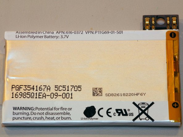

The battery. Put your soldering irons away, they won't be needed! Apple part #616-0372.
The recycle marker on the battery is blacked out with a sharpie. Suspicious...
We were all expecting a bigger battery, and I can't verify this, but this page references the part number on the battery and lists a capacity of 1150 mAh, not the 1400 mAh in the original. Can anyone dig up more information?
