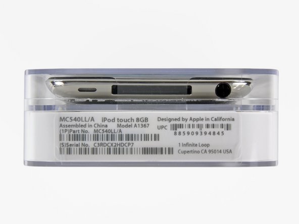

    • The new Touch has a visible speaker grill on the bottom (to the left of the dock connector). On previous iPod Touches, the external audio simply came out the dock connector. Apple likely beefed up the speakerphone to enable FaceTime on the Touch.
    • The new Touch has once again been slimmed-down. Similar to the iPhone 4, the back of the Touch is now flat. Unlike the iPhone 4, the iPod Touch still features the same shiny stainless steel back that has graced every iPod Touch.
    • We paid $229 for our 8 GB Touch, which seems like a pretty good deal. A 32 GB Touch will set you back $299, and a 64 GB can be had for $399.

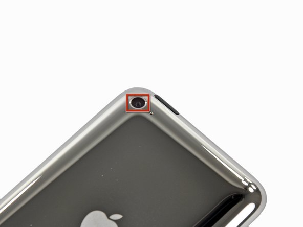

    • Cameras!
    • That's right folks, at long last the iPod Touch has not one, but two cameras.
    • The front-facing camera is just like that of the iPhone 4, with support for VGA quality photos and video.
    • Unfortunately, the rear-facing camera is only 960x720 resolution. That's only about .7 megapixels, compared to 5 megapixels on the iPhone 4. It's likely that Apple had to sacrifice still photo resolution in order to squeeze the camera into the Touch's slim package.
    • There's a microphone hole next to the rear camera. Apple's updated the audio input and output prowess of the new Touch to enable it to play nice with FaceTime.

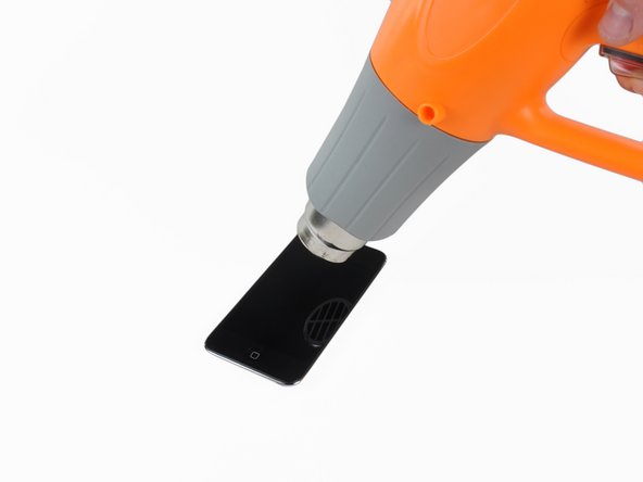

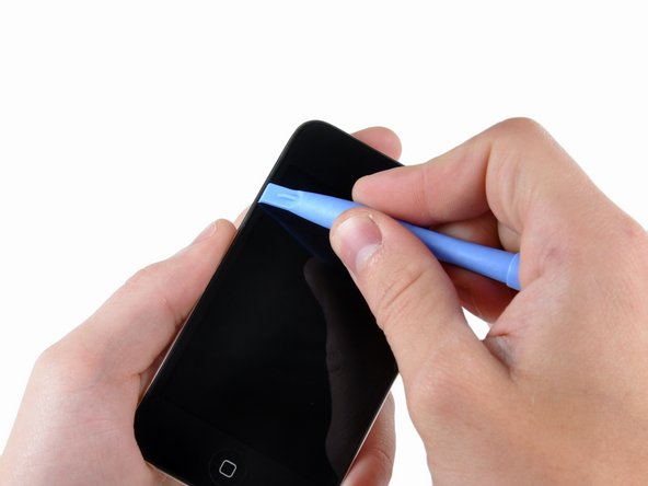

    • Enough of the exterior, let's get inside...
    • There are no visible screws. We'll have to figure out what combination of glue, tabs, and magic Apple used to hold the Touch together.
    • We first used a heat gun to soften the adhesive holding the display assembly in place.
    • Next, we ran a iPod Touch opening tool around the edge to separate the adhesive.

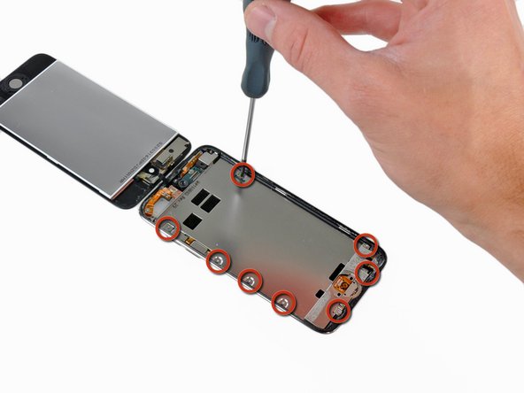

  6. iPod Touch 4th Generation Teardown: step 6, image 1 of 2 iPod Touch 4th Generation Teardown: step 6, image 2 of 2
    • That was the easiest iPod Touch we've ever cracked open. Hopefully the insides will continue to be repair-friendly.
    • Dear iFixit: this is Future iFixit and we can confirm that the insides are not repair-friendly.

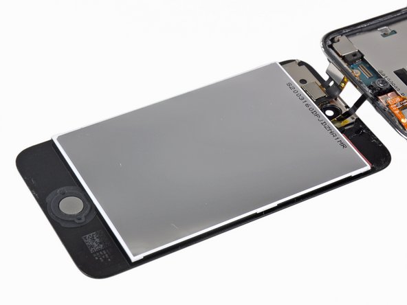

    • The display assembly is still attached to the iPod, and disconnecting it doesn't look like it's going to be easy.
  7. iPod Touch 4th Generation Teardown: step 7, image 1 of 1
    • Like the iPhone 4, it appears that the front glass and LCD panel are permanently fused together. The good news is that this will prevent dust from getting beneath the glass, but unfortunately it will make repair more expensive.
    • There are two cables securing the display assembly to the logic board. One is easy to disconnect, but the other is more challenging. The thin black cable connects beneath the logic board. That means that replacing the display assembly will definitely not be trivial.
    • If you have a 1st, 2nd, or 3rd generation Touch, it is possible to replace just the front glass without replacing the LCD.

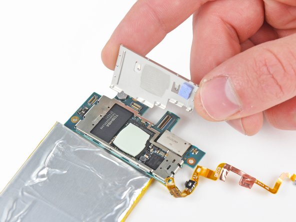

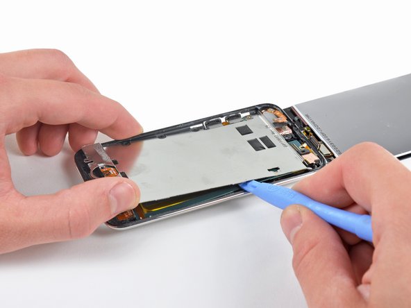

    • There's an EMI shield between us and the iPod. Fortunately, it's just held in place with a few Phillips #00 screws.
    • The EMI shield is surprisingly heavy, weighing in at 11 grams. The entire iPod Touch is only 101 grams, meaning Apple has devoted more than 10% of the iPod's weight to this metal EMI shield.
  9. iPod Touch 4th Generation Teardown: step 9, image 1 of 1
    • After removing the EMI shield, the battery looms large.
    • Apple claims you'll get (up to) 40 hours of audio playback. That's a long time!
    • Apple's making us do some digging to find the chips. This side of the logic board is quite barren.
    • Contrary to Apple's initial claims on their FaceTime marketing page, the iPod Touch does not have a vibrator. Apple's website has been updated to remove this claim.
    • Be careful when removing the EMI shield. There is an adhesive strip near the top of the device that may catch the ribbon cable and cause it to rip.

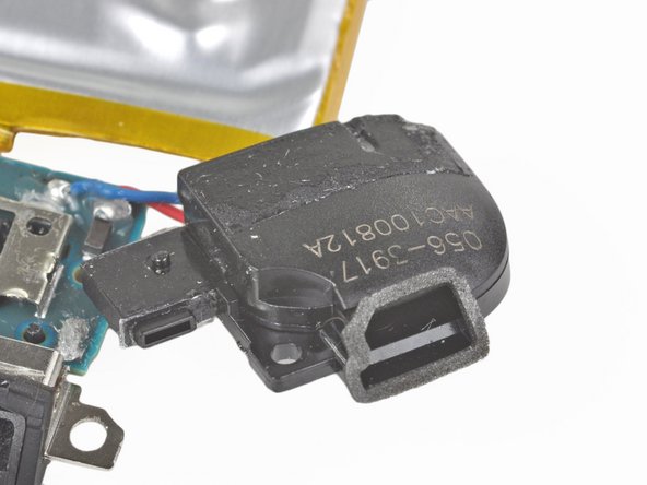

    • In a first for the iPod Touch line, the headphone jack is not soldered to the logic board.
    • One screw, one connector, and the headphone jack lifts out.
    • Having the headphone jack on a separate board is definitely a plus for repairability.
  12. iPod Touch 4th Generation Teardown: step 12, image 1 of 1
    • Here's the headphone jack all by itself. Notice the liquid damage indicator on the bottom of the part.
    • The headphone jack is stamped with Foxconn. Foxconn has long been one of Apple's primary contract manufacturers and this part has one of the few indications that Apple doesn't actually manufacture the iPod.

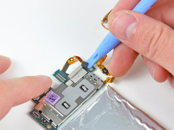

    • After wrangling the logic board/battery/display assembly out of the rear panel, we can finally access the screws holding the volume button cover and the sleep button down.
    • After a good bit of anxiety-filled scraping with a metal spudger, the ribbon cable is finally free from the rear panel.
    • The control ribbon cable is bonded to the rear panel extremely well, especially near the volume buttons. Since the volume buttons have no structural bracket (just a steel cover) holding them to the rear panel, the adhesive bond must be strong enough to survive presses from the strongest of button pushers.

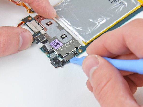

    • At this point, the rear facing camera can be disconnected from the logic board.
    • Unlike the iPhone 4, the fourth generation Touch's rear-facing camera does not support autofocus and is a much lower resolution.
    • For those of you who are wondering, there's no way the iPhone 4's rear camera can be installed in the Touch without some extreme hackery.
    • This camera is 6.5 mm square by 3.3 mm tall. That is dramatically smaller than the iPhone 4's rear camera.
    • Just above the rear camera, the cylindrical silver object is the microphone, a new feature for the iPod Touch line.

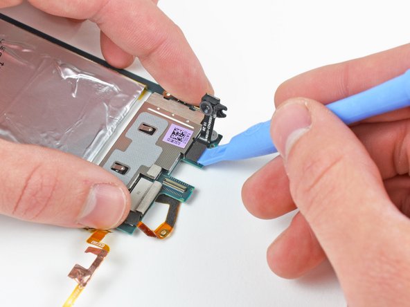

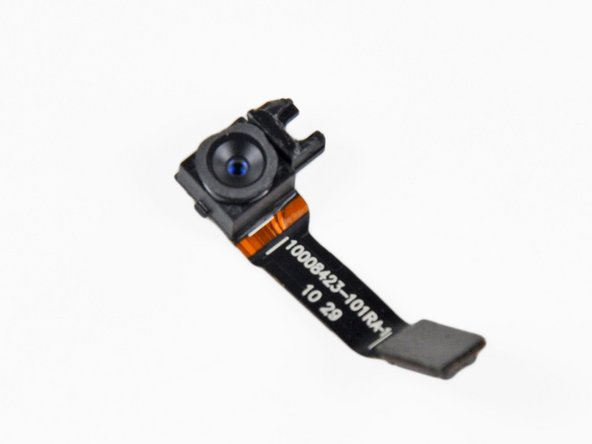

    • The front-facing camera is readily accessible and can be disconnected from the logic board at this point.
    • Unsurprisingly, it looks just like the iPhone 4's front-facing camera.
    • We're not surprised: they have the same resolution.
    • This camera is 4.9 mm square and 2.5 mm thick, slightly (0.3 mm) thinner than the iPhone 4's front facing camera.

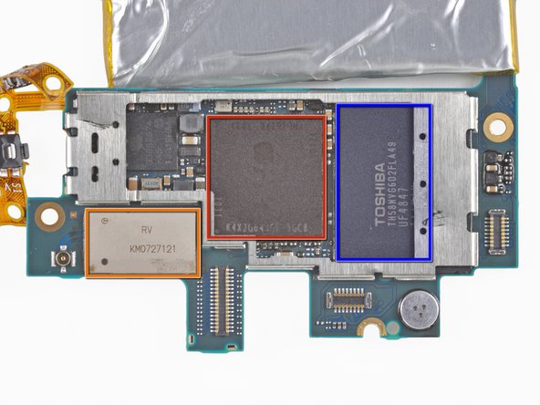

    • Finally! We found some serious chips.
    • This iPod features the same A4 processor that's found in the iPad and iPhone 4. The Toshiba chip is very similar to the one which was present in the iPad in the FCC teardown, that was replaced by a Samsung one.
    • The key marking of interest on the A4 processor package is K4X2G643GE. This is identical to the marking found on the iPad processor, but different from the iPhone 4 processor. The iPad has 256 MB RAM, while the iPhone 4 features 512 MB. Unfortunately, this means that like the iPad, the new iPod Touch includes only 256 MB of RAM.
    • The NAND flash memory is now provided by Toshiba, not Samsung like that of the iPad.
    • Murata KM0727121 Wi-Fi module
    • And no, there's no RAM upgrade slot.

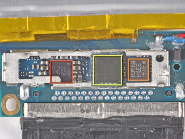

    • There are a few more chips at the other end of the logic board.
    • On the far left is a 338S0859 chip. It's similar to the Cirrus Logic audio codec of the iPhone 4 (338S0589).
    • The new AGD8 2032 gyroscope is very similar to that one of the iPhone 4.
    • The 2032 33DH chip is found next to the gyroscope. It seems this chip was packaged in the same die with the gyroscope in the iPhone 4. This is the accelerometer.
    • You can clearly see the 30 pins of the dock connector, located just below the row of chips.

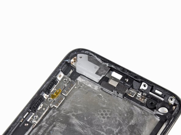

    • What's this? Empty space?
    • We don't know what this white plastic piece does other than take up space. Perhaps it's a weight-saving device.
    • From a user: "it is used to keep the Wi-Fi antenna above the lower metal housing to achieve proper RF gain." Neat!
