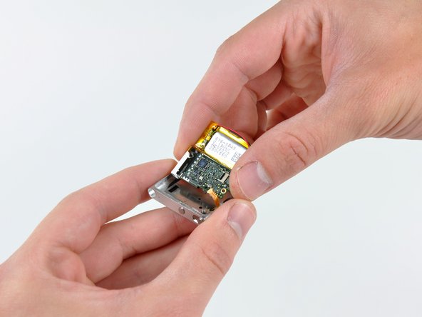

  5. iPod Shuffle 4th Generation Teardown: step 5, image 1 of 1
    • The exposed internals.
    • The logic board is stuffed alongside the battery in the outer case.
    • Notice the glue residue along the edges of the opening.
    • Apple press-fit and glued the back clip onto the body. No wonder it was such a doozy to open!
