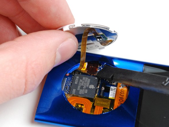

    • Apple has redesigned the click wheel on this nano. Instead of being (fairly permanently) affixed to the case, we were able to rotate and lift the click wheel.
    • You can use a spudger to completely remove the click wheel without taking the rest of the iPod apart.

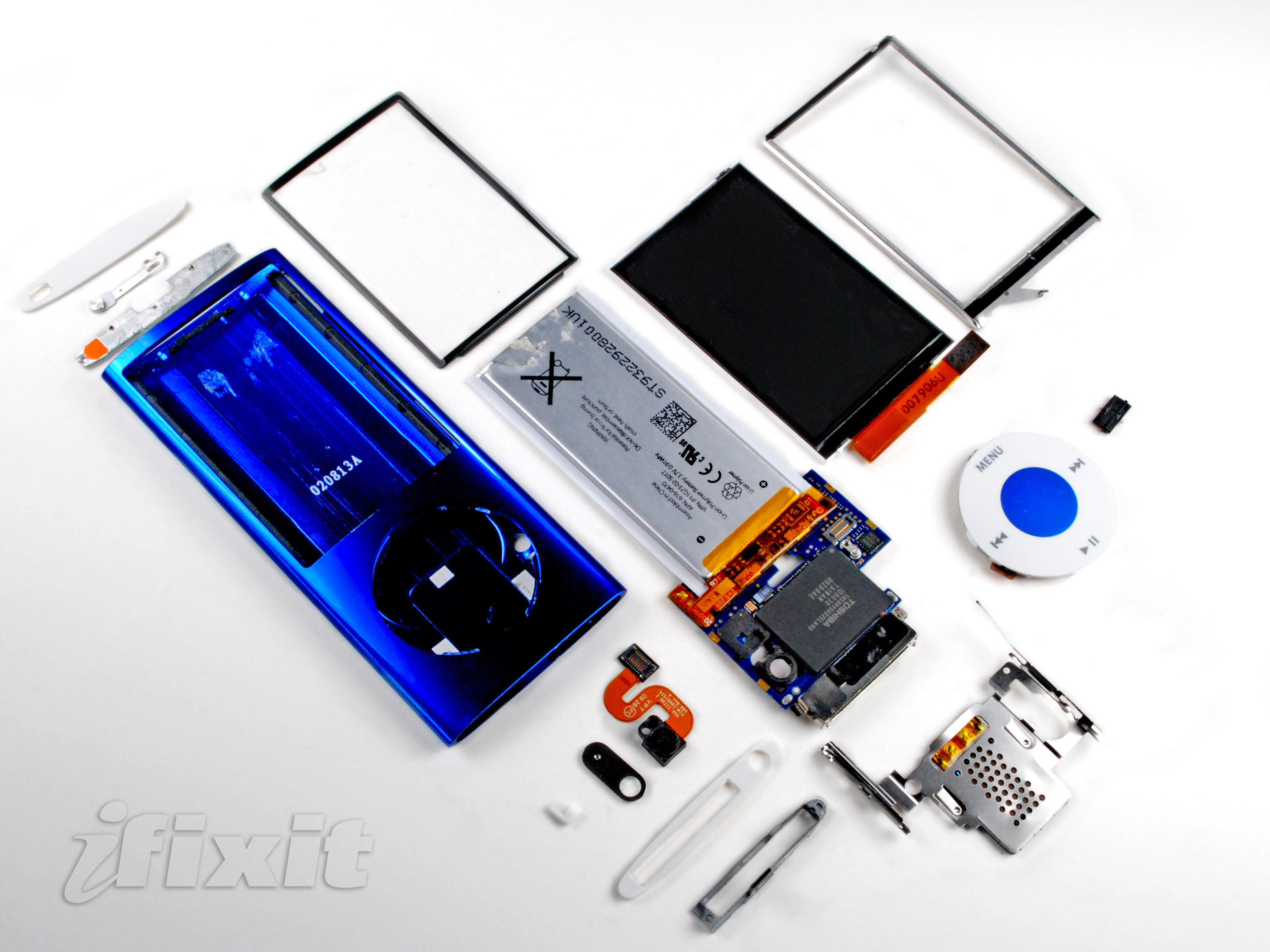

  11. iPod Nano 5th Generation Teardown: step 11, image 1 of 1
    • iPod, sans casing.
    • The tolerances on this iPod are incredibly tight, there's no wasted space inside.

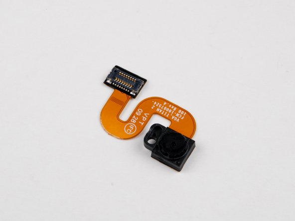

  17. iPod Nano 5th Generation Teardown: step 17, image 1 of 1
    • The camera, in all its VGA resolution glory. The camera itself is less than 3 mm thick.
    • Space may have been a factor in not including a better camera. Excluding its mount, the camera in the iPhone 3G is about 6 mm thick. The 5th Gen nano is 6.2 mm thick at its thickest point.
    • Unlike the nano, the touch, at 8.5 mm thick, could conceivably support an iPhone-sized camera, although it would certainly be an engineering challenge.

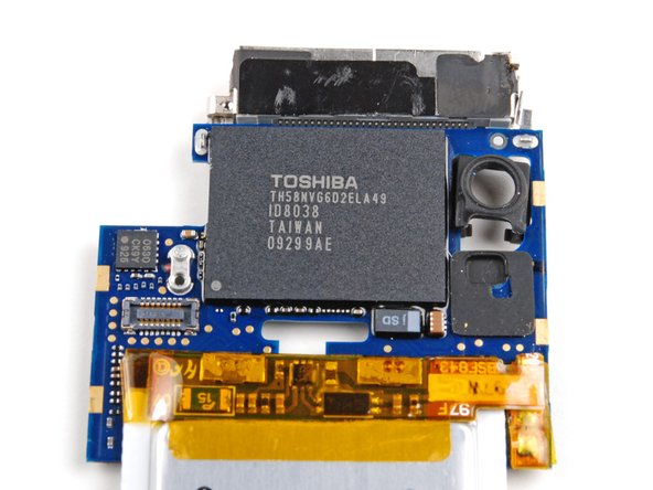

    • In our iPod, Toshiba is the source for the 8 GB of flash memory. On the chip:
    • TH58NVG6D2ELA49
    • ID8038
    • TAIWAN
    • 09299AE
    • It looks like this was made in Taiwan in week 29 of 2009 (mid-July).
    • Also visible to the right of the Toshiba chip is the rubber mounting fixture for the camera, assumedly to dampen vibrations.

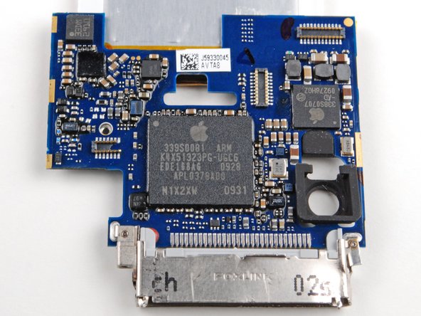

    • The front of the logic board.
    • The main ARM processor dwarfs everything else on the board. Similar to previous iPods, we expect this is an Apple-branded Samsung processor.
    • Here's the markings from the processor:
    • 339S0081 ARM
    • K4X51323PG-UGC6
    • EDE168AG 0928
    • APL0378A00
    • N1X2XW 0931

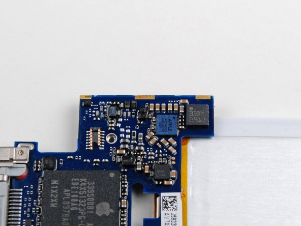

  20. iPod Nano 5th Generation Teardown: step 20, image 1 of 1
    • The shiny chip is visible from this angle:
    • 338S0559
    • ATWV0926
    • SGP
  21. iPod Nano 5th Generation Teardown: step 21, image 1 of 1
