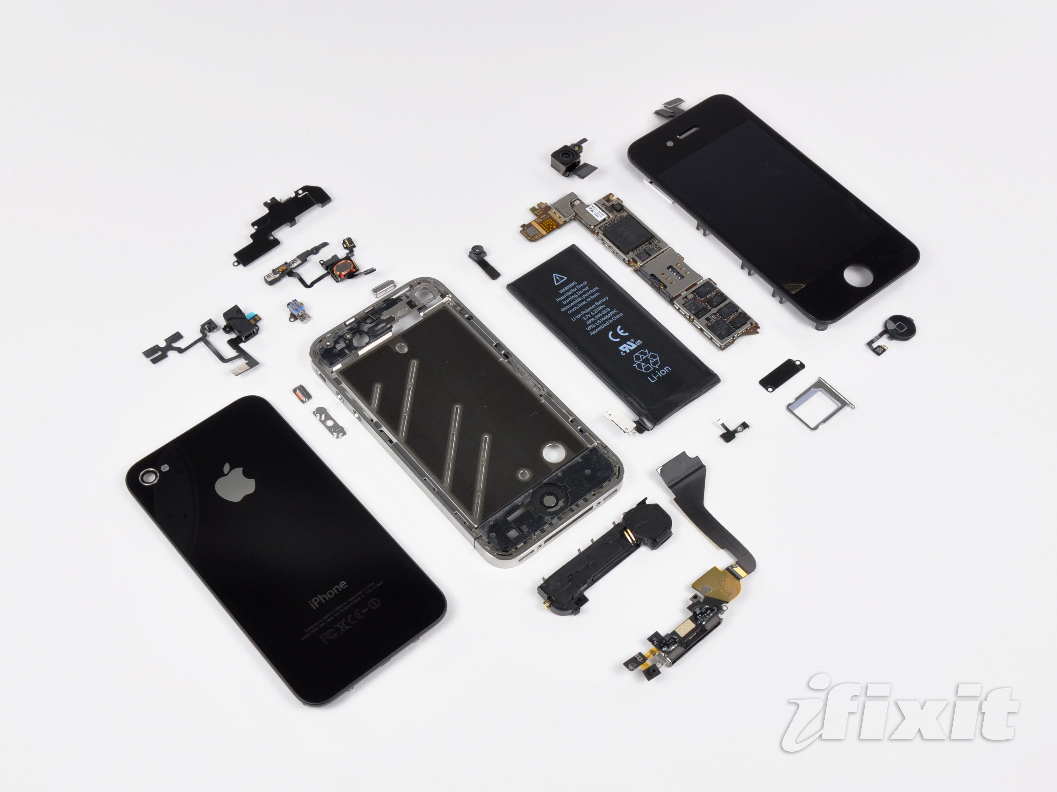

    • As always, we provide each device with a fitting final layout shot that it so greatly deserves.
    • We would like to thank you for joining us tonight during this monumental endeavor.
    • We also created a set of iPhone 4 repair guides for all major components inside the device. They will definitely help you fix your iPhone 4 should something happen to it!

    • iPhone 4 Repairability Score: 6 out of 10 (10 is easiest to repair)
    • The iPhone 4 is held together primarily with [lots of] screws, sans tabs, and limited adhesive.
    • The rear panel and battery are both easy to remove and replace (provided you have the right kit and/or correct screwdriver).
    • Apple is using Pentalobe screws to secure the rear panel and keep people out.
    • The LCD and glass are fused together, making repairing a cracked front panel more costly.
    • During disassembly, your finger oils interfere with the iPhone 4's RF grounding contact points, so we recommend you wear gloves while performing any repairs.
